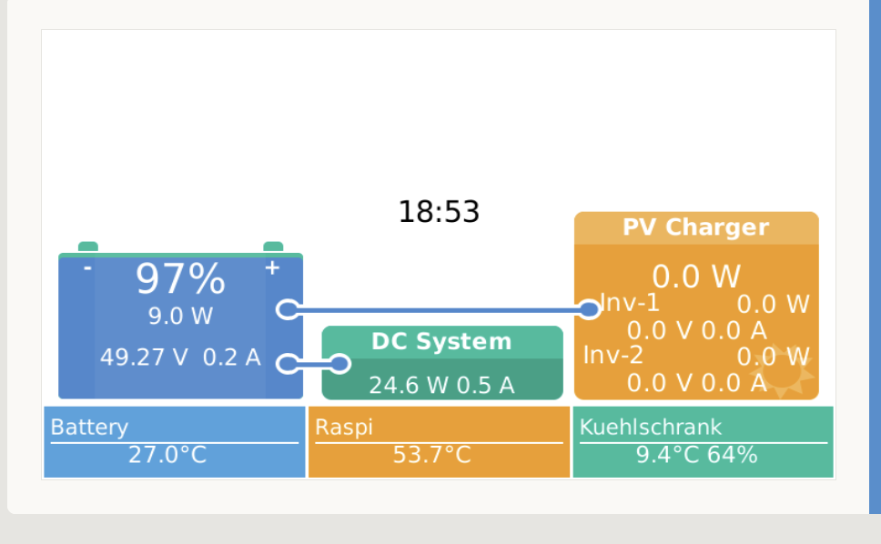

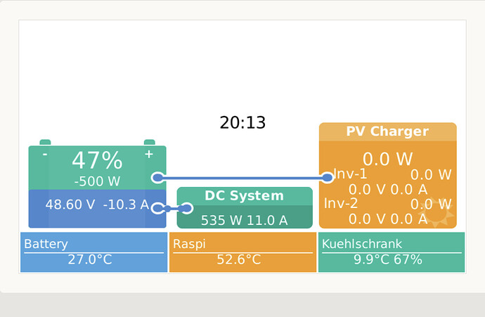

At the screenshots you can see, the 0 load point is not correct, it is around 34W too little. (DC System is a Victron Smart shunt in series). in 24 hours with loading and unload there is a difference of about 800W.
If I disconnect any load, I have 0 W on both shunts, but with a little load, the BMS Shunt shows current feeding in to the battery (not possible, bcs. I measure at night)
