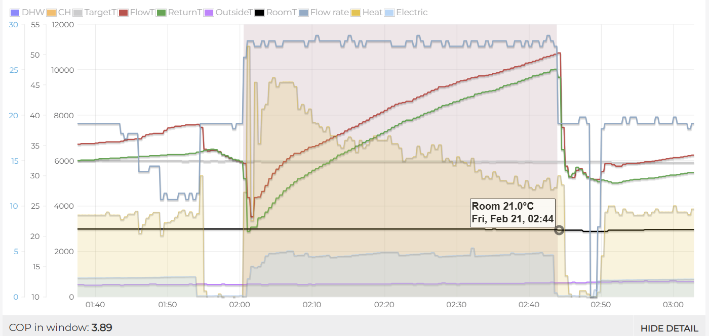

Since having our Daikin heat pump installed we regularly get woken up in the middle of the night by the central heating pipes creaking.
Its happening at the end of the DHW cycle (45C) and this morning I checked my watch and it was 02:44.
Currently the hot water cycle start is set to 02:00 as
  1. Its in our IOG cheap rate
  2. I often have to get up at silly oclock to catch a flight and its nice to wake up with a hot shower
  3. Usually by this time my home batteries have fully charged and there is less demand from my house on the grid.
Now I could move the DHW cycle out of sleep time, for example at lunch time but then I am likely using precious home battery energy and in the depths of winter I dont have enough battery to get the heat pump through the day so added a kW/h or two will only make that worse.
Maybe I could split the DHW into 2 cycles, one at 23:20 at the start of my cheap rate and then another at 05:30.
Could anybody confirm why my central heating pipes are creaking after the DHW?
Suggest any strategies to mitigate it with heat pump settings?
Or is it a physical job for a plumber?

we get a brief pipe creaking noise briefly as the hw cycle finishes and the valve turns over to central heating ( hotter water suddenly going in to cold pipes

The creaking is definitely immediately after the valve turns to DHW to CH. Like I say its loud enough to awaken anybody sleeping.
