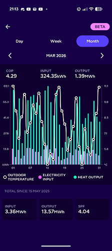

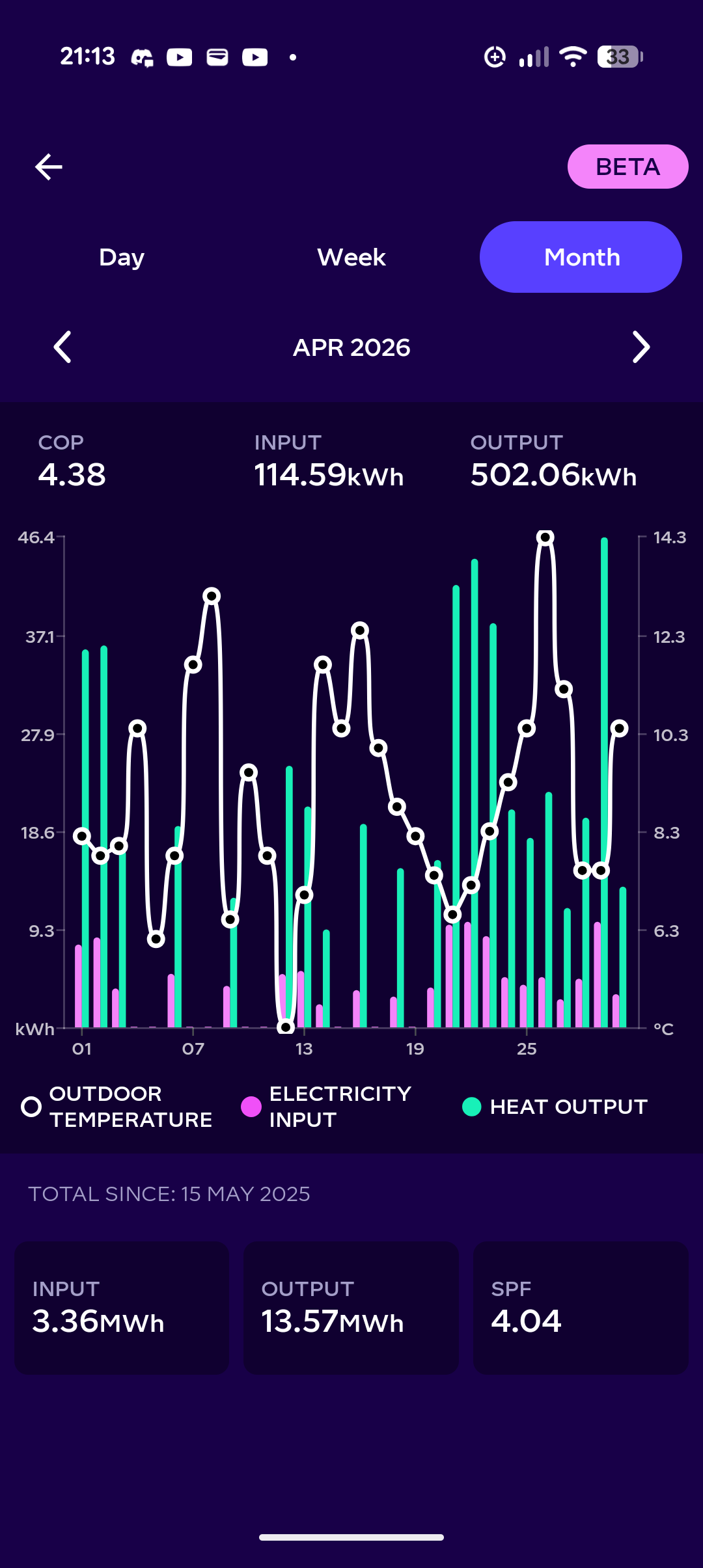

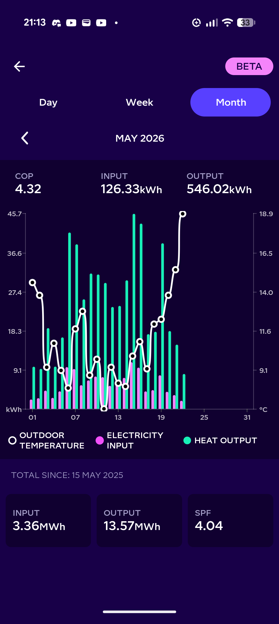

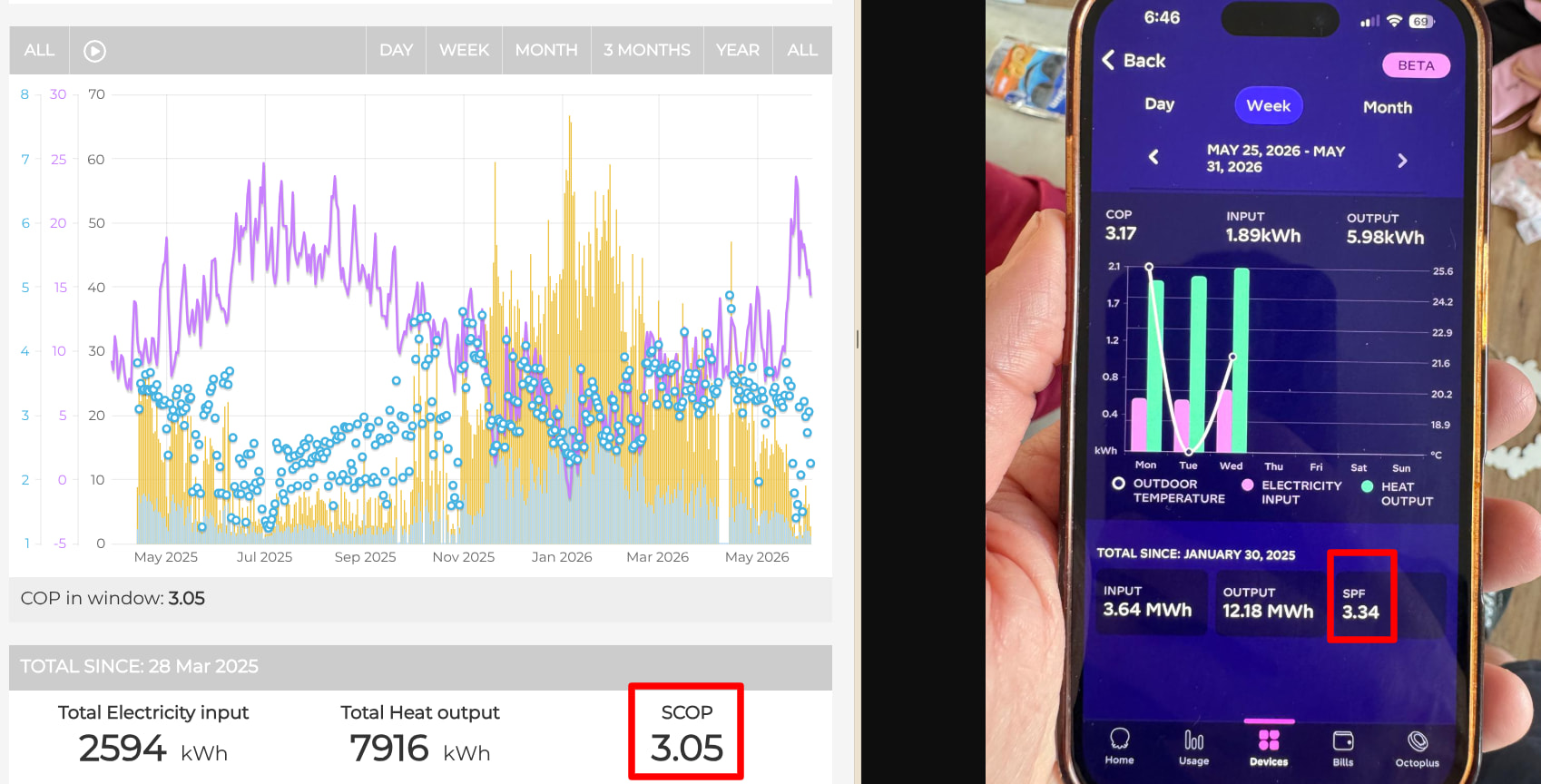

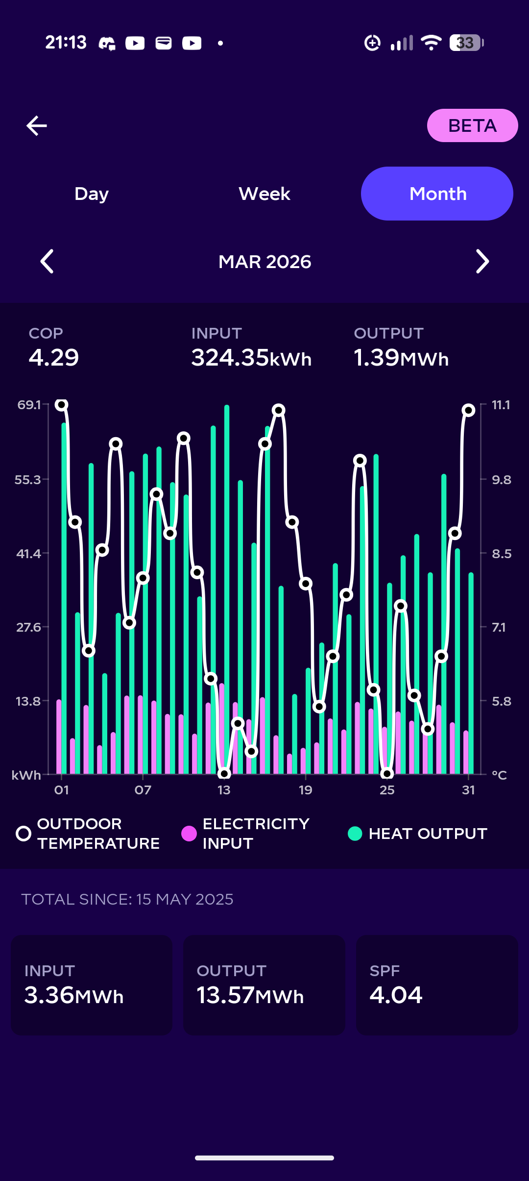

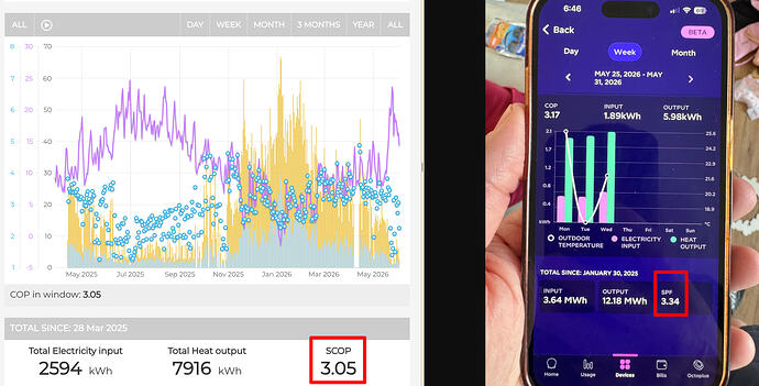

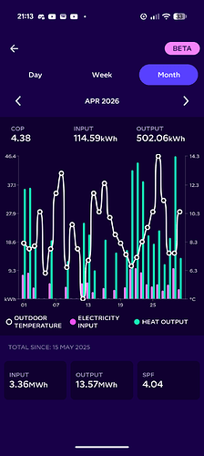

Our MID monitoring for this unit started in March 25, the unit was installed in Jan 25, so we would expect our monitoring to show a higher SCOP since it missed out a lot of cold weather running in Jan/Feb. However, the Octopus scop is over-reporting by at least 9.5%
