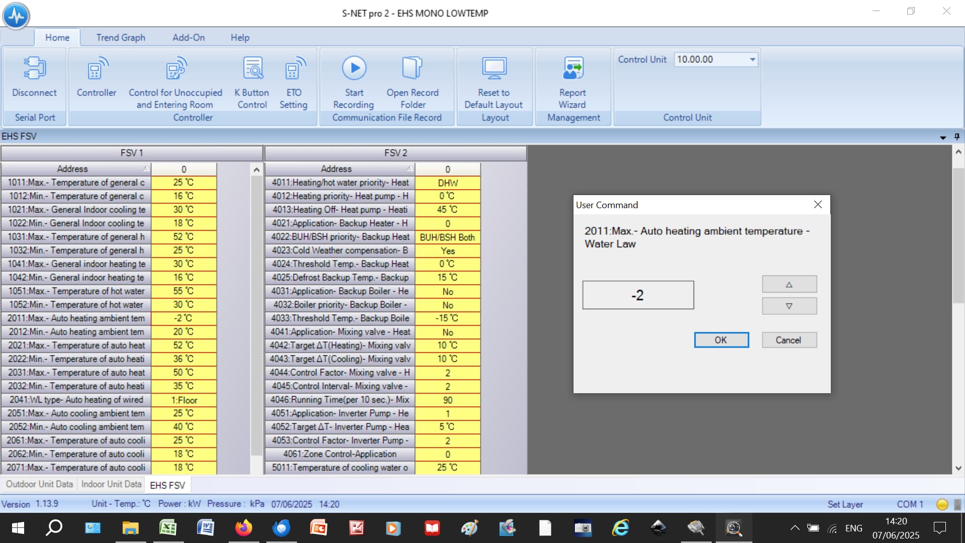

OK here you go - I’ll try to do a live reset of #2011.
Here’s the “before” status:
Now starting the Monitor, followed as fast as I can with adjusting the FSV to 0degC, after which I’ll grab the Monitor output.

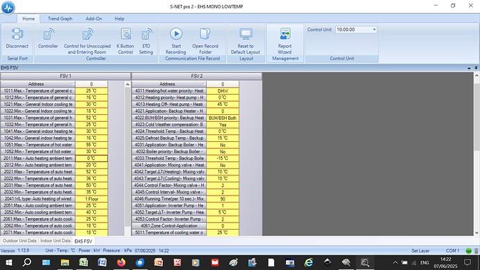

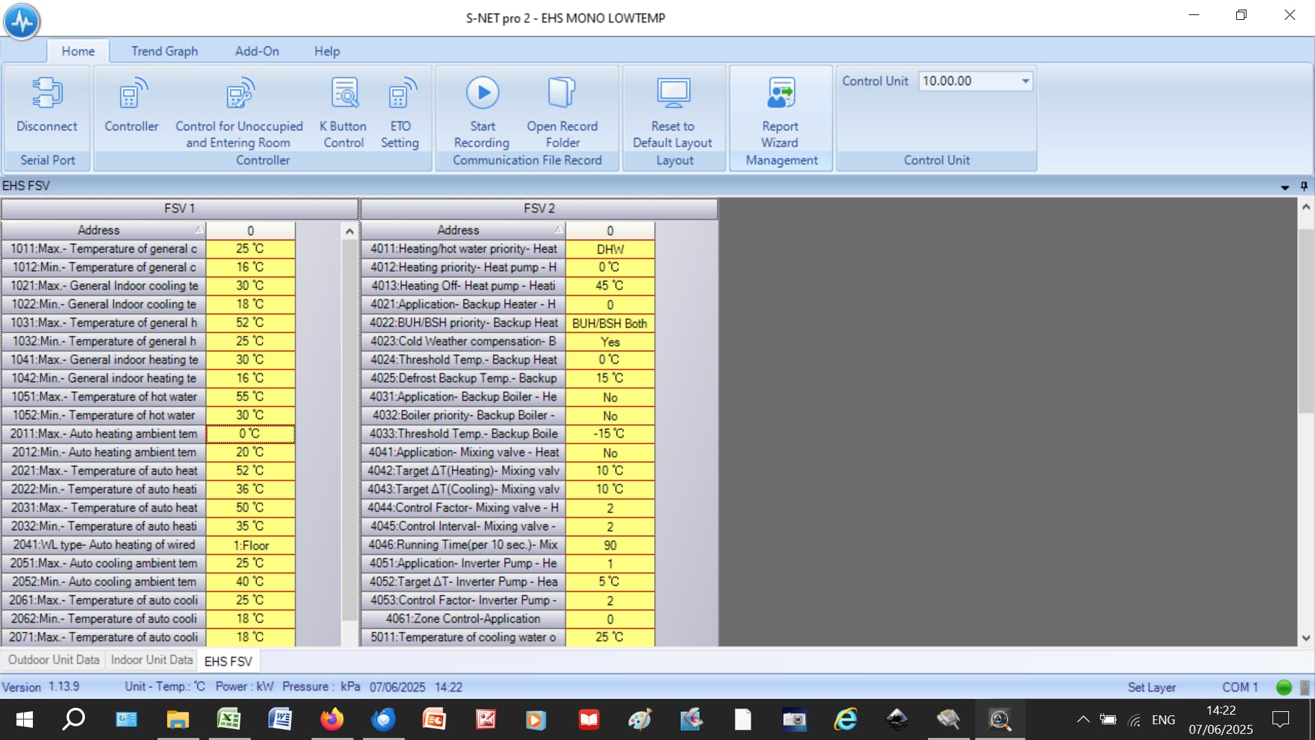

“After”:
Here’s the resulting Monitor output:
nasa2.txt (8.0 KB)
Over to you to see if you can spot any outgoing message…
Hmm message #31 looks different (“COM” instead of “NET”, followed by loads of 0x55 followed by 32 00 12 80 FF 00 20 00 00 C0 12 EC 01 42 54 00 00 9F 43 34.)
I wonder if that’s the all-important message…

32 - STX (Start of Text)
00 12 - Packet Size = 18 bytes
80 - Source Address Class = JIGtester
FF - Source Channel
00 - Source Address
20 - Dest Address Class = Indoor Unit
00 - Dest Channel
00 - Dest Address
C0 - Packet Information = 1, Protocol Version = 2, Retry Count = 0
12 - Packet Type = Normal, Data Type = Write
EC - Packet Number
01 - Number of Messages = 1
42 54 - Message Number + Message Type = Variable = 2 bytes long
00 00 - Variable value = 0degC
9F 43 - CRC
34 - ETX (End of Text)
So definitely looks like the smoking gun.
