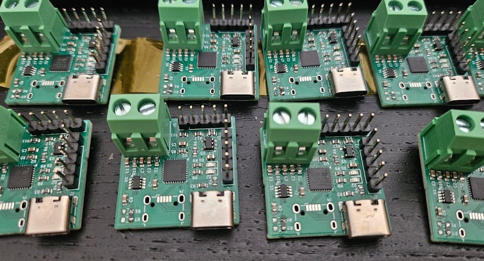

:slightly_smiling_face: If you do, I can recommend a couple…
Great news, I’m interested on buying one.
I’m eager to connect my AC to my HomeAssistant.
And they’re here !
All flashed and tested
Cheers

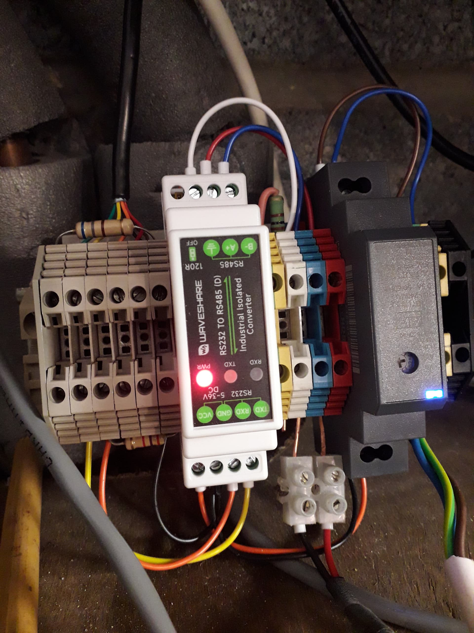

I started early during the stupidly hot days we seem to be having …
System Details
  • Connected to F1/F2 - Outdoor Unit AE120RXYDEG/EU, Indoor Unit MIM-E03CN, Modbus Interface MIM-B19N, RS232->RS485 Converter, Waveshare RS232toRS485(D)
  • Connected to F3/F4 - Indoor Unit MIM-E03CN, Wired Remote Controller MWR-WW10N
USB<->RS485
I chose to go via RS232 as this allows me to attach a 'scope to the RxD/TxD lines to examine timing if needed whilst being galvanically isolated from the RS485 lines. I can’t stress enough about the importance of galvanic isolation when connecting to electrical circuitry that you do not have complete details of, thus avoiding operational weirdness and/or device destruction and/or electrocution. Direct (isolated) USB<->RS485 would be fine for normal operation.
  • The two resistors are attached from the RTS and TxD line to 0V to deal with some weirdness of the USB<->RS232 converter. Although these are outputs from the converter, they go tri-state when not actively sending a signal. They then pick up noise and produce strange effects. Pulling them to a know state fixes this. Value not critical, 1k should be fine.
  • There is a 100R resistor connecting the RS485 GND terminal to earth. Another pet hate of mine is floating network conductors (it is surprising the belt you can get from static build up from 1km of floating twisted pair strung through an oil refinery).
NASA logs and conclusions to follow …
