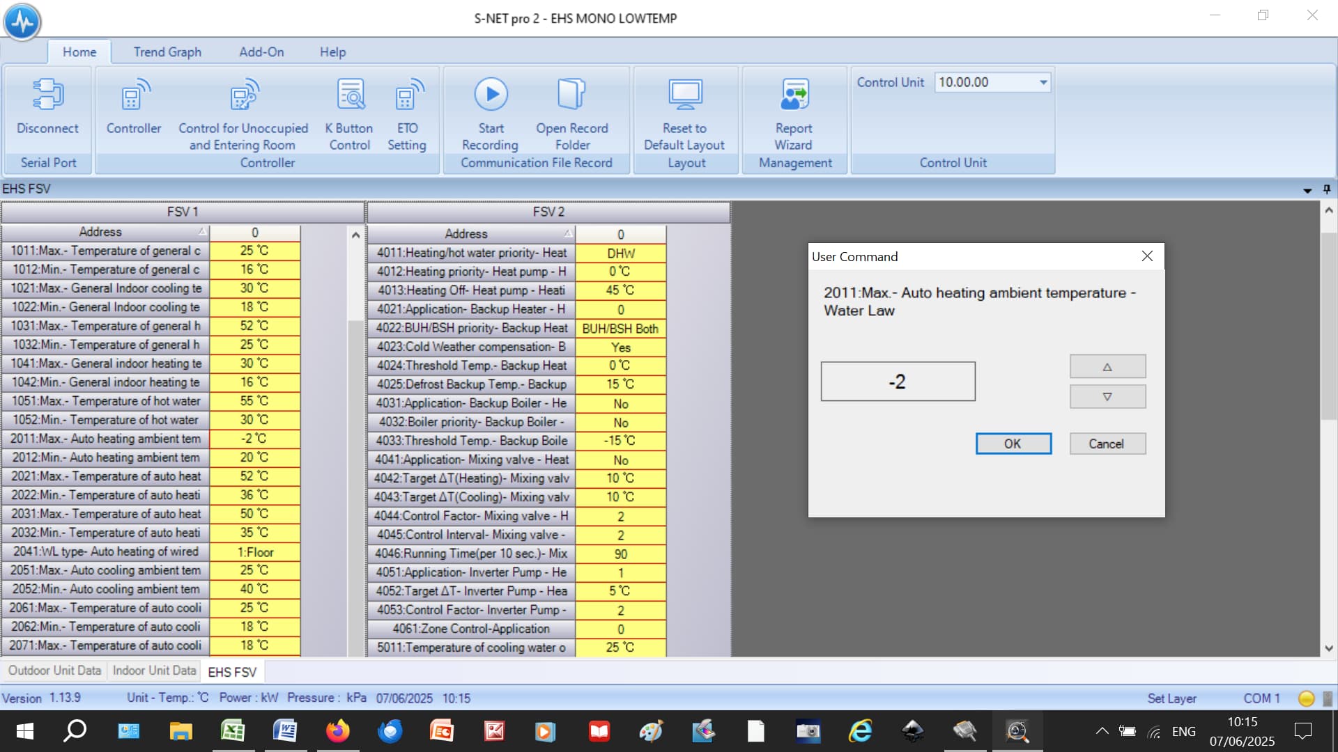

I hate to disagree with you @Topaz (your grasp of Samsung comms is way ahead of most folk), but the Samsung SNET-Pro2 software does just that - it allows me to manually update all my FSV values from my laptop via F1-F2. So if SNET can do it, I assume that anyone with sufficient knowledge of the Samsung NASA protocol could write a customised version that responds to some sort of optimisation routine.
Here’s a screenshot of my SNET:
You can see that, as well as an Outdoor Unit and Indoor Unit tab, there’s an “EHS FSV” tab. In the screenshot, I’ve elected to adjust #2011. (I just double-click on the FSV I want to change and get the sub-window you see on the right.)
My only hardware is an RS485-to-ethernet adapter connected to F1-F2, with the other end of the ethernet cable connected to my broadband router. I had to install a virtual comm port so that SNET recognises the incoming signal (easy using free-to-download software).

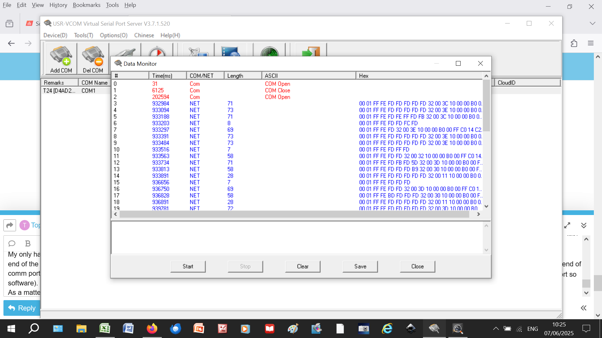

As a matter of interest, you can see the NASA messages using the VCOM software in-built monitor:
Presumably, any home-built interpreter software would have to adopt the same protocol for any Write operations.

I totally agree with you, but I couldn’t found a way to sniff that on the link, I’ve tested connecting SNET using a usb com to rs485, and it clearly didn’t work the way you show us. So I dropped that part and went the modulated F3/F4 way.
Can you try to modify the ambient current temperature (not the target) through F1/F2, this is my main problem, as I have replaced (disconnected) the wired controller and replaced them with my own sensors to multiply the point of sensing.
I could make good use of the traces you provided to implement that transport and make the MQTT. I’ll have a look at that!
