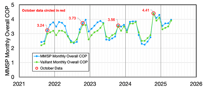

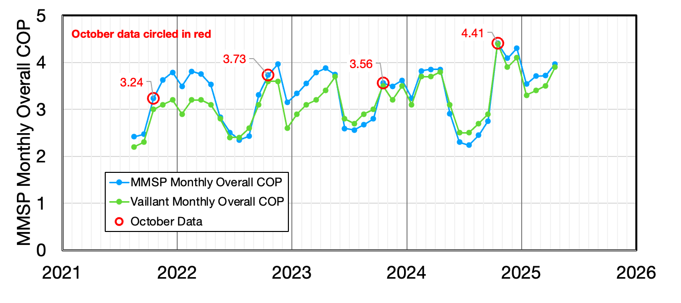

Jeffrey, As many people have said, the data self-reported by the heat pump is not reliable.
I have added a graph showing my comparison of MONTHY COP reported by my 5 kW Vaillant ASHP versus MONTHLY COP reported by my heat meter and monitoring system. Unfortunately it’s not linked to the Open Energy Monitor.
Back in 2022 the data was seriously in error, but in recent years it seems to be better. I really don’t know what has changed. That’s the problem!
Drop me a line if you would like more information: best wishes: Michael
