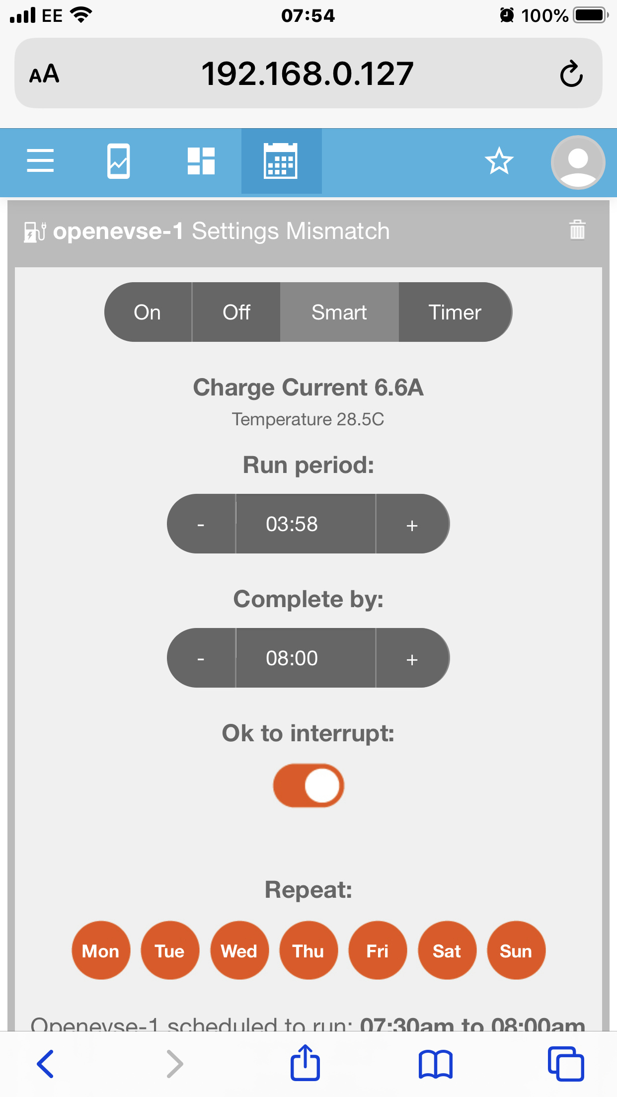

also i noted that the time control uploaded from demand shaper seems to have got it wrong as the start is 7:30 stop is 7:00
also in the demand shaper this morning it is showing settings mismatch and the time run period has changed now to 3:58

Interesting, thanks for reporting this. I think this is the issue why the demand shaper gets interrupted during the night. I’ll investigate this further.
