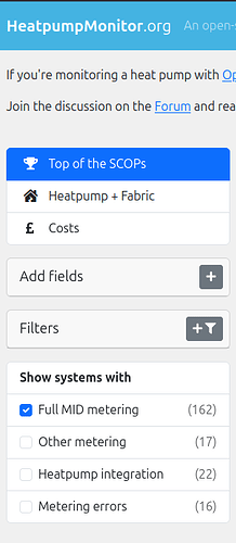

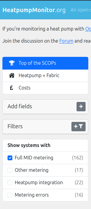

While we require MID approved class 1 electric metering and class 2 heat metering to list a system on the standard public leader-board on HeatpumpMonitor.org, there are plenty of people contributing data with other approaches e.g pulling data directly from a heat pumps own monitoring. You can explore these systems by enabling them on the site e.g:
