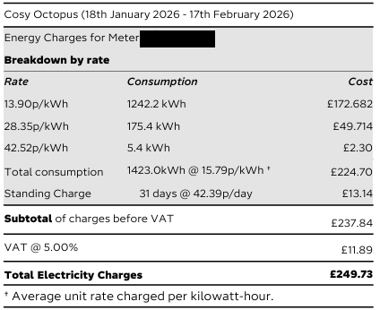

Last winter, I achieved an average import price of ~20p running Octopus Cosy with no battery but avoiding the peak period and running an overnight setback.
This year, having added battery storage, we only ever import at the Cosy cheap rate. Due to the 3 cheap rate periods, a battery size of around 1/4 of max daily usage seems about right (as a fair amount of daily usage can occur directly from the grid during the 8h/day of cheap rate)

But with a modest battery storage the savings are truly impressive…
Take a look at my heaviest heating month of January this year:
The average rate of electricity is as it appears on the bill is 44% below standard rate with my 5kWh usable storage fitted.
With current standard rates at 27p/kWh that saves the average heat pump consumer around £750 pa. on the entire energy bill. Or £7,500 over the ten year life of the LFP battery pack*.
The current cost of a fully installed 5KWh rated system it is in the region of £4 to £5k. If part of a solar array it can be as low as £3k. (ref Octopus energy)
Therefore the pay back is currently around 6 years which is typical for home energy investments. LFP is particularly suited as it uses iron and phosphate rather than cobalt and nickel and therefore much greener.
