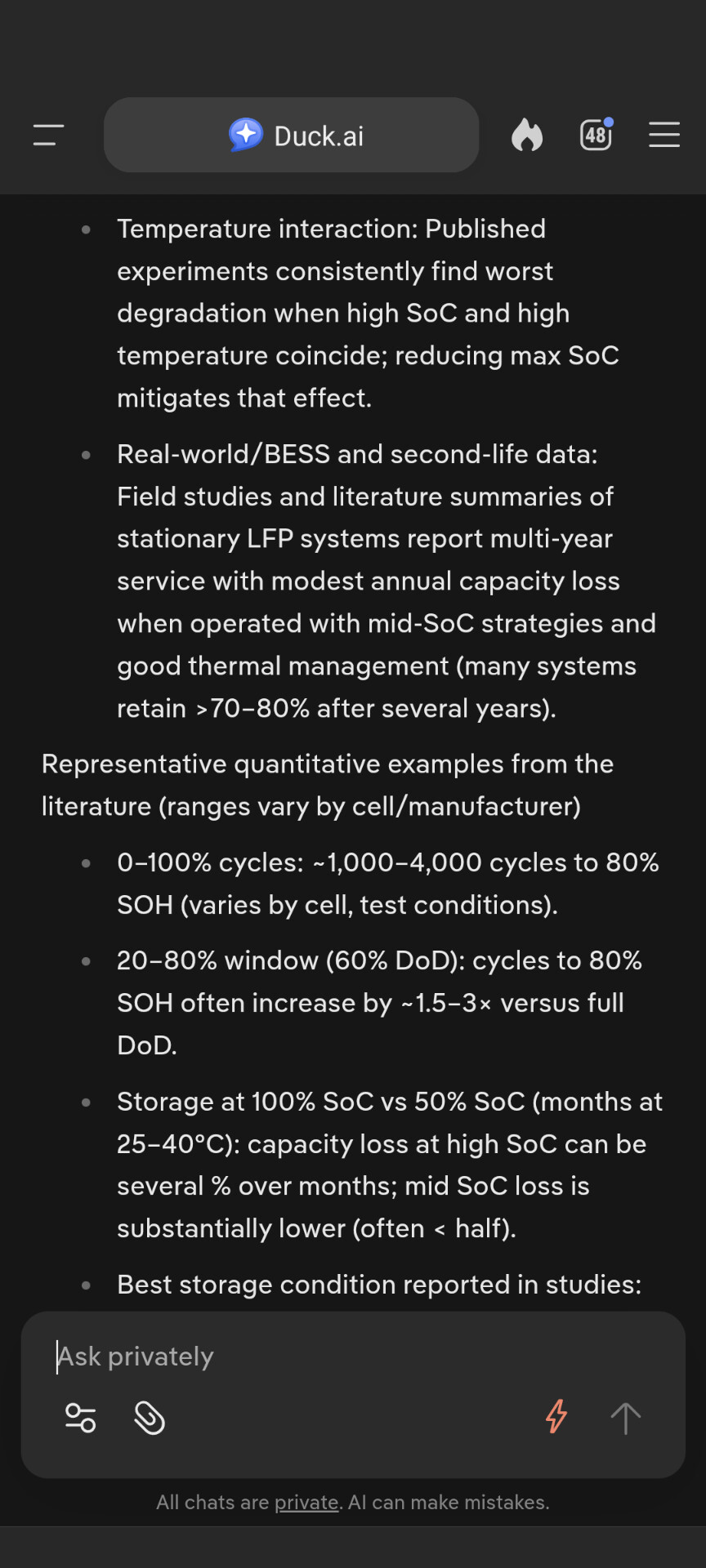

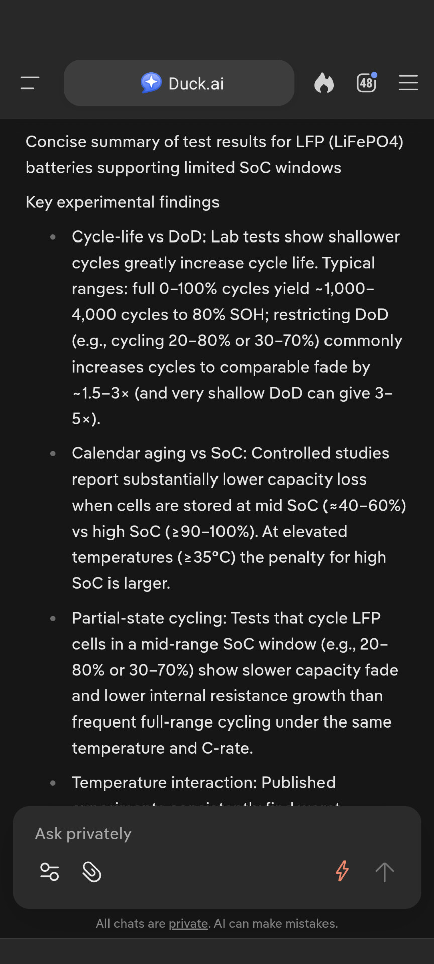

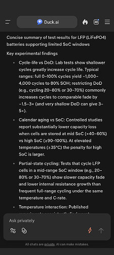

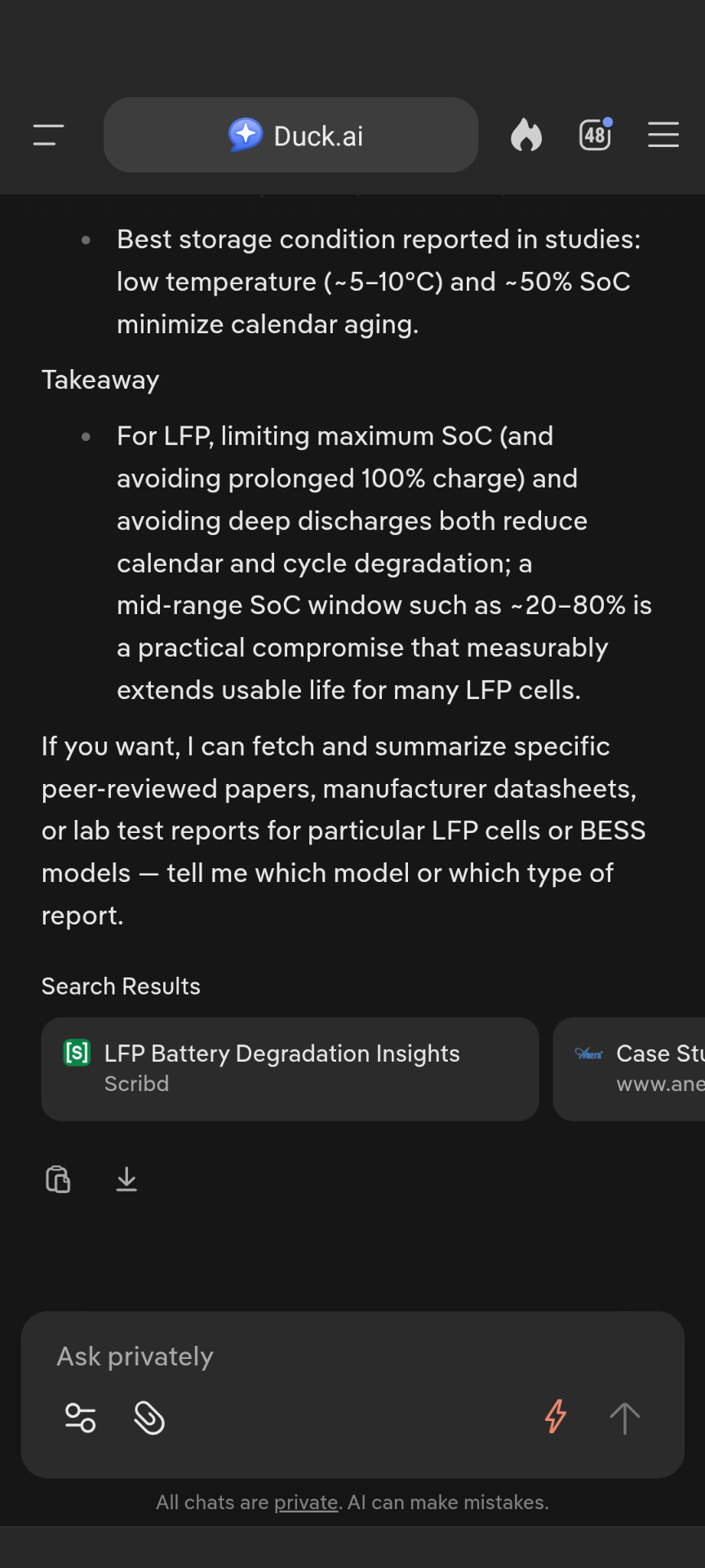

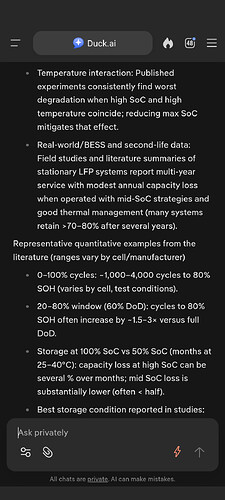

Hi Martin, I am bit confused. I thought that the 20% to 80% cycle test data was for Li-ion. Can anyone find a reference that LFP home storage can be cycled from 5% to 100% without too much degradation other than aging? Certainly that is what is claimed in the link above but maybe they are wrong. Lots of conflicting information out there.
PS I think the main reason for confusion is that with home LFP batteries manufacturers already enforce safe depth‑of‑discharge limits, so you’re not actually hitting the “true” 0% or 100%. For example on my battery you cannot change from “100%” so I think that is what is happening here.
I hope this shows the search results that I found, even if back to front:
Thanks for that. In the case of my home storage it seems that that the real SOC values are not visible to the user. My batteries can only be set in a range that supports the warranty. I cannot change the 100% only the reserve value which can be set to down to 5%. They are just user settings.
My Dyness user manual says SoC shutoff on inverter should be set to 20%. Compare that with the latest DL5 series which says set to 10%. In both cases the cycle life is quoted at >6000. So best consult your manual for the correct inverter settings for your particular home storage battery.
The recommendation is the battery is not left for a long time below 20% or above 80%, it not an issue to discharge to 5% and charge to 100% if charging every night and discharging below 80% every day.
