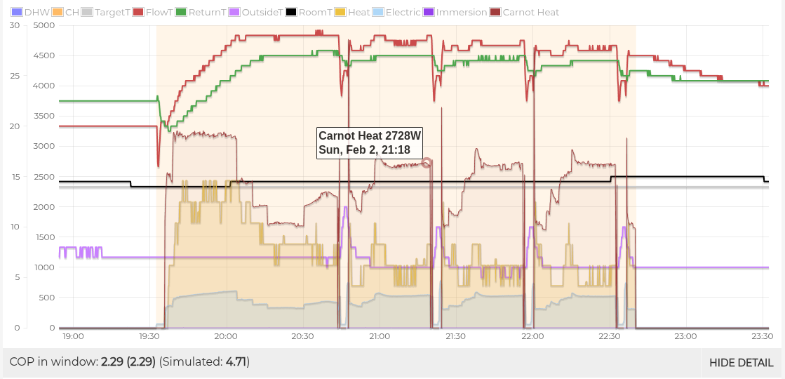

Heating 200L of water from 35° to 53° requires 4.2 kWh of energy, yet this heating period only produced 2.6 kWh. This says to me that the heating power is being under reported, due to poor attachment temperature sensors (a common problem). Actual COP might have been closer to 3.3.
This period shows the flow and return temperatures falling together while the pump is on, which is a good sign, or shows that both sensors are equally bad.
Defrosting every hour is about normal; quiet mode might help with that.
…though this period and this period shows the flow temperature slightly below return, which ought not be possible.
I also see that your system runs the pumps whenever the outside temperature drops below 4° - this is Ecodan’s “anti-freeze” mode. Does this mean there’s no glycol in your system?

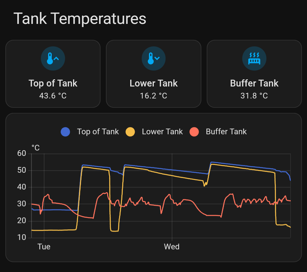

For the water I do have the sensor at the bottom of the tank so the top was still warm. I have it at the bottom to make sure I have plenty of hot water.
For example this is my setup right now and the ASHP sensor is at the bottom.

Oh, and another thing - plotting the idealised Carnot heat output at 50% shows how much heat you would expect to get given the flow temperature vs. outdoor temperature. At this power level and flow rate, dT ought to be closer to 4° with COP around 4.7.
0.1667 litres/hr × 4,180 J/kg.K × 4°K = 2,787 kW
I’m not sure what this means?
Carnot is a formula that simulates how much power a heat pump will output, and all (well metered) installations will fit between 40 and 60%. Yours it falling well below that, reinforcing my suspicions that the system is under reporting heating power, and is actually performing much better.

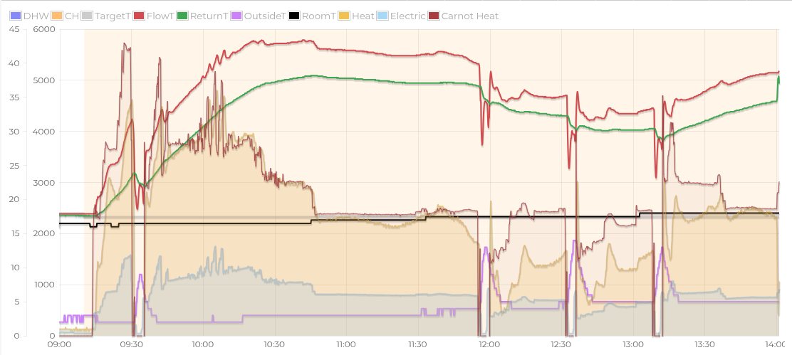

Here’s my analysis of how your system has been running today, from 9am to 2pm.
  • generally, the temperature measurements look good, though flow is 0.3° higher than return.
    You could apply a calibration offset at an appropriate point in the data processing.
  • 9:00 sees end of nighttime setback, triggering the start of the heating. Heating power increases, though is below expected output.
  • at 9:30 the heatpump does a defrost because it’s noticed the lack of heat
  • heatpump delivers nearly 4kW of heat for the next hour, before modulating down to lower power. Heating power matches to Carnot formula reasonably well (red line, factor of 0.43).
  • from 10:45, heatpump settles into a nice steady state, delivering an even 2200W of heat for 800 W for one hour.
  • around 11:50 we see the heating power falling away despite the same input power, which indicates that the outdoor unit is frosted up.
Overall COP up to this point is 2.9, which is close to what we would expect for these conditions.
  • after the defrost at 12:00, the heating power doesn’t recover as one would expect, not even managing the output it managed before the defrost. Flow temperatures are dropping.
  • at 12:30 it tries another defrost, but is again unsuccessful
  • it tries a 3rd defrost at 13:10, puts in a bit more effort, and by 13:40 has managed to operate properly again.
  • 14:00 sees the start of the water cycle, which I’ll comment on separately
I’ve spotted this pattern happening a number of times on your system often around midnight. You might want to go look at the outdoor unit and check it’s defrosting successfully.

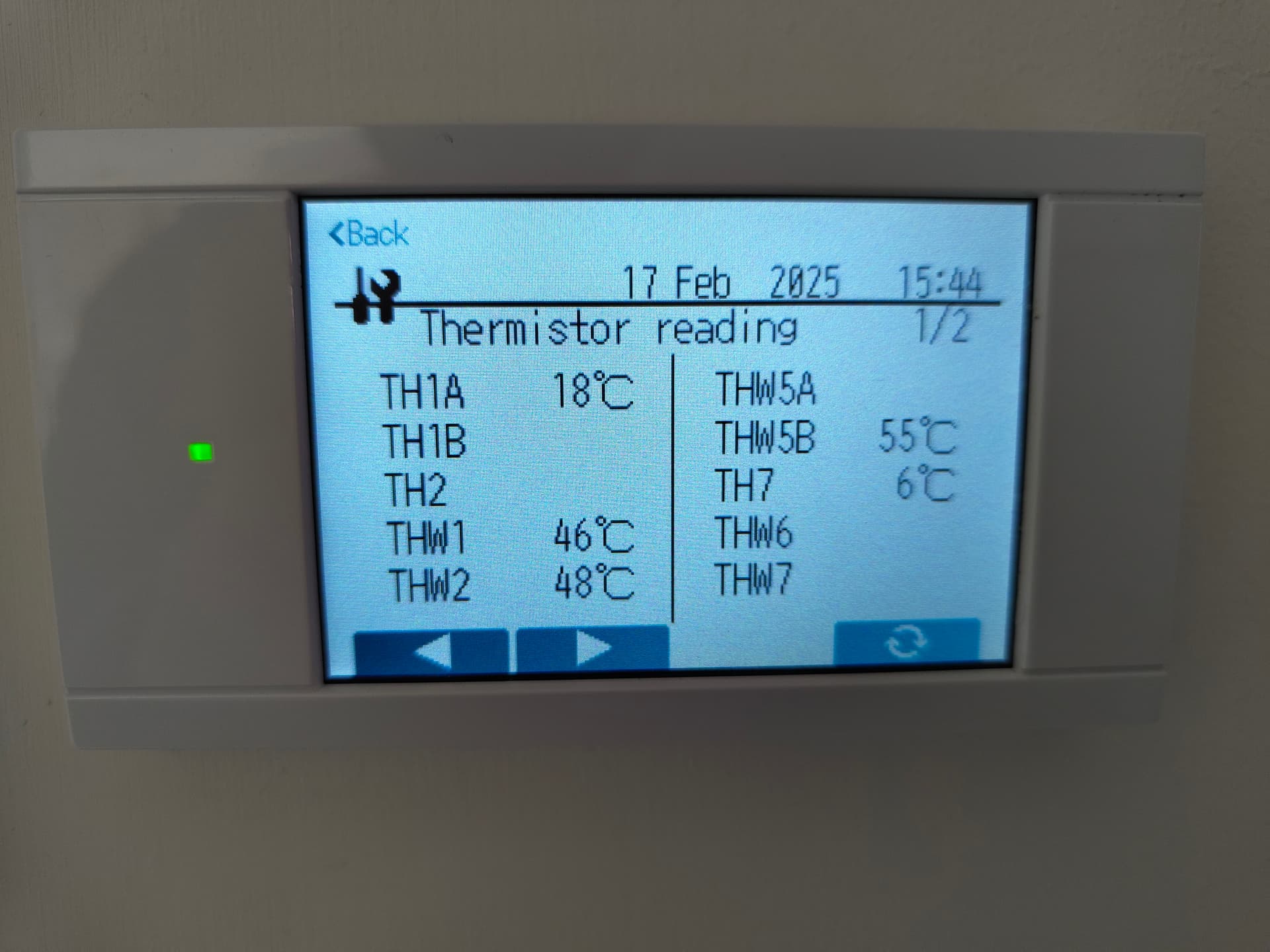

you can update @f1p firmware to get the TH3 and TH6, TH3 gives a good indication why its defrosting.
I’m already up to date. Which is TH3 and TH6?
TH3 is the liquid pipe 1
TH5 is two phase liquid pipe
Its the thermistors fitted at the back of the outside unit (th3 bottom, th6 top). For me if delta temp between th3 and outside >= 10k, its going to defrost
I’m on this atm. Not sure I see that
Might message the dev
@f1p is probably too lazy :joy:
He needs to build new bin files. You can build it yourself ofcourse
This is all my unit has
