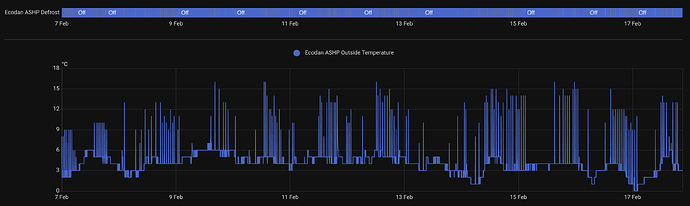

Any tips for COP improvments? Ecodan 5kW

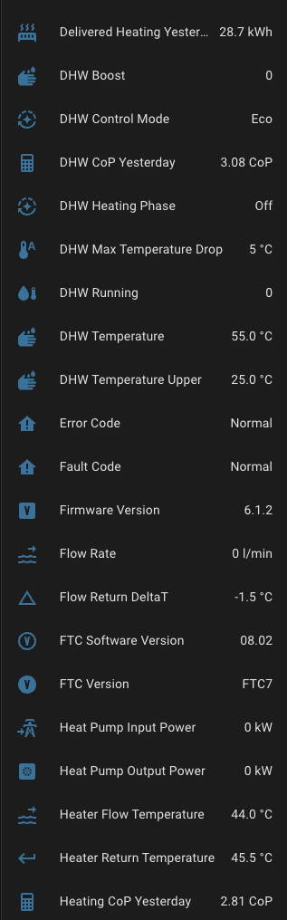

Thanks. Have installed this now. Both TH3 and TH6 are reading 0 at the moment. Will see how it goes.

Monitor TH3, defrost and outside temp, and see if there’s a relation between them for your install
You might get some insight why its defrosting. Also I remember the ecodan needs a certain min return temperature to do the defrost, but yours are pretty high, so that’s not the problem.

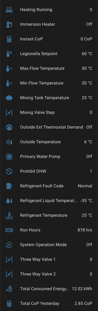

TH6 sitting at 6 and TH3 at 11.
I have no idea what these mean but can watch them.

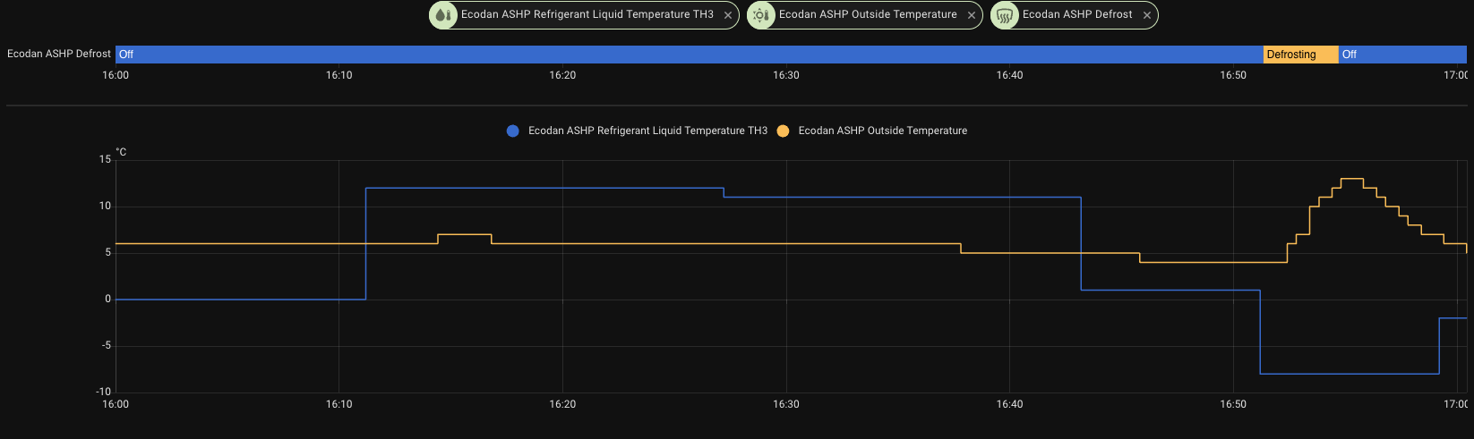

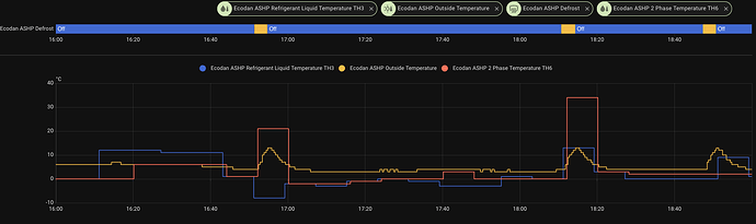

plot defrost, TH3 and outside temp, for me delta around 10k triggers a defrost, you can see that TH3 will gradually go down when more ice is forming. Try to understand why. Monitor TH3 before and after defrost, is it still low?
Will keep an eye. Captured first event
so TH3 before defrost was around 10c, but then drops to around 1c. Probably resolution is not high enough. When defrost is finished, whats the TH3 afterwards? It seems colder than before it started, so maybe defrost did not worked well enough. Can you plot TH6 as well? That’s the water temp flowing in when defrosting.

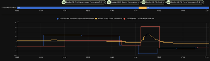

For example, this was my last defrost today:
You can see that TH3 eventually is becoming -1c again. During startup after a defrost, my heatpump is trying a somewhat higher frequency before it settles. TH3 drops because of this (we are extracting more heat from the air)
@Timbones might be on to something, that the defrosting is not working as it should and then defrost too often

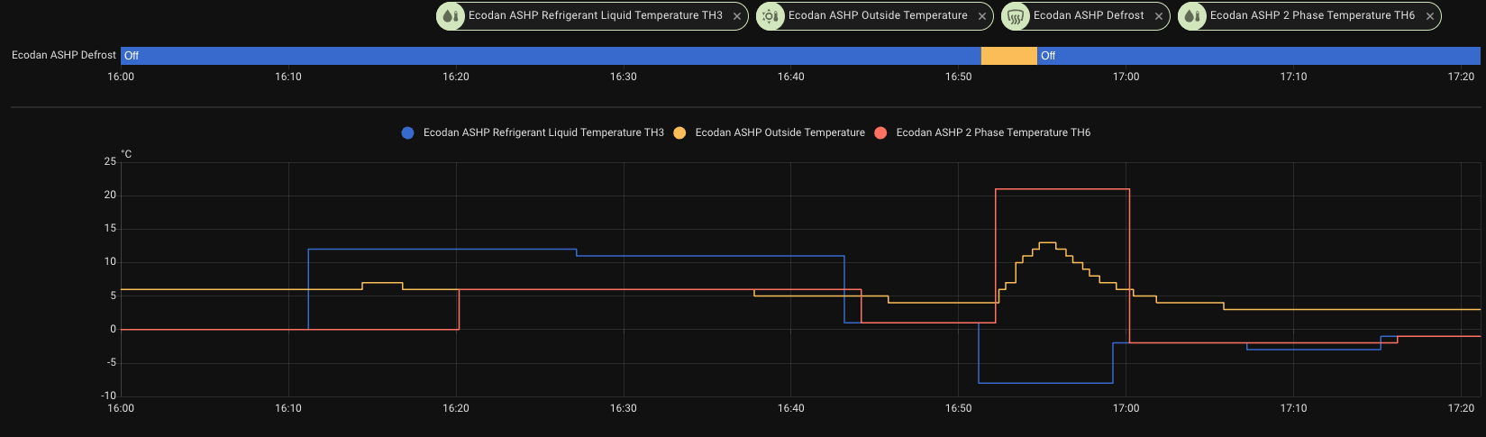

Added TH6:

TH3 seems to go back to before value. Its defrosting 30 mins after the previous, that seems too fast, is it very humid outside?

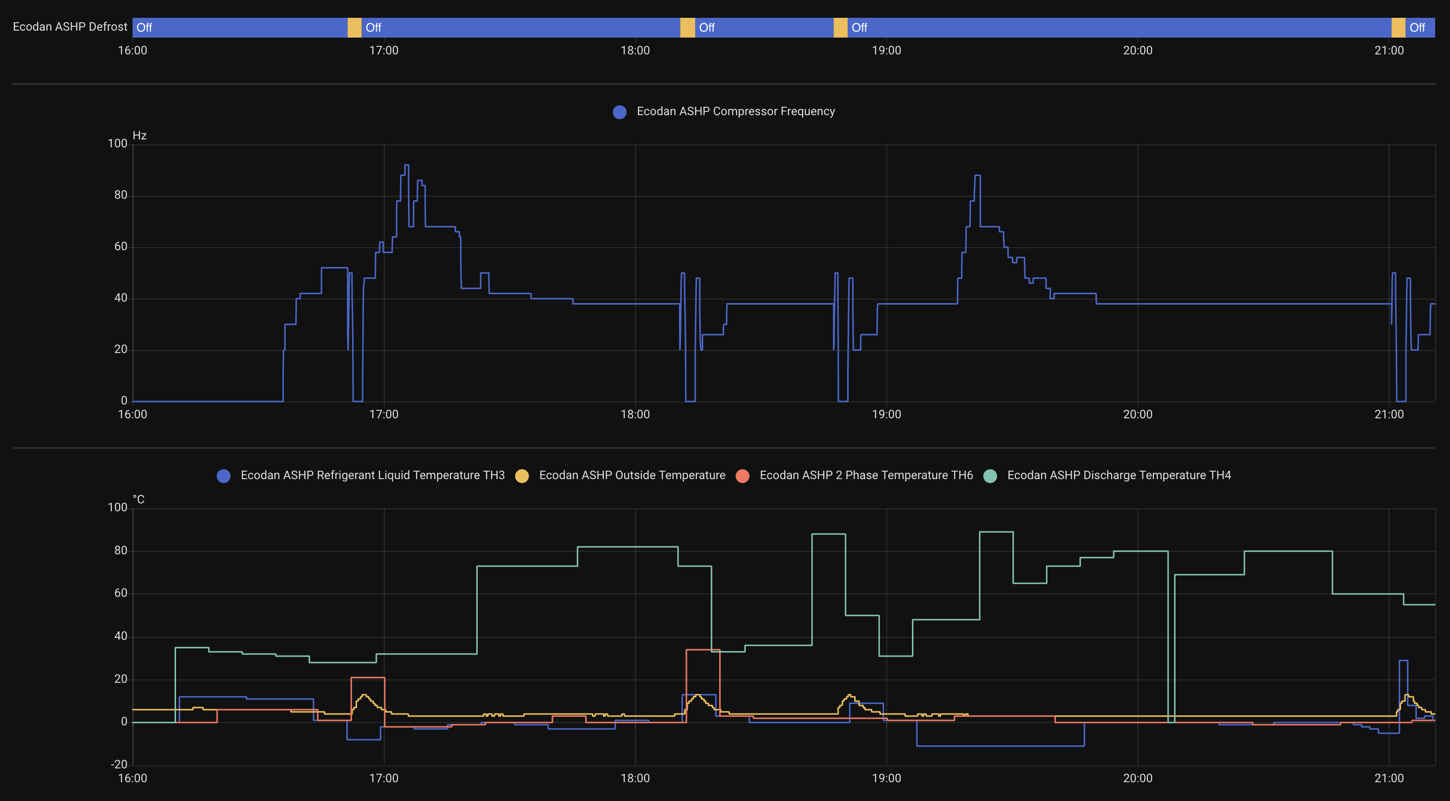

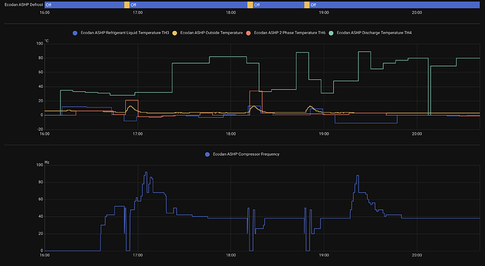

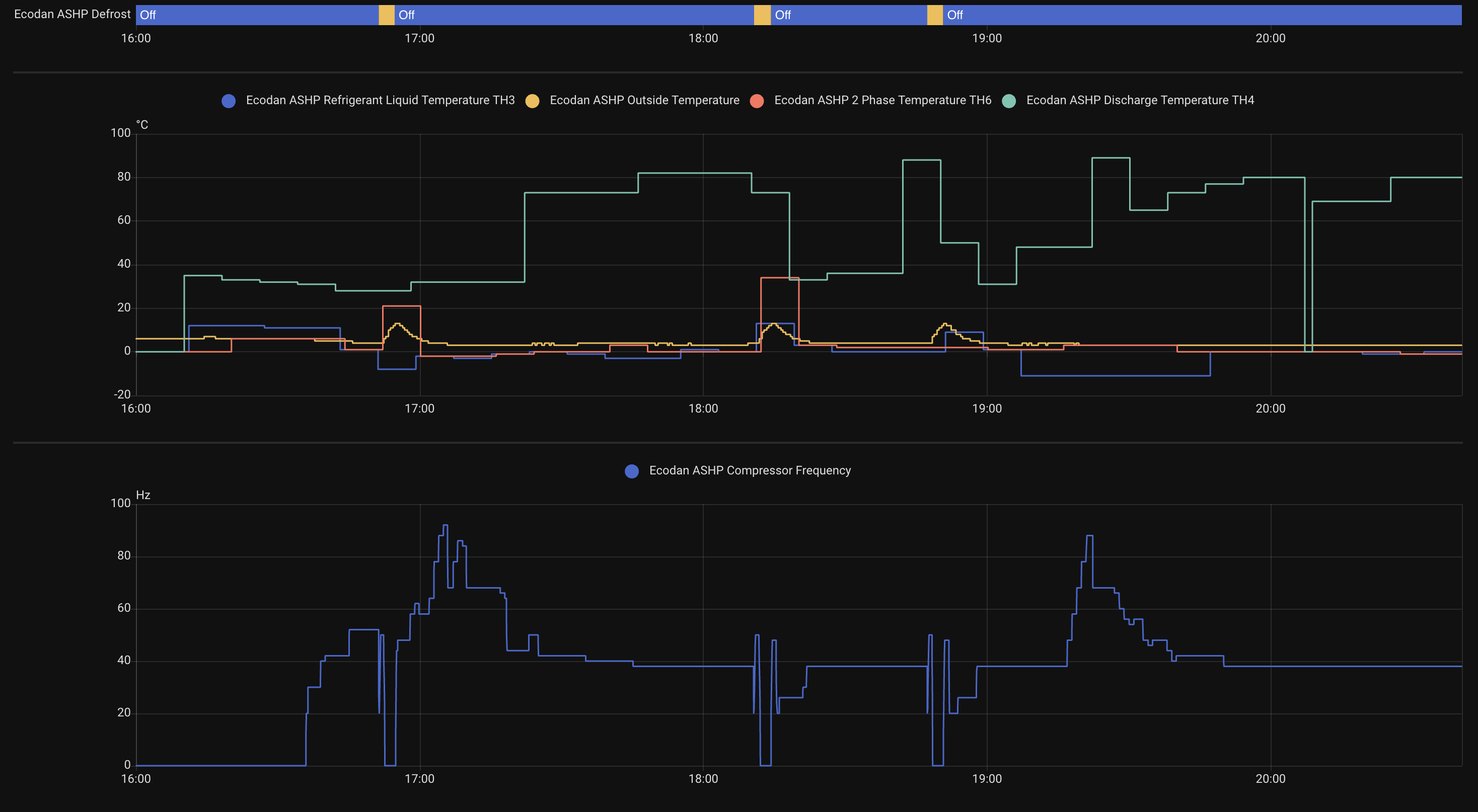

Can you plot the defrost, discharge temp and compressor frequency ?
Im on the faster TH3 build now too.

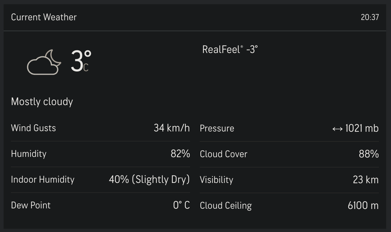

Doesn’t seem too humid. Accuweather is saying:
yeah 80% is fine, defrost every 30 mins is only normal at > 90% humidity and near outside temp <= 2
Your discharge temp seems a bit high. You mentioned that the installer is coming by, ask them to check for low amount of refrigerant. Complain about way too low COP.
[edit] Hmm ftc7, so R290, I don’t know the normal range for the discharge temps :frowning:
That could be an explanation of the bad COP and too frequent defrost. Is your system defrosting with mid temperatures?

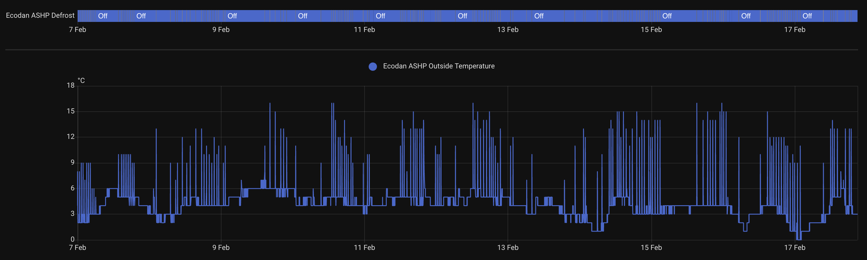

Depends on what mid temperatures are:
Randomly picked another day with ‘ish’ temps:

I can mention that I asked people here and they recommended checking for low refrigerant due to a lot of defrosts & low COP
I see multiple defrosts around 6c outside temp, was it humid ? I would not expect this to happen with 6c outside temp. You can mention that and your bad COP.
Not sure tbh. Don’t have reliable humidity history
