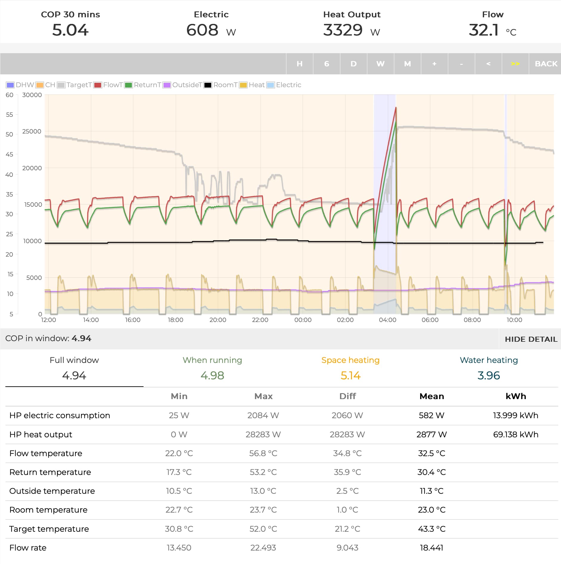

Definitely interesting, I have this in a separate Heatpump app where I use tank temperature for the room temperature feed. Would be great to have it included; at the same time a “target tank temperature” feed should be added. It looks like this for me:

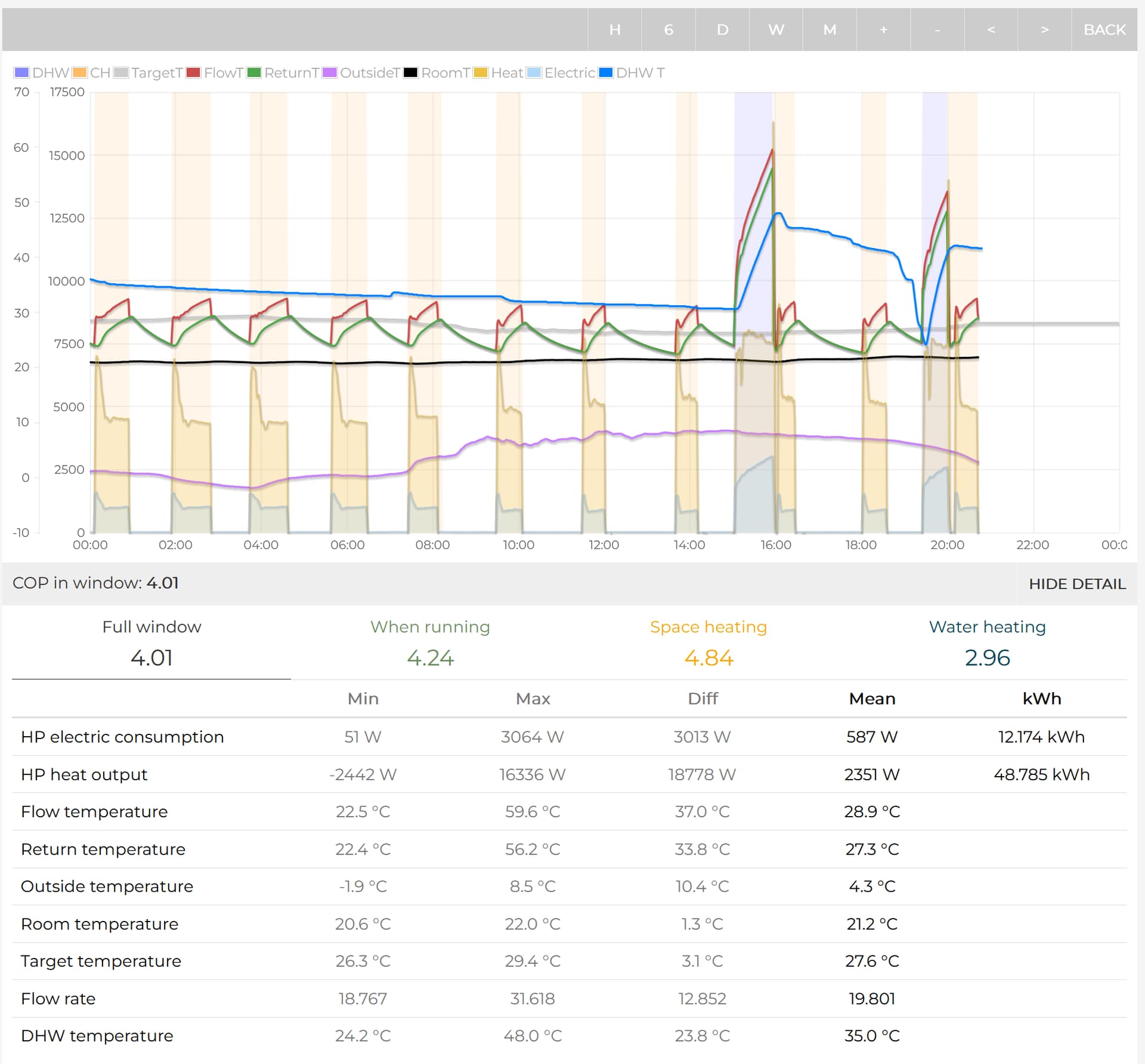

I’m using a Zigbee temperature probe sensor in an extra pocket nearer the top of my DHW cylinder. I port the signal via Home Assistant to my heat pump app using the ‘Emnocms History’ integration and use the ‘Target’ feed to display it in Myheatpump" dashboard.
it’s more useful knowing tank top (tap water) temperature. Here’s an example.

I don’t think emoncms calculations are effected. I am only adding an additional displayed item from my own independent sensor. I was not using the ‘target’ feed for anything. I did query if that feed could be use re-labelled to ‘DHW temp’ or similar, but apparently not without effecting all users?

Yes unfortunately it says target but its DHW.
It will mostly be meaningless when comparing system performance as a tank temperature measured at a single location does not tell you much about the water in a tank.
I agree. It’s useful though on my specific system positioned where it is as it gives a good indication of how much hot water we have left

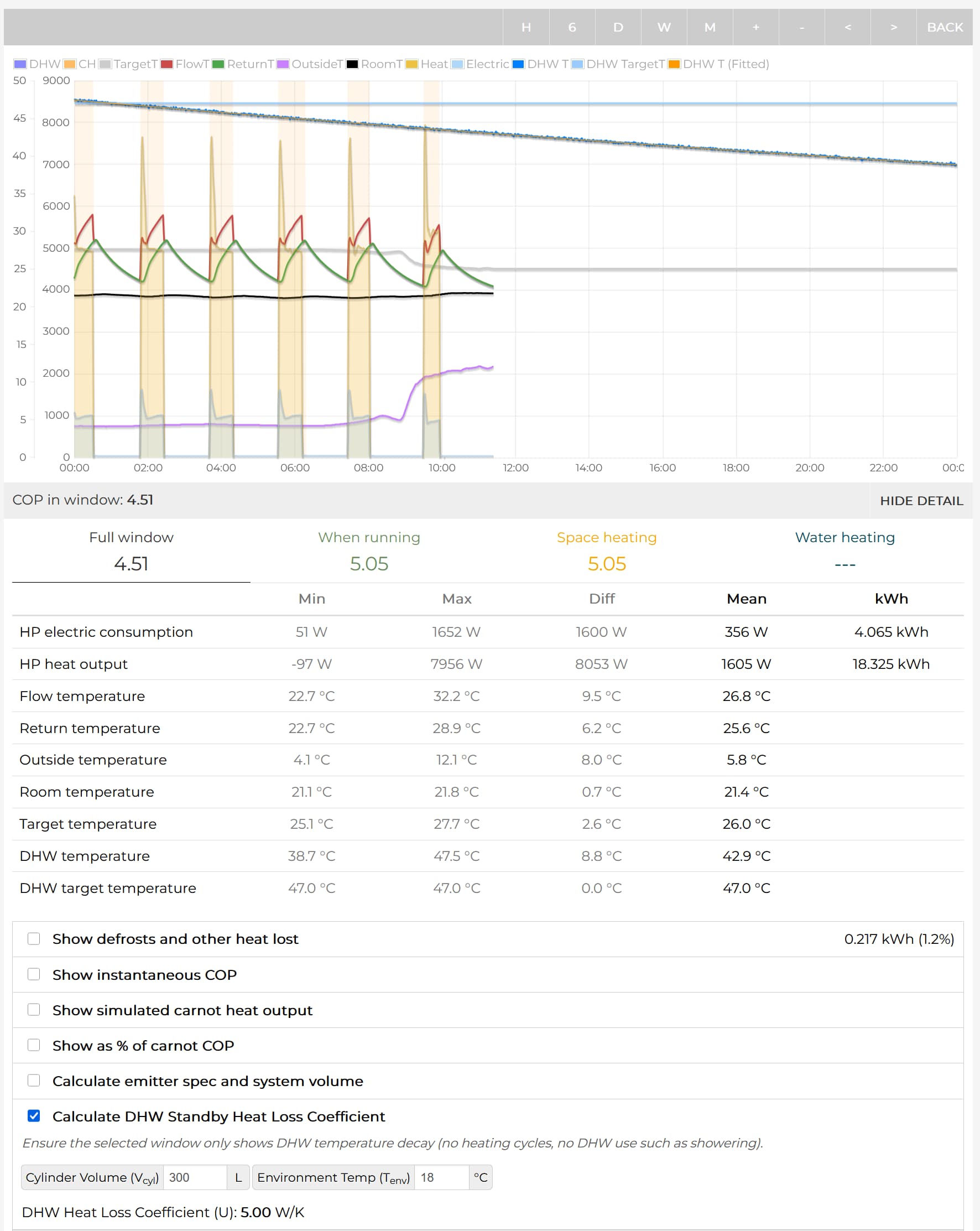

I finally got a local development environment going and this is the first thing I’m adding. I’ll create a pull request shortly.
That’s brilliant, thank you.
Will this also become available on the emoncms website, or only for self hosted?
I think it could definitely propagate to the emoncms website. I tried to keep the changes minimal to not interfere with the code base too much. I created the pull requests on GitHub. I implemented both the display as well as a tool to estimate the heat loss coefficient of the tank given its volume and ambient temperature of the cylinder room.
