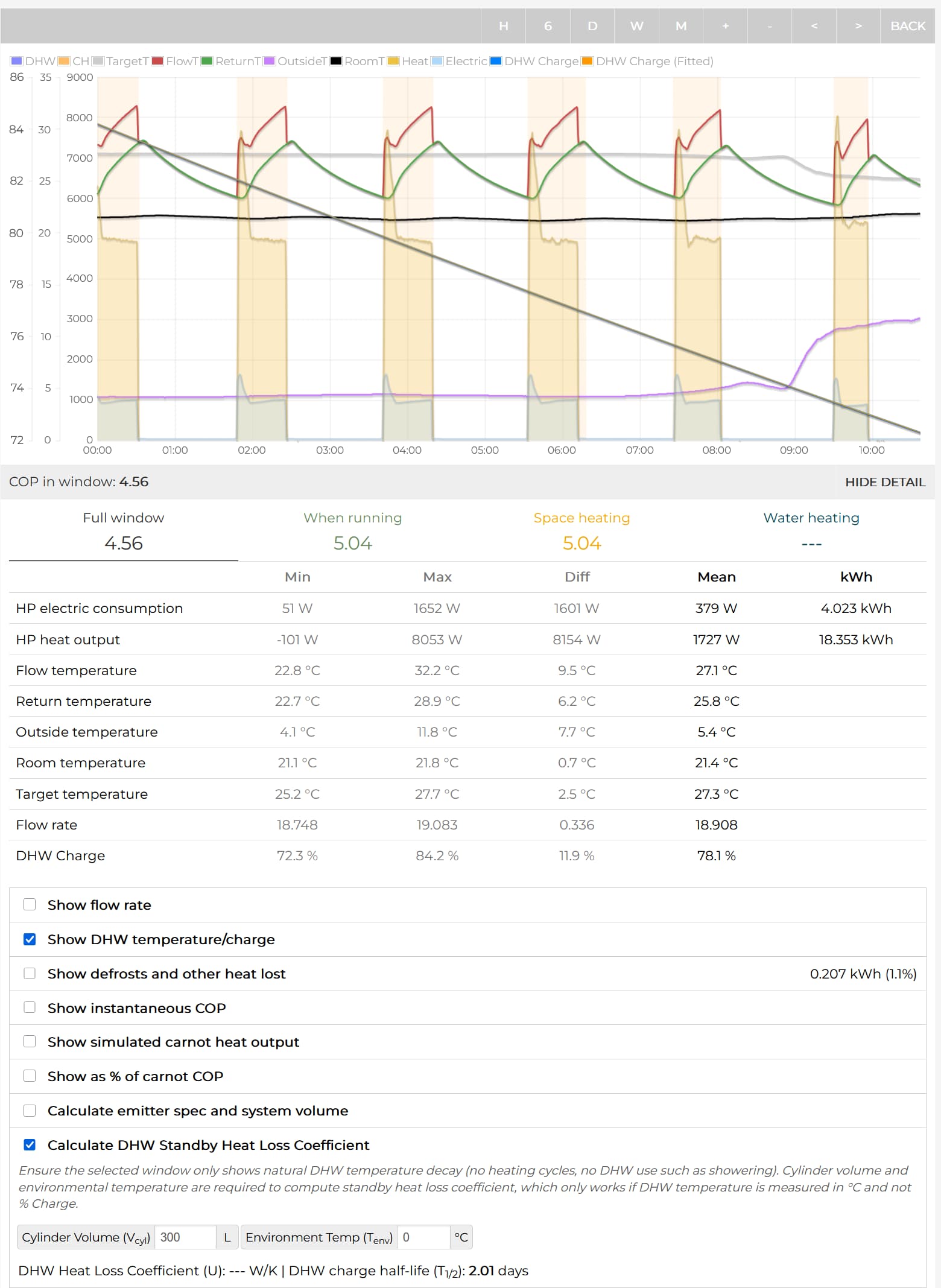

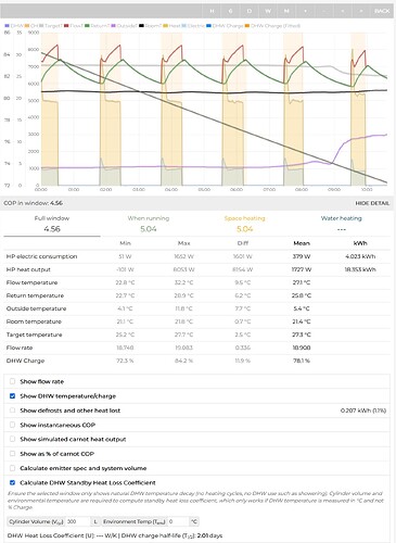

For display only that’s easy, the standby losses are a different story, for those I need a temperature to subtract the ambient room temperature from. But maybe display would be enough for now?
How’s that? Assuming the charge % drops during standby, you even get a half-life measurement.
