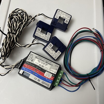

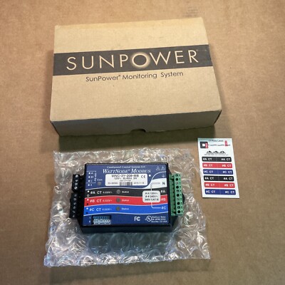

I’ve switched from the Elkor WattsOn to the Continental Controls Systems WattNode.
Two points made it a no brainer for me.
The device is powered by the mains its connected to. No need for a separate PSU
as with the WattsOn.
It uses 333mV CTs which are available in a wide variety of ratings, and no need to use a CT scaling factor.
Cheaper too. To wit:

That would be my recommendation.
Here are two WattNodes that would work for your use case:

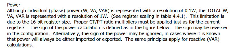

I’m not sure I said that. What I said was that the resolution of the Irms registers after you’ve scaled them to match your CT sensitivity is not relevant to the resolution of the Power (and Energy) register readings.
Presumably you will also need to scale the Power (and Energy) register readings to match your CT sensitivity. So I asked what the resolution of those registers are. But I found the answer myself:
That also confirms you need to apply the same scaling to these readings. So you will get 1W resolution if you use 5A CTs, and 10W resolution if you use 50A CTs etc.

I’d use 2 phases, one utility and one solar. There are no installations any more like this - all sites utilizing solar must use a 3-phase system now. But I might be able to get better res on individual phases. They shoulda chosen bigger register sizes. Where is the excerpt from?

Yes, looks like per-phase power resolution is 1/10th of a Watt. Do you only have 2 of the 3 phases running to your property? If so, you might need to dig deeper to determine if the underlying IC used in that meter can cope with no connection on 1 phase. I vaguely recall some of the poly-phase ICs want all 3 phases wired - but don’t quote me on that, it’s a long time since I’ve looked at the poly-phase stuff. In the end, we went with 3x single phase ICs in the one box to gives us 3 phase capability.
I think you’re right. I haven’t had time to read the docs on your meter in depth, but if our assumptions are correct I think they’ve taken a very capable core metering system (with huge dynamic range and resolution) and then lost if all at the last minute with their UI soft register choices.

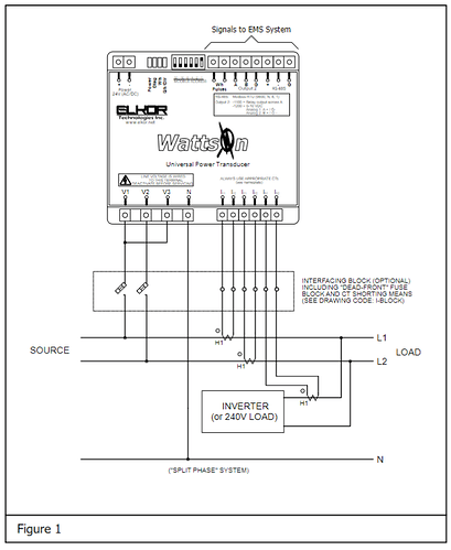

Our house is single phase, so to be more accurate, it’s not 2 phases, but one branch is current flowing from/to the utility and another branch from the solar inverter. The meter can deal with this. The voltage inputs simply need to be shorted.
That describes the use case with the North American split-phase system.
Two of the three inputs are used, the third is simply ignored.
Viz:

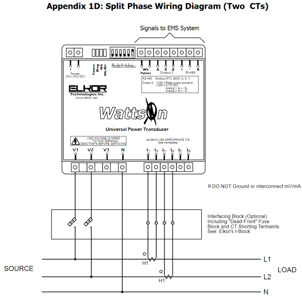

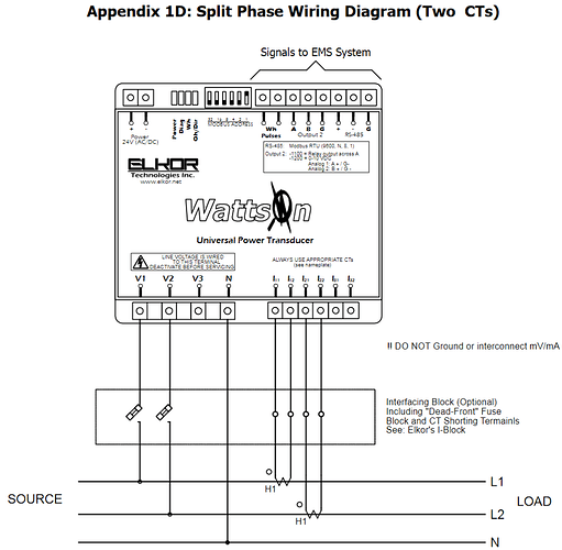

They don’t need to be shorted, although one can choose to do so.

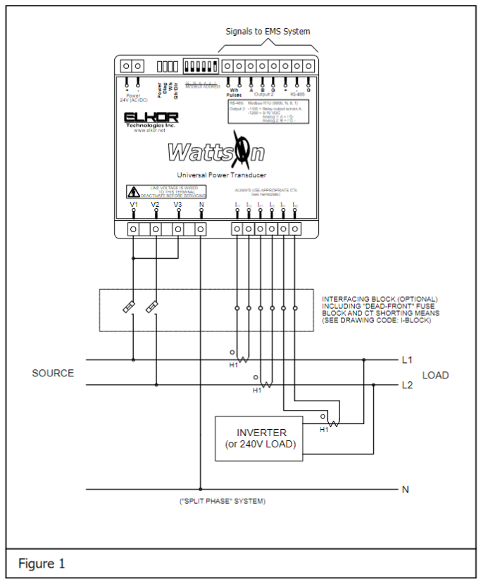

I used my WattsOn - without issue - for about a year, connected as shown in the diagram above. After installing a PV system, the third V/I inputs were used to measure PV energy harvest as per the following diagram:

I might need to re-read the docs, but IIRC it mentions that phases are sampled independently and depending on the used phases (and the electric system, like the split-phase system in NA), a set of calculations are made towards the totals. It would then follow that one would need to hook up the same AC voltage input to all measured phases of the meter in my case. But I’m not 100% sure on that.
