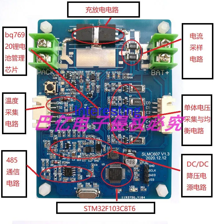

Take a look at this product on AliExpress. This may save you a lot of time and provides documentation and code:
