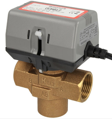

Hi guys,
Could someone recommend a 3-way valve compatible with this heat pump ? I’ve only find valves with 3 lines but Samsung manual says 4 lines needs to be connected. So I have no idea what 3-way valve shall I buy.
Thanks!

If using 2-point control, L (bn, 3) is the permanent live > B16 and Y (bk, 6) will be the switched live > B17, to move the valve to the DHW position.

I was referring to the ESBE VZD above, which is a 2-point controlled valve, with a switched live >B17 to change its position for DHW and a permanent live >B16 to move it back. Neutral >B15

ESBE make good valves, but I generally only use them for mixing applications and prefer the Sintesi for most heat pump diverters, as they have a higher Kvs, ie 18.3 vs 6 for that ESBE VZD, which is useful if only using the primary pump, rather than secondary pumps etc.

If you are only relying on the primary pump then you need to calculate what the maximum system pressure drop will be and ensure you sufficient residual pump head - using a diverter with a higher Kvs will help if need be. That ESBE VZD has quite a low Kvs (high pressure drop), the Sintesi is at the other end of the scale, but there are other options in between that may suit.
That other valve in the link above is a spring return valve with switched live, neutral and earth. It also has a volt free end switch, which could be used to switch on a pump etc when the valve is switched/opened, which you won’t really need to worry about.

As mentioned, a spring return valve will only have a neutral and switched live (maybe an earth), so if it also has another black wire, then its either a 2-point or 3-point controlled - re read all above posts!

I see your point and you are totally right. I was thinking about it and indeed spring return valve would be the best for economy. It’s under load only in cause there is a DHW request and if not, there is no load so most the time it will not consume any energy. Thank you to point is out. I’ve did some calculation and usually these 2-point controlled has 7W constant consumption which is ~61KW of energy roughly which is around 10 euro/year so in 10 year this will be over 100 eur only of an electricity price. The only question is how long these spring valves last.
What would you say for this?
