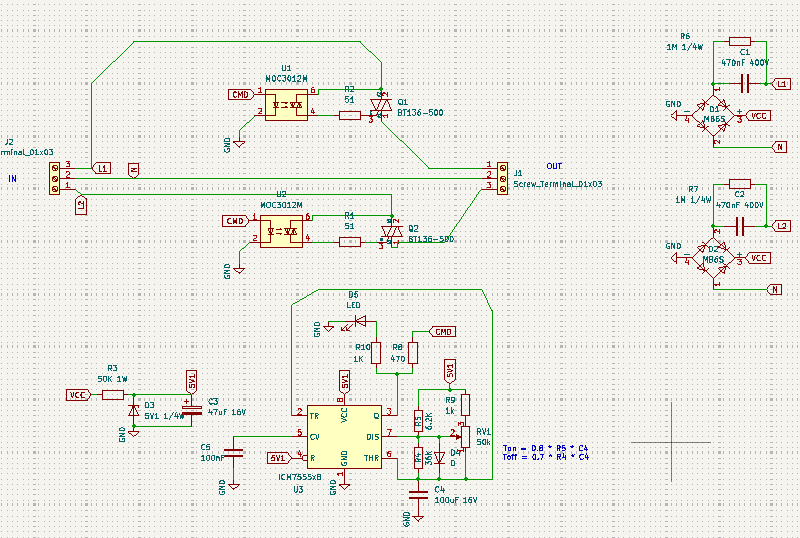

Also, the worst part of the setup is to wire the UFH 3 way to fit the expected opening/closing duration required by the EHS.

Yeah, that one has opening time 15s if I’m not wrong. How did you wire it to fulfill this ? For my pump I can select 60s, 90s and 150s so this is way longer so not sure what would happen if I’d connect this valve. I thought it does not matter how fast the valve opens but I’m not expert in this field.
I made a delayer, to distord time on the valve side with a 1/6 ratio.
EHS L1/L2/N ↔ NE555+triacs ↔ Valve L1/L2/N
Here is the schematic I implemented (I plan on selling assembled PCBs to help others doing the same).
The trick was to power the NE555 from the L1/L2/N line to avoid yet another plug power adapter…
Also, it’s related to speed, but more importantly, it’s a matter of matching the proportionnal opening given an operation time.
[EDIT] After rereading the topic, I just saw I mixed up topics here. The fact that the valve open faster/slower is not a problem for DHW. it’s only a problem for UFH 3 way valve. for which the circuit describe above is meant to.
Cheers
This is nice schematics. Yes, this can be useful for UFH and mixing valves but for my need and DHW I really don’t care about opening times so the simple 3-way valve should do the trick. Maybe I will buy a cheap one and I will be good to go. And maybe it won’t work properly because the HP will complain as this is dumbest pump I’ve ever seen :slight_smile: It even complains if you keep the pump running when the compressor is off :slight_smile:
