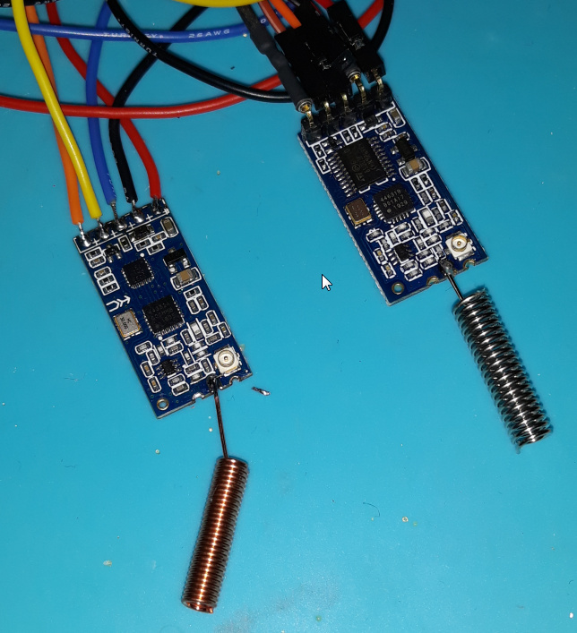

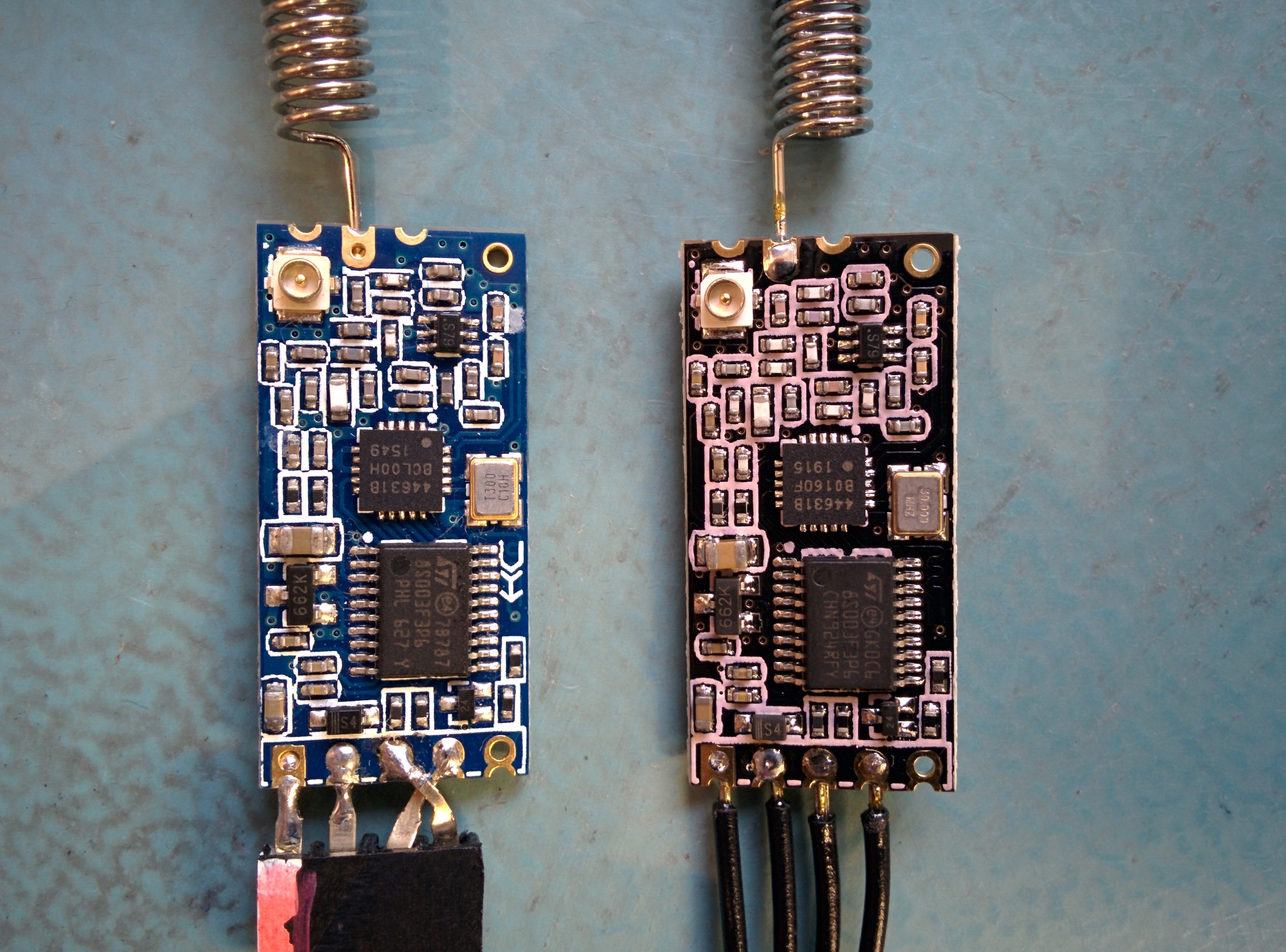

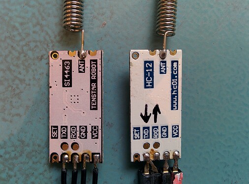

I just did tests on HC-12 of different brands:
they are exactly the same: same circuits, same factory setting BUT they do not communicate together !
If we find the right Modem request message, it remains to be seen whether it is compatible with the HC12 in the Inverter!

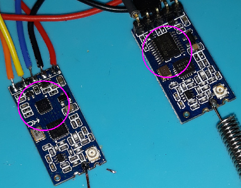

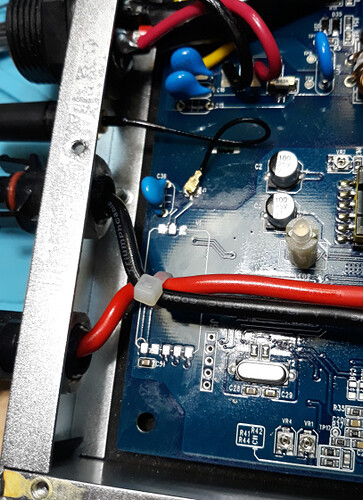

In my WVC600 R3 inverter, I desolder (removed) the HC-12 module and I tested it alone.
I compared it with other HC-12 that I bought in Alliexpress
Conclusion:
HC-12 WSC = V2.6, HC-12 Alliexpress = V2.4 but both communicate well with each other.
It is possible to dump the flash (WVC600)? Can we try to find the message looking over the hex file?
dump the HC-12 flash or WVC600?
My WVC600 without HC-12
Both HC-12
Both HC-12 are not identical (form factor chip and firmware…) but they communicate perfectly with each other, therefore they are functionally identical.
