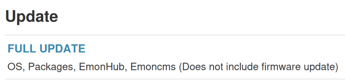

I haven’t had a hand in the emonPi software - apart from writing emonLibDB, since my work to get the ‘CM’ version of the emonPi with the associated library for the RFM69CW was rejected and the powers that be decided to use LPL instead. And without a spare SD card larger than 8 GB or the time and inclination to shrink the download to fit, I can’t actually run the Feb 24 version.
But you’re right, you should be able to write whatever you downloaded to the SD card and put it into your emonPi, update the front end with whatever is on the SD card, and it should work - as Brian wrote. And it’s that belief which made me write last time:
because I don’t know whether the front end gets updated automatically. It used to - but the inference now on the Admin page of my version as you do the update is it doesn’t:

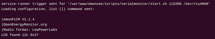

So I made some progress, trying to retrieve settings with the Serial Config Tool.
However it looks like something strange is going on.

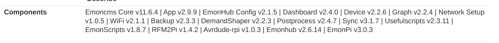

I have the v1.1.4 release of the firmware installed
Along with the emoncms v11.6.4, however the Serial Config Tool doesn’t do very much.

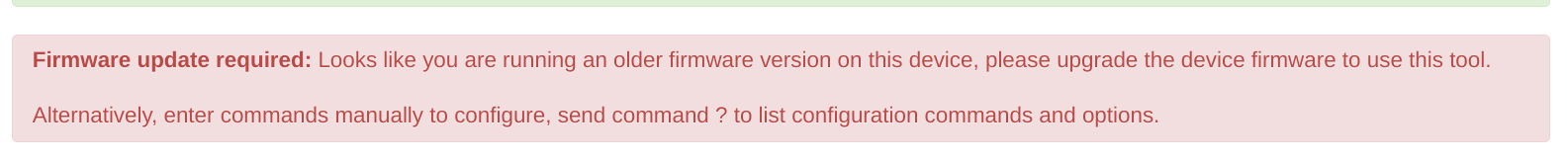

When I started debugging I found it is waiting indefinitely for a ‘MSG:’ to parse configuration from. When I looked at the latest version of the ATMega firmware, I don’t see the firmware Serial.print()'ing a ‘MSG:’ in the emonpi firmware, I do see it in the EmonTX4 firmware however.
It does emit a ‘Settings:’ instead when the configuration is requested. The Serial Config Tool should pick this up and print a warning message telling me to upgrade to the latest version (which I am already running!).
However this wasn’t working because of a bug I identified and subsequently fixed.
I am still a bit confused by the Serial Config Tool, is this tool supposed to work with the emonpi1 at all?
