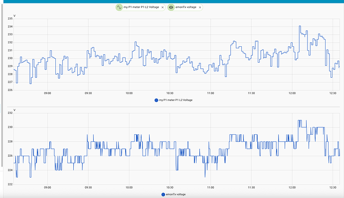

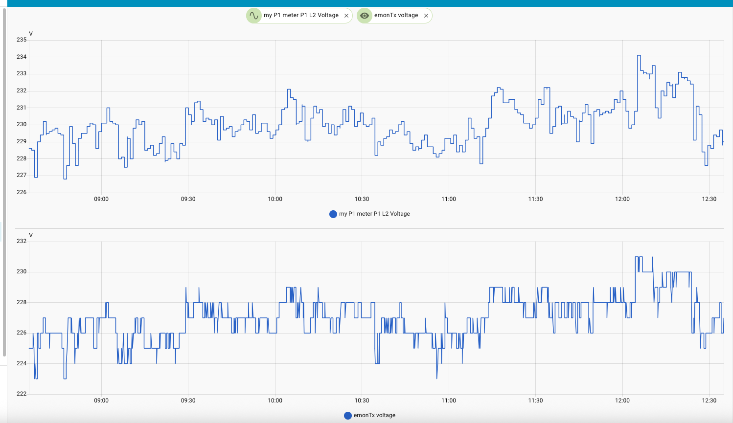

FYI here the voltage measured by my smart meter and emonTx:

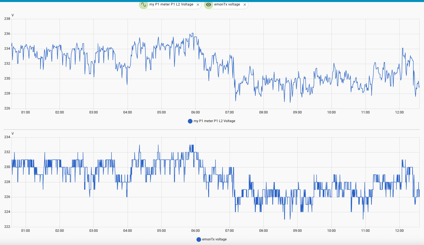

and for the last 12 hours:
It looks very good.
I think there is small mismatch of 3V. So emonTx seams to measure 3V less than my smart meter.

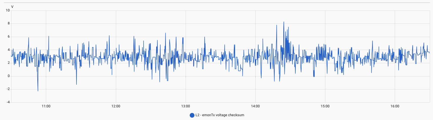

Here below I did a diff between voltage reported by my digital meter for phase L2 and the voltage measured by emonTx:
So it confirms that on average my digital meter is reporting 3 Volt more than emonTx for phase L2
