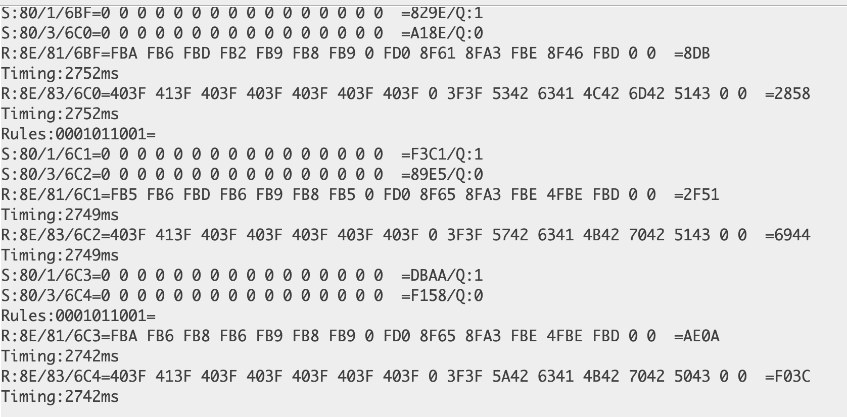

if possible check on a computer where the packets get lost, on android not all the information is available in the modules tab.

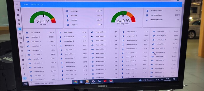

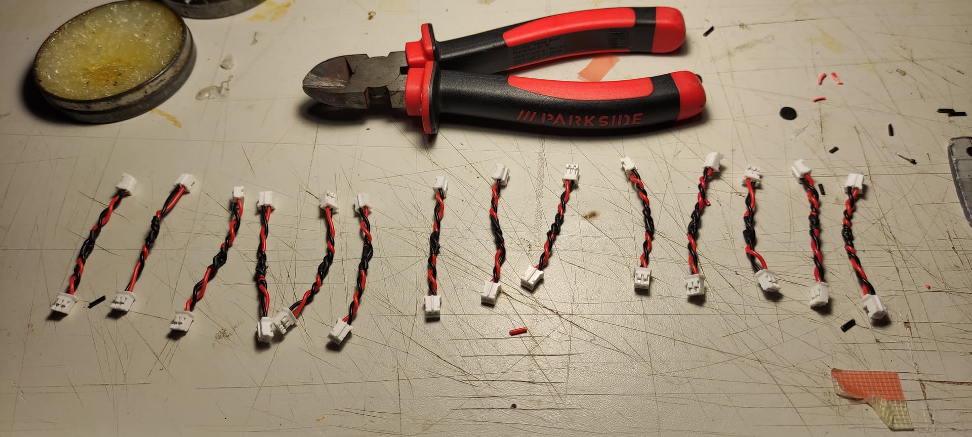

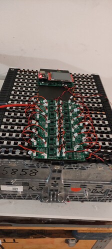

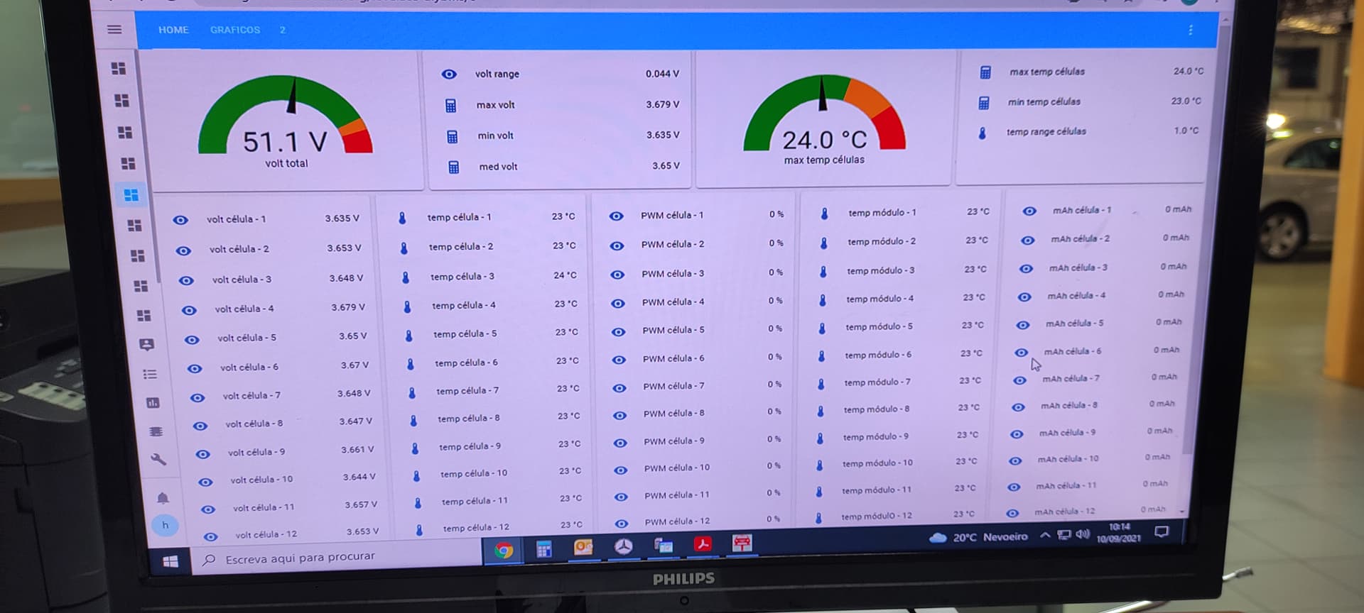

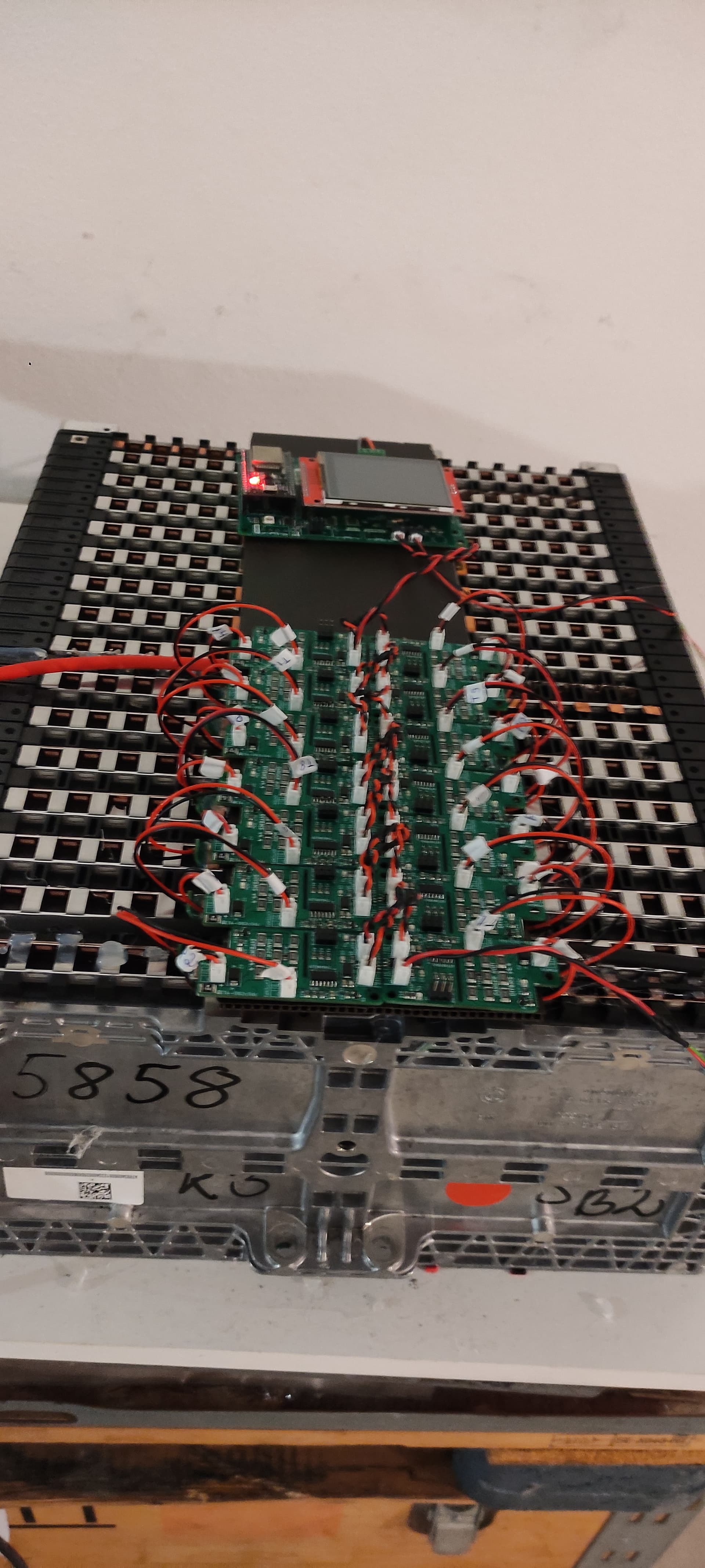

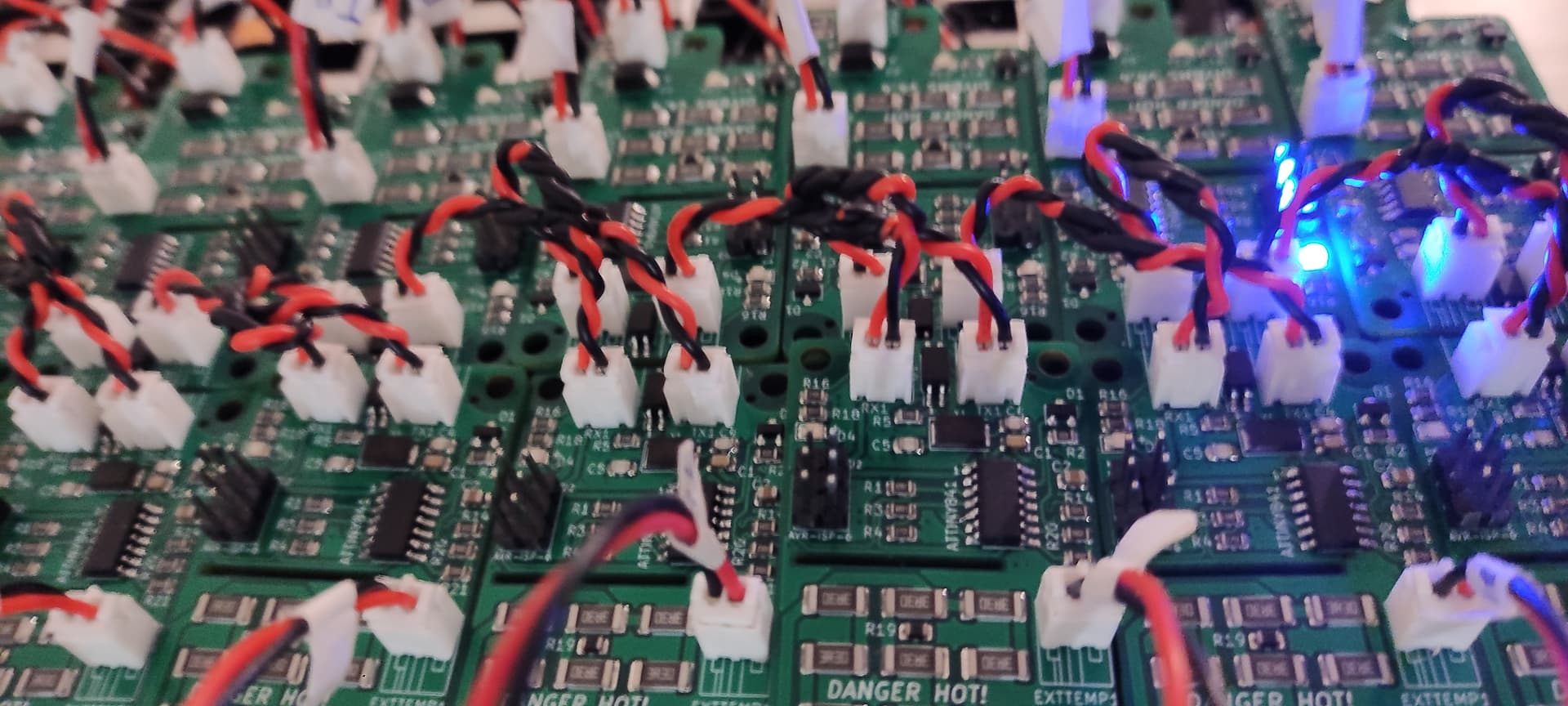

Good morning, after redoing the communication wiring with the jst connectors, it seems to me that the problem has been solved! A whole night without fails. I still can’t believe it, I’ve reviewed the welds 1000 times…!
Now I just have to do this for the 84 cells of the lithium battery and connect to the inverter!
Here I leave photos of the current work and one of the home assistant’s preliminary screen.
Thanks and regards,
Sergio

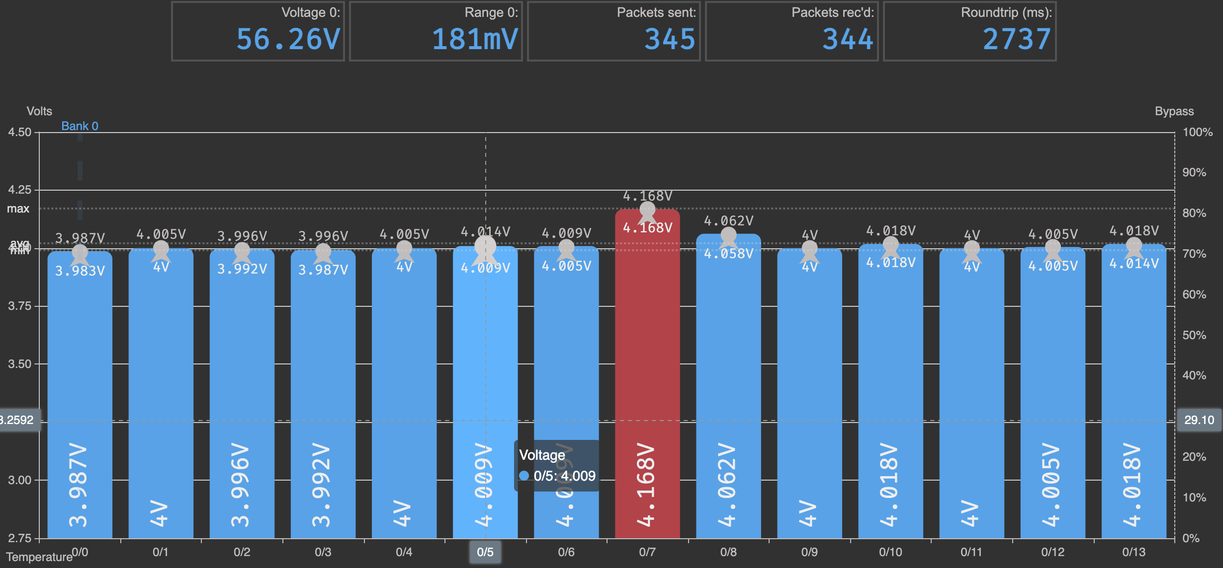

I don’t believe this is my problem, but couldn’t find where else to post.
14S 100P V4 running fine for a long time. Just top balancing not been exercising the cells.

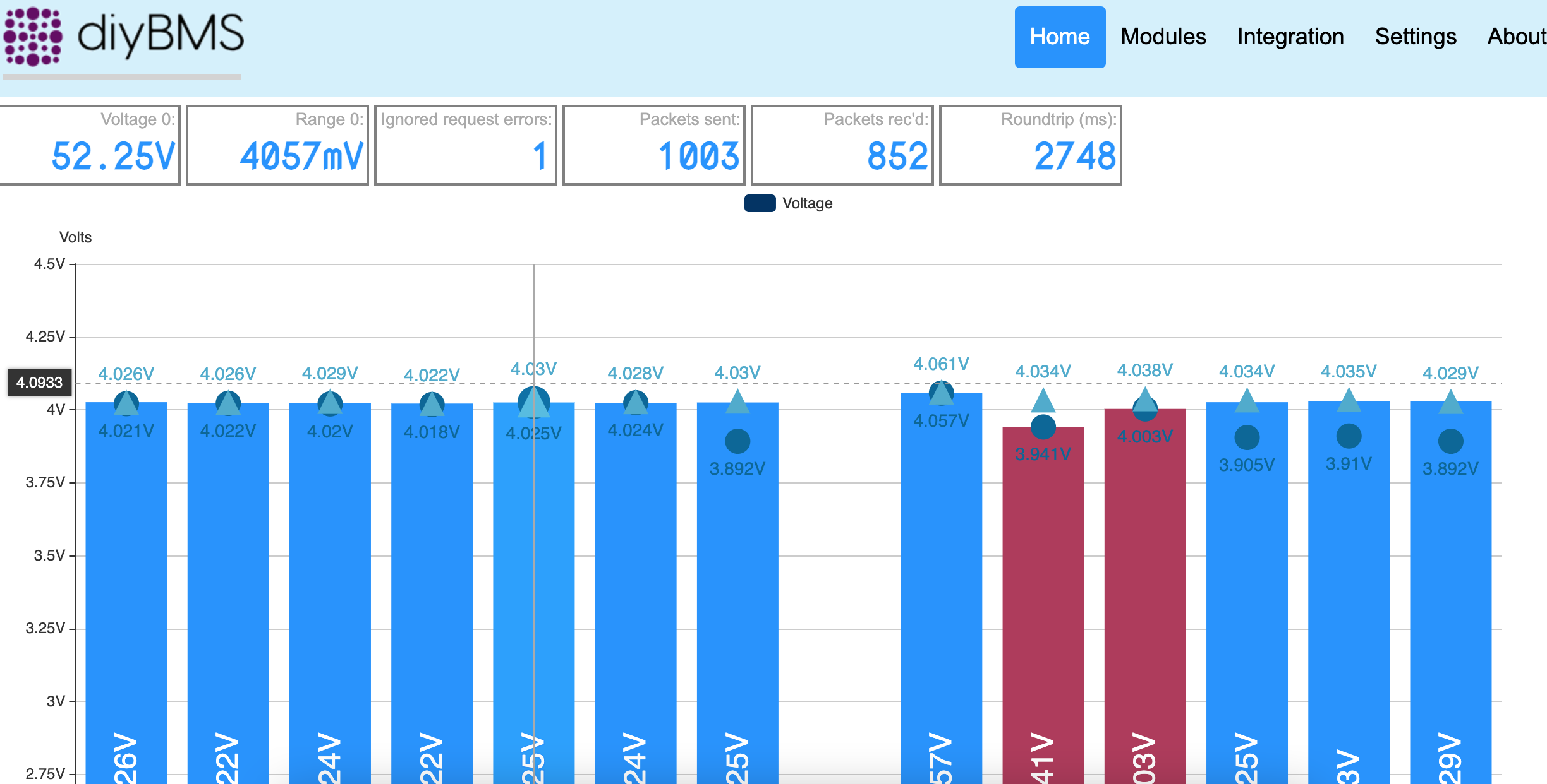

Lost communication with module #7 (beginning of last row of 14S). Green lights running as normal, however no data as to the cell.
I have inspected the module and reheated with blower, still no joy.
Ok, suspect it’s just lost its calibration settings.
See if the calibration value are all zeros.
If they are, reflash the code to the module and it should fix it.

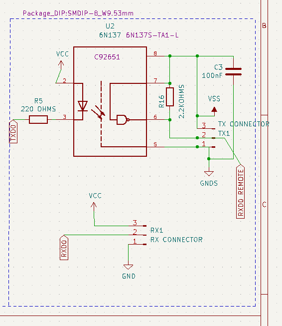

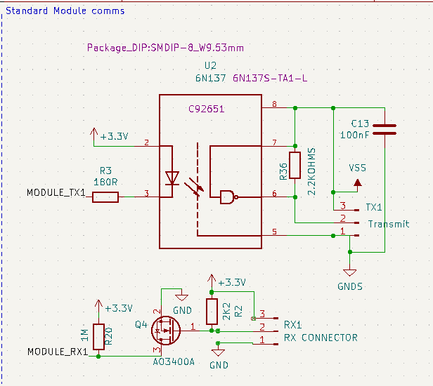

I’ve been using about 550ohms…
2.2K didn’t work for me.
I’m close to 1M packets and 15 errors…

Hi @Albert @stuart , I need more modules and more reliable speed in comm, what do you think about this design? Thanks
module 440:
Controler:
@Nico_F you still don’t need to change to a 3 wire cable to achieve the above circuit.
