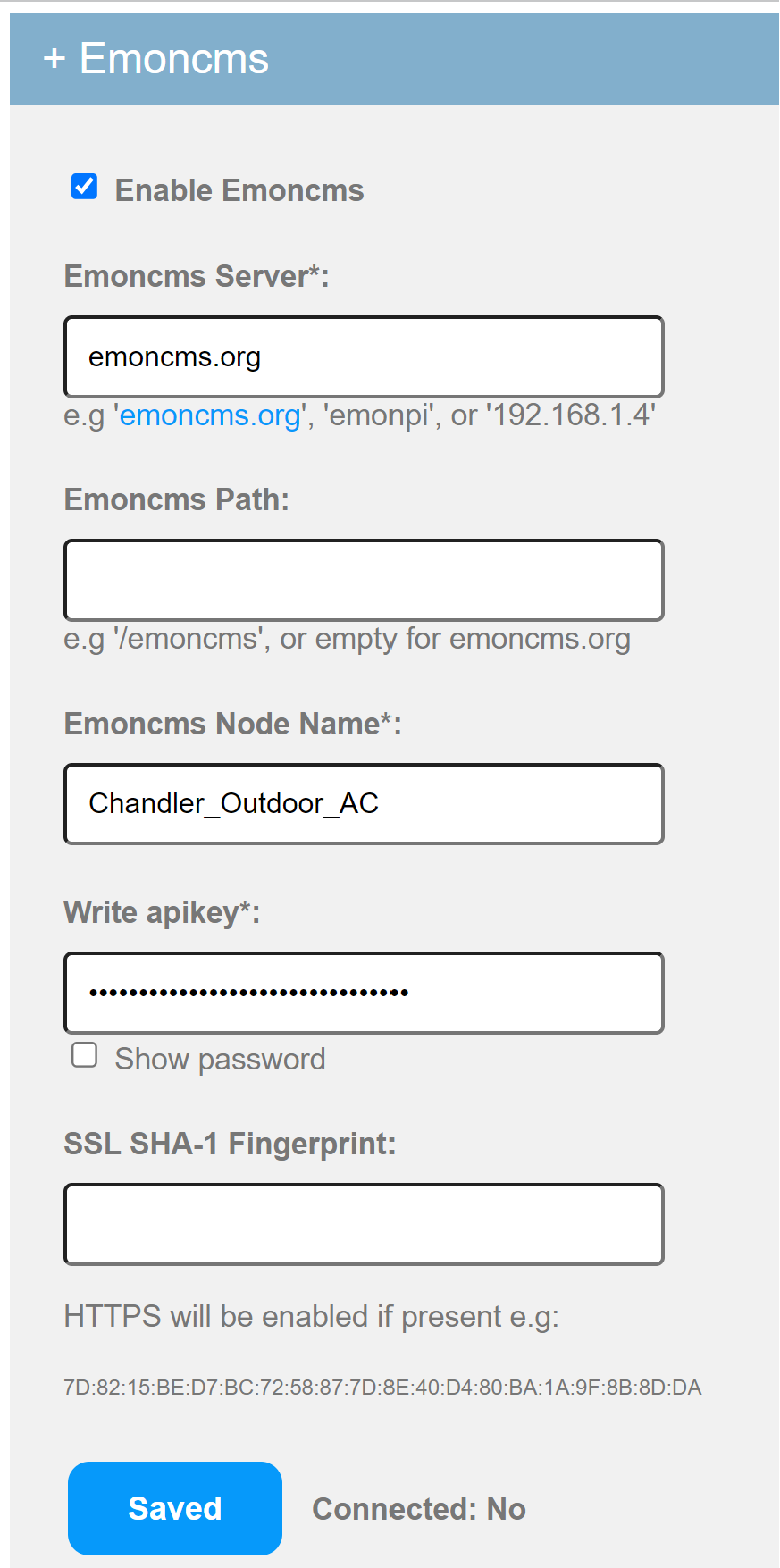

Hi, I have set up 2 emonTX4s, both connected to wifi with good signal strength and both are accessible via their assigned IP addresses and I do see data. However, when I’m in emonESP and enter the info on the emonCMS section, it never shows as connected. I have copied the read & write API key a couple of times to make sure there were no entry mistakes and even generated a new API key to try that. Still not connecting. Inputs do not show up in emonCMS as a result.
Note - I did not enter username and password in the Admin section of emonESP as I assumed this is for accessing the emonTX4, not emonCMS.
Any suggestions as to what to do next?

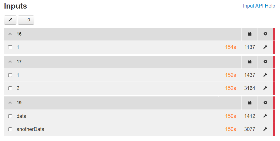

I haven’t had a lot of experience with the ESP8266, so I’ve run out of ideas. Have you sent anything to your emonCMS? What about one of the example data blocks in Input API Help? - easiest is the one with your APIKey already in it, just copy it into the address line of a new web browser page and send it. If not, we’ll have to get Trystan to check his end.
Ok – I was able to send the example data block to my emonCMS and that seemed to work.
I sent this string emoncms.org/input/bulk?data=[[0,16,1137],[2,17,1437,3164],[4,19,{“data”:1412},{“anotherData”:3077}]]
And was able to see the following on my Inputs page.
So it looks to be a problem either with the sketch not sending any data or not in the expected format on the serial interface to the ESP8266, or it’s the ESP8266 not sending it on. I think we need @TrystanLea again.

However, in emonESP, on the emoncms tab it still shows as not connected
I am stuck and can’t figure out why my emonTX4 is not connecting to the emonCMS cloud server. Do I need to have an emonBase between the emonTX4 and the emonCMS cloud-based server? I had understood that the emonTX4 with wifi could communicate directly with the emonCMS cloud-based server (which is what I am trying to do).

Might also be worth setting node name to something short e.g outdoorAC and checking that there are no added spaces on the write apikey.
Another thing to try is a full factory reset of the EmonESP.
Well, using a shorter name did it! I originally had the name set to Chandler Attic HVAC and just changed it to AtticHVAC. Clicked save and then it connected.
So, was it the space in the name or the character length that caused the ESP to not connect?

Great to hear, it’s probably the spaces, but not 100%
I just did some testing and the emonCMS Node Name is limited to 15 characters and it does NOT allow spaces. It does accept underscore_ and hyphen- in the name. I’m not sure about any other special characters.
