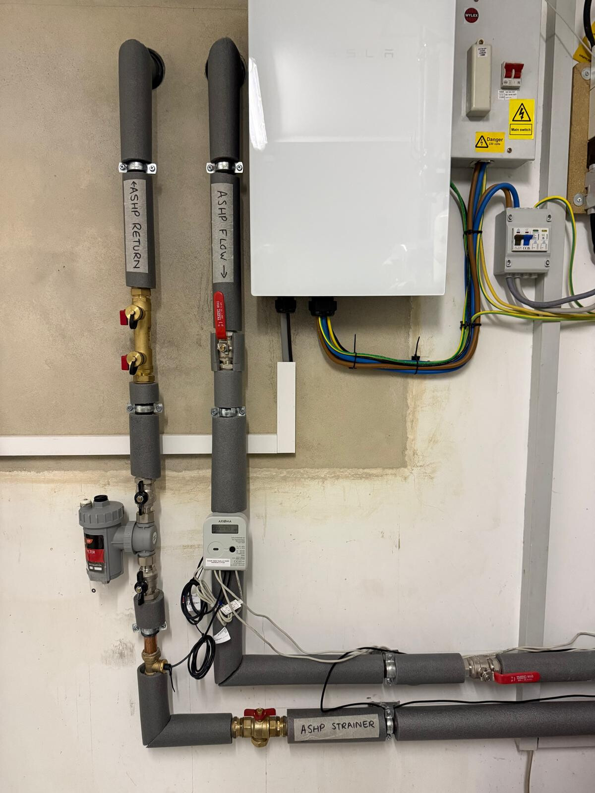

I had my 10k Vaillant Aerotherm+ system installed 3 months ago and then retro-actively fitted the Level 3 Heatpump monitoring bundle myself. I like you, didn’t know if I needed the Level 3 Heatpump monitoring system at the time of install so I didn’t add it to the initial install. That said I did think I’d install it later. In hindsight I wish I’d asked my installer to do a few minor things that would have made a future install a lot easier. Looking back it would not have added more than £50-£100 to the install but it would have saved me some hassle later.
I would recommend the following,
  1. At the start of the flow, get two isolation valves fitted with 0.5m of pipe between them. This is where the heatmeter (the flow temp sensor is inside the meter) will likely go, just make sure it’s inline with the instructions of where to put the Heatmeter
  2. At the end of the return, get two isolation valves above and below where the temperature sensor will go with a min 0.3m of pipe between the valves. This is where the Return Temp Sensor will go. Another option … as the Strainer and the Magnetic filter are often at the end of the return, get the installer to leave a min 0.3m of pipe between them, you can then use the isolator valves on these devices to install the return temp sensor between them.
  3. When the installer is putting an Electric Meter onto you heatpump elec supply in your consumer unit, get them to put the same one you’d get from the Heatpump Monitoring Bundle aka a Modbus SDM120 electricity meter. It will be slightly more expensive as its MID certified.
I have a Vaillant so I only have an outside unit, other ASHPs also have inside units so your flow pipes may be different setup to what you see in my pics
My installer only fitted the top cut off valve on the flow, so when I fitted the heat meter below it I had a long run of pipe without a cut off valve. It wasn’t the end of the world, I just had a lot of water to mange when I cut the pipe. To future proof things, I added another cut off valve just to the right. I was lucky on the return as I was able to add the return temp sensor between the strainer cut off and magnetic filter cut off.
I’d say those extras might cost you up to £100 more but then you’ve really future proofed your install should you want to put the Heatpump Monitoring Bundle in later on
