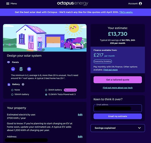

You could try here. Stick your post code in and you will get a ballpark estimate.
