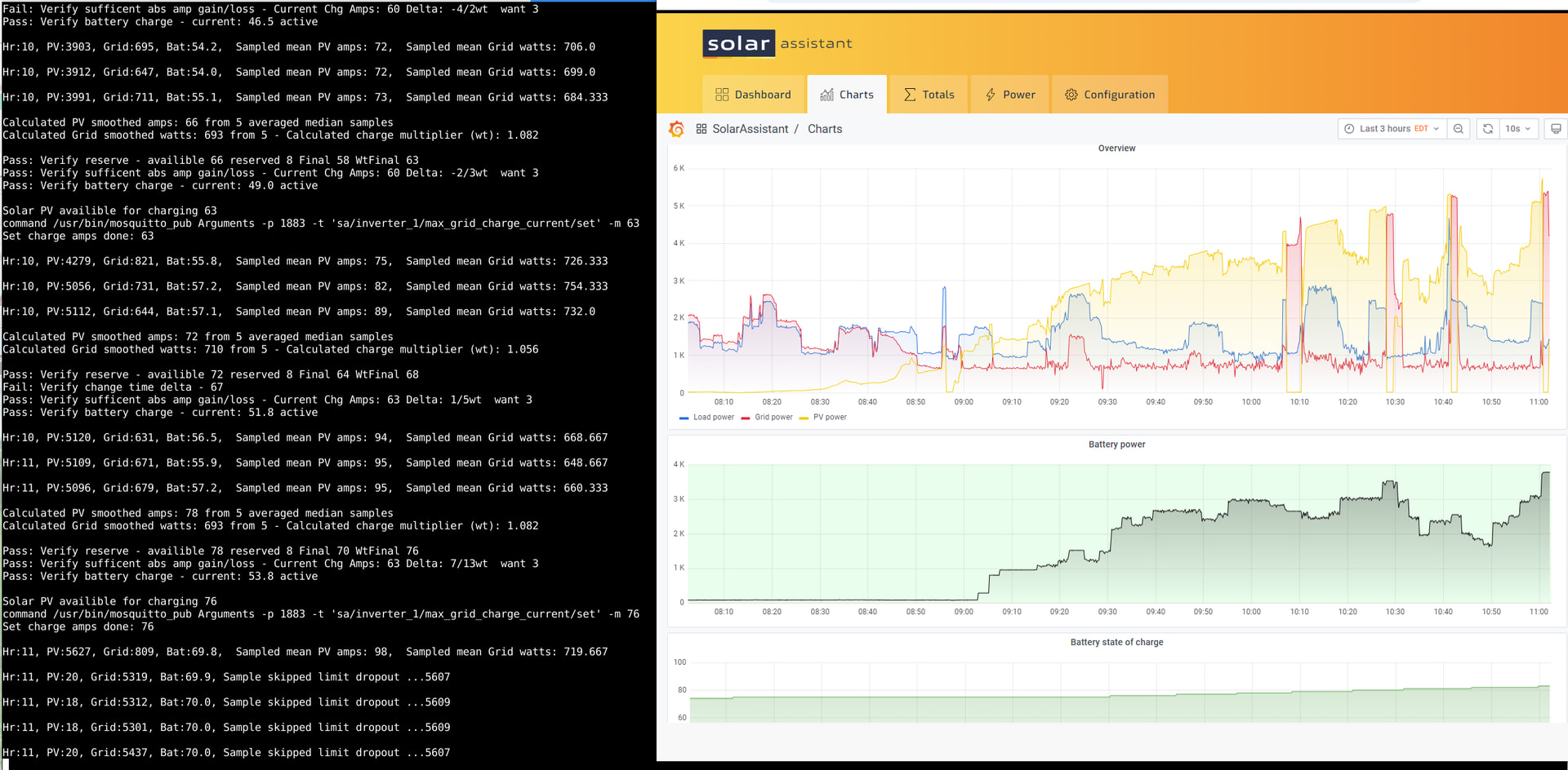

Since I already have a 1500 gal heat reservoir tank up and running is seems like a great place for a dump load. That said - the primary goal was to create a consistent load for the PV inverters. I have a zero export setup. My pole barn has 4 strings of 12 = 4500w x 4 = 18Kw 2 Fronius inverters master/slave each manage 2 strings. I use the Dynamic output feature of these to set 0 watts hard limit, -185 watts soft ( always using 185 watts from utility ) . So Smartmeter 1 sec polls and ~ 2sec response. These are AC coupled to a Sol-Ark 15K with 4x16Kwh LiFePO4 banks at the house basement about 250ft from barn.
This creates from 2 - 12 hard PV shutdowns during a day charge cycle as loads drop and the PV sends the grid close to 0 or past 0 for brief moments. My design was to “catch” the instant drops and open the dump load relay and switch the load difference to the dump load making the net utility use smooth and the PV production also smooth. Then slowly decay the dump load back to zero.
In addition to this when the batteries are full I would quite happily let it heat the tank. 1500 gal is around a million BTU’s of energy usable so replacing the grid as the “buffer” plus some extra heat. Replacing the grid as a buffer is a strong point in my plan to make the utility entirely optional.
Today it is very close but having this capability would let me keep the PV inverters running without a hiccup by replacing the smartmeter with my own smarter meter… The Sol-Ark runs everything or passes thru the PV but keeps the AC coupled segment “alive - in sync” all the time but the meter state will drop PV production. This brings me to full off-grid capable.
Here is a sample of the drops ( and my custom charge controller dealing with them ) the red/grid spikes backfilling the PV during charging when a blue/load drop triggered the limit stop
ps. The charge controller does a good job of following a smoothed out PV production and sending all available excess to the batteries during the charge window. When grid watts go up charging backs down. I altered the code to let the grid pick up the short drops - more efficient than ramping down as the sun is present a large load drop was the root cause.
