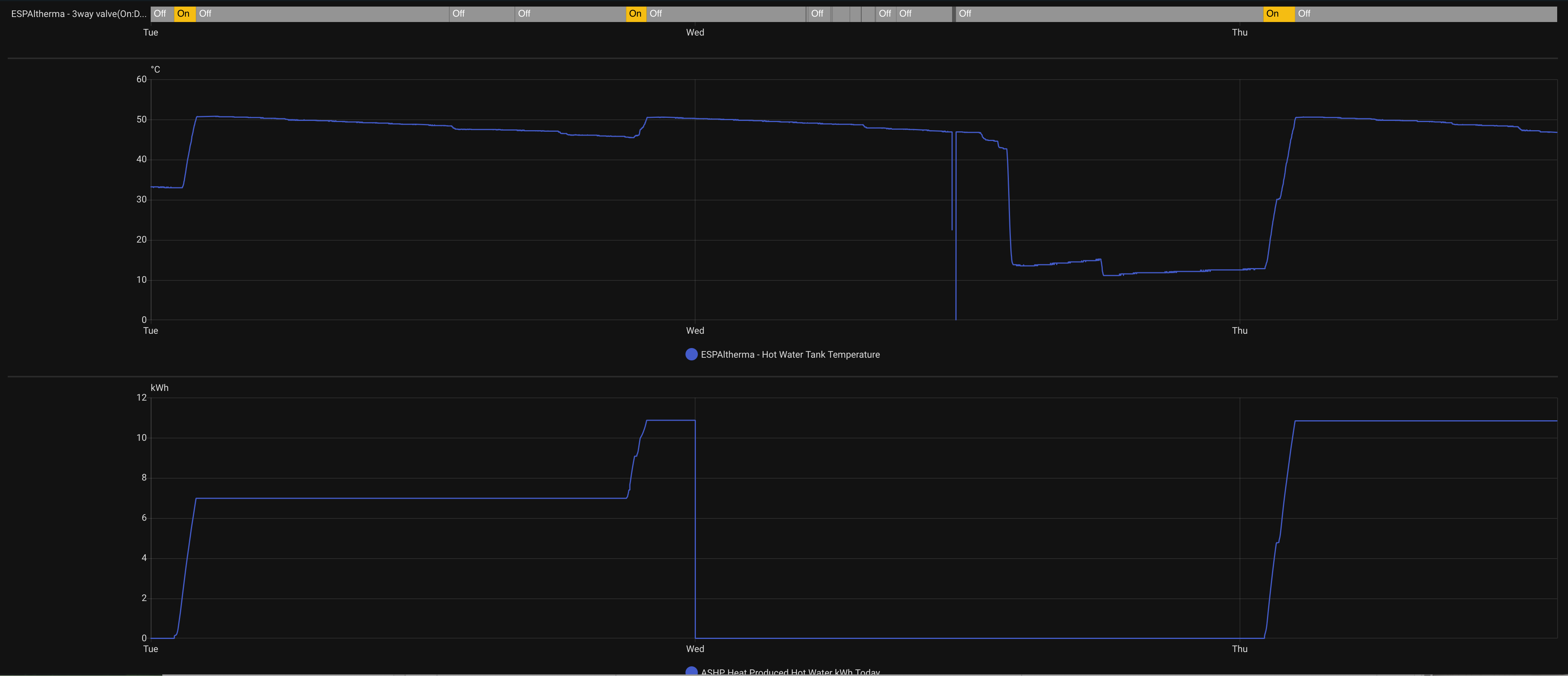

Below is the last 3 days. Schedule heats the tank at 1am for as long as it takes, no reheat.
Starting on the left, Tuesday morning, the tank was 33ish, just under an hour to bring it back to 50c and 7kWh of produced heat.
As it was mild, and space heating wasn’t running, I manually ran a hot water cycle that same evening. Another just shy of an hour run and around 5kWh of heat produced.
The next day, Wednesday, the hot water seemed to run out earlier than usual.
Thursday morning a full reheat from cold to 50c, about 90 minutes and 11kWh produced heat.
We’ve had three showers today and you can just make out their blips in the line for Thursday. Barely any impact on tank temperature.
Yesterday it was three showers as well, but there just didn’t seem the same amount of hot water to go around.

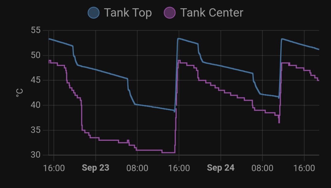

This is how top and center/lower third sensors compare for me. A reheat is triggered by the center sensor. You can see how the difference between them is not just a constant offset it changes rapidly with how much water is drawn. It’s totally reasonable to get a hot bath out of a freshly heated tank at target 33°C, as the top might comfortably sit at 40+°C.

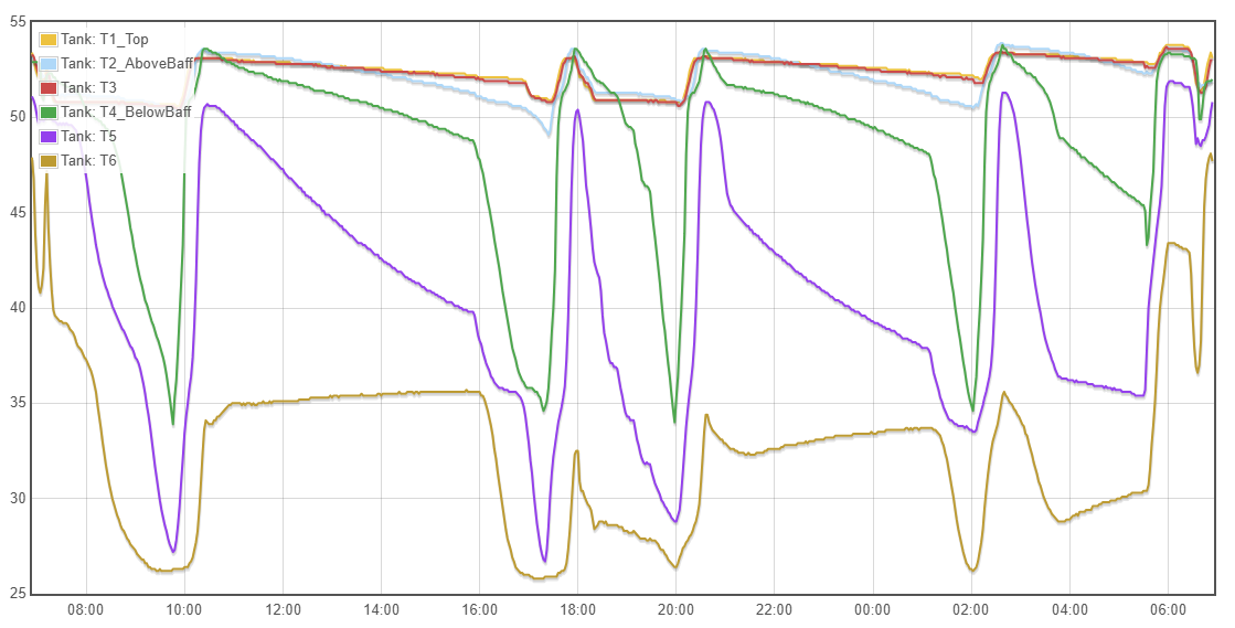

I’ve got a few pockets…
The dips are as DHW is drawn or as the UFH is running.

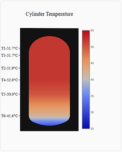

I played with trying to get a heat map in Home Assistant. I got this
[edit]
This is a boiler fed system. I control how hot the tank gets depending on time of day (with HA). For showers in the morning I’ll run the boiler longer to fill the tank more. When the UFH is running, if it needs a top up it does so, but fills the tank less.
The UFH is blended at the tank so it draws off from various points on the tank to get a 35°C feed (which is then blended again at the UFH manifold)
