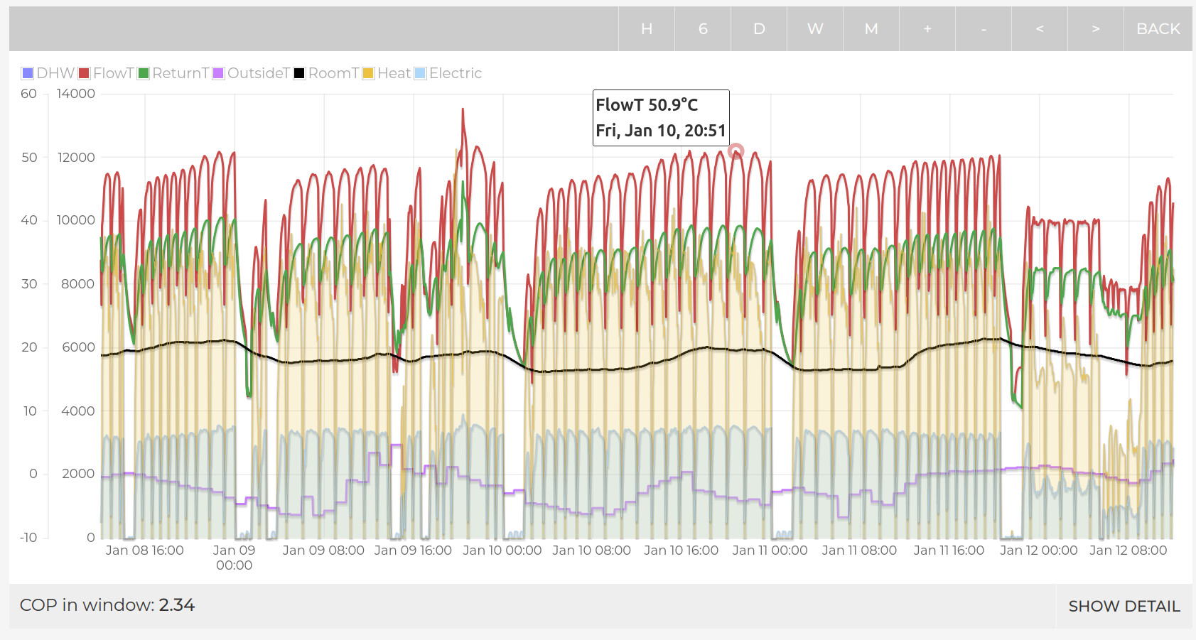

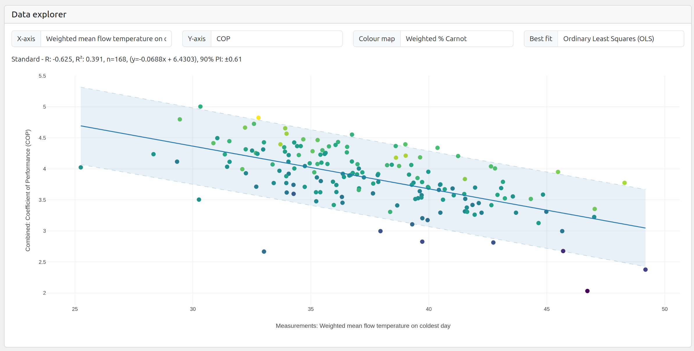

1) Weighted average flow temperatures on the coldest day vs SPF:
At a high level we could look at the following chart that plots weighted average flow temperature on the coldest day vs SPF: https://heatpumpmonitor.org/?chart=1&filter=query:cooling_heat_kwh:1:lte:t,hp_type:Air:eq:t,boundary:H4:eq:t&period=custom&selected_xaxis=measured_mean_flow_temp_coldest_day
First we can see we don’t actually have any systems that run at a weighted average flow temperature of 55C on the coldest day (weighted average meaning that most heat is delivered at that flow temperature), the highest we actually have is system 444 in London with a weighted average flow temperature of 49C and a SPF of 2.4. System 170 in Devon meanwhile has a weighted average flow temp of 48C and achieves an SPF of 3.8, highlighting how wide the range of performance can be!
The central line of best fit gives the following equation:
SPF = -0.0688 x Weighted average flow temp + 6.4303 +- 0.61
We would therefore expect the average system that actually delivers most of it’s heat at 55C in practice on the coldest days to achieve:
-0.0688 × 55 + 6.4303 = 2.6 +- 0.6
The higher end 90% PI performance systems at 55C might achieve around SPF 3.2 and the lower end 2.0.

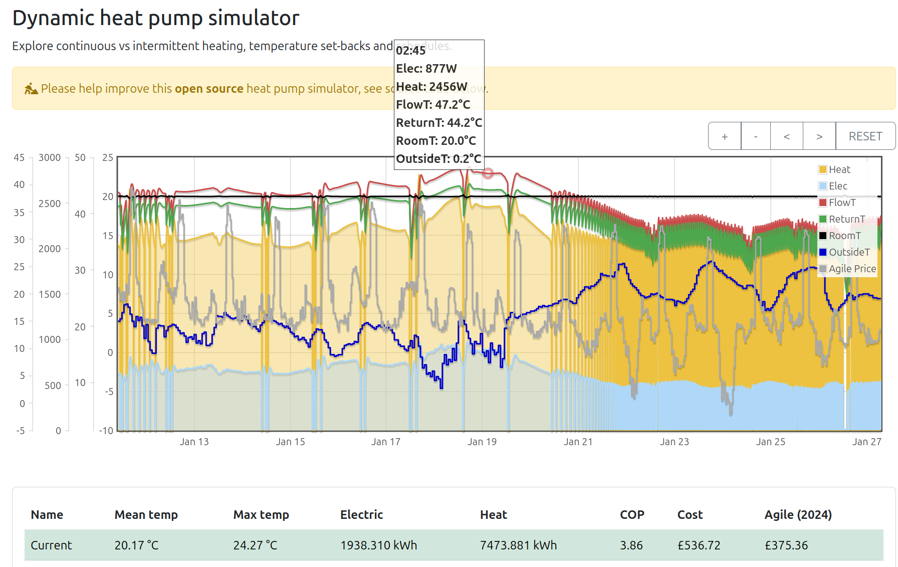

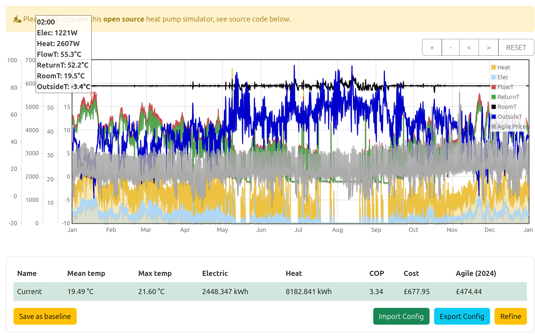

2) Simulated results using our Dynamic Heat Pump Simulator
I’ve been slowly improving our dynamic heat pump simulator over the last year, the latest versions includes the ability to simulate space heating performance over a full year and interpolated COP model based on the detailed Vaillant datasheets. Here’s an example run with a 5 kW vaillant continuously heating a house to 19.5C, running at near 55C on the coldest day achieving an SPF of 3.34 over the year (space heating only). This is without modelling defrosts and so I would expect perhaps a further 0.1-0.2 reduction in COP in reality which could bring us to a result that might be quite close to the top 90% PI of the HeatpumpMonitor data above. Note that this is space heating only, I would again expect a reduction in the combined SPF once DHW demand is included - unless of course a well optimised heat pump cylinder is added to a high temperature emitter system - perhaps not that unlikely?
The Ecodan COP model suggests 3.44 is possible, the simple carnot with variable offsets 3.53. Interestingly if you double the heat loss, switch to a 12 kW Vaillant COP model with it’s higher datasheet performance and adjust the emitters accordingly to again target 55C the simulated performance rises to 4.2 on space heating! The on paper performance for the 12 kW Vaillant really is a class above!

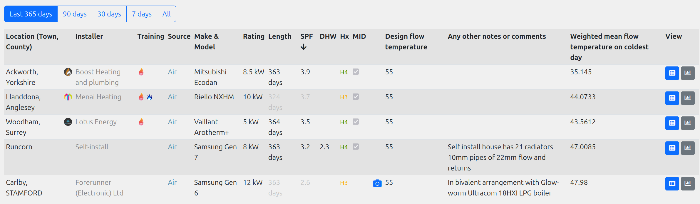

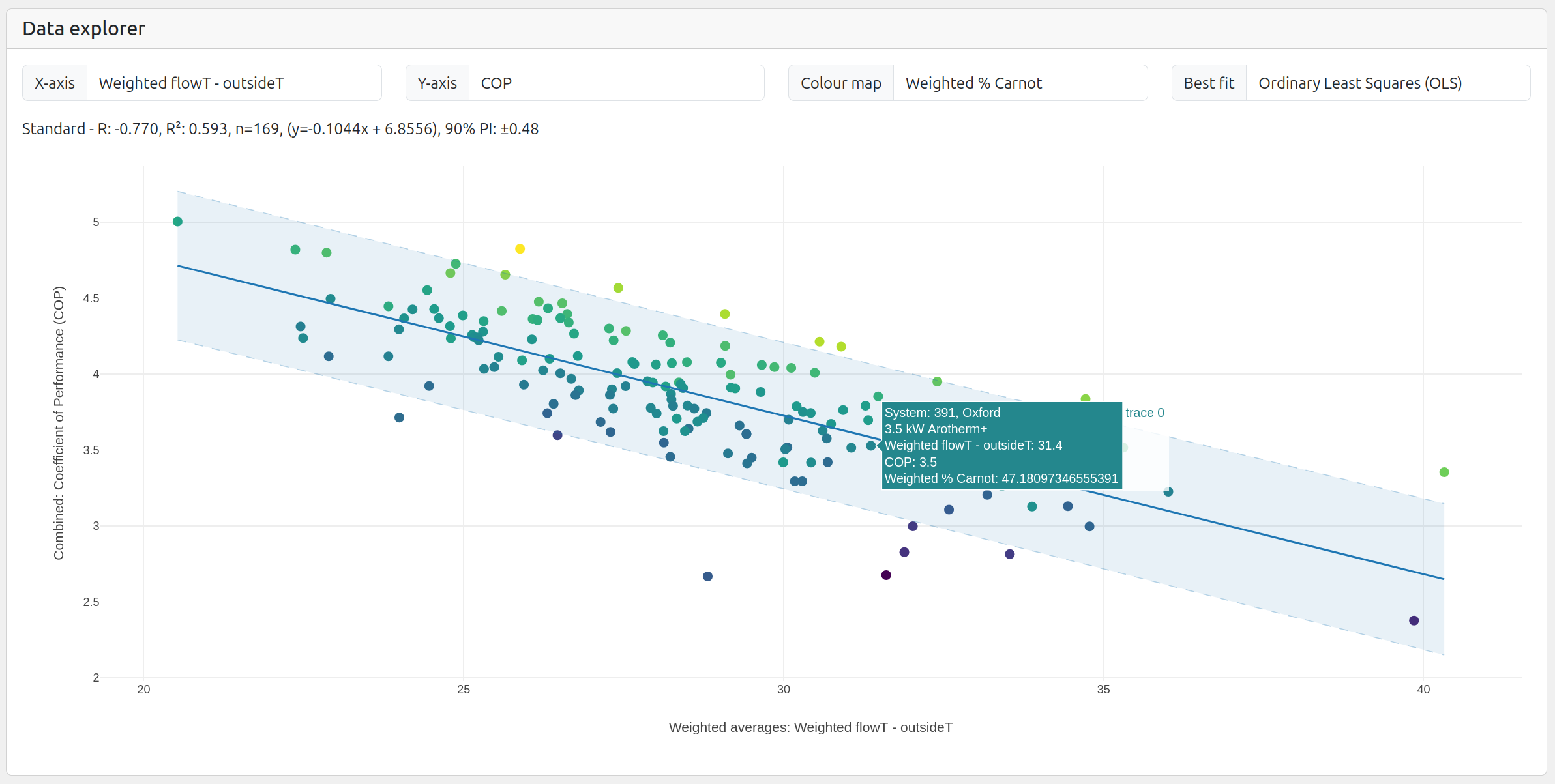

There are 5 systems with design temperatures listed at 55C, these all run at lower weighted average flow temperatures on the coldest day which could result from a combination of factors: gains, dynamic effects and perhaps higher actual outside design temperature as explored above alongside other heat loss over-sizing (air change rates, U-values).
https://heatpumpmonitor.org/?add=flow_temp,notes,measured_mean_flow_temp_coldest_day&other=1&hpint=1&filter=query:flow_temp:55:eq:t&minDays=250
Carbly, Stamford is a hybrid and seems to switch to gas on the coldest days.
The Samsung Gen 7 in Runcorn, system 266 seems to be at max capacity during the coldest days, though the setback does mean it has to work a bit harder that it otherwise might need. It hits 51C max flow temperature. It looks like this system is space heating only as well, it’s SPF 3.2 matches the central figure calculated using (-0.0688 × 47 + 6.4303 = 3.2 ± 0.6).
The higher performing systems have lower weighted average flow temperatures and a quick glance through them suggest that these are either examples of oversized heat loss or perhaps just entering the wrong design temperature on the HeatpumpMonitor form?

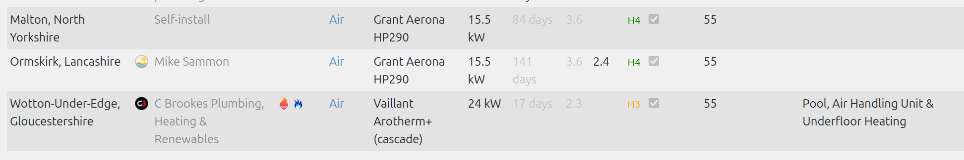

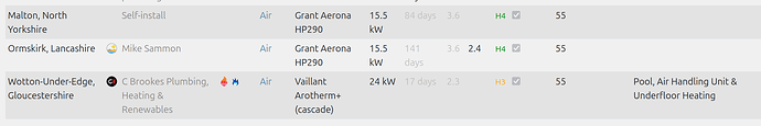

The Malton, North Yorkshire system 828 HeatpumpMonitor.org looks like an interesting one to watch, with COP 3.6 so far. One one of the coldest days so far it hit 51C max flow temp and again around 47C average flow temp. Looks like space heating only.
The Ormskirk, Lancashire, system 763 HeatpumpMonitor.org system has only needed to run to a max of 43.6C on space heating on the coldest days, average more like 40C - but this one has a DHW demand at relatively high temperatures.

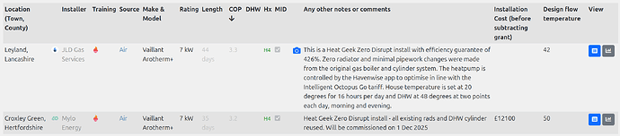

The two public HeatGeek Zero Disrupt systems on HeatpumpMonitor so far have a COP of 3.2 and 3.3 but only over 35 & 44 days: https://heatpumpmonitor.org/?filter=zero+disrupt&period=all&minDays=0&other=1&add=notes,installation_Cost
These have design flow temperatures of 42 and 50C respectively. Both are running average flow temperatures on the coldest days below that.
Leyland, Lancashire, has heat meter air errors so is reporting a COP that’s a bit lower than in reality, I think it would be getting around 3.5 without the heat meter issue.

2) Simulated results part 1: Space heating only using vaillant arotherm 5kW COP model with most heat delivered at 50C on the coldest days suggests SPF ~3.6 (space heating only, not taking into account defrosts, perhaps with defrosts 3.4-3.5). The 12 kW vaillant COP model and 2x heat loss etc, suggests a simulated potential of 4.4 (Im a bit skeptical TBH but it’s interesting that the datasheet suggests such high performance).
3) Simulated results part 2: 50C steady state at -1.1C vs dynamic and gains (see above).
  • 3.4 kW accurate heat loss, 0.33 kW internal gains = 3.07 kW actual heat demand, actual flow temperature requirement after including gains of 47.4C.
  • Simulated using the dynamic model with thermal mass results in actual average flow temperatures on the coldest days of ~45.6C and a SPF of 3.9, blocking off 2x 1hour periods for DHW increases this to 46C, vaillant 5kW model not including defrosts, space heating only!. Perhaps closer to SPF 3.7/3.8 in reality for space heating only

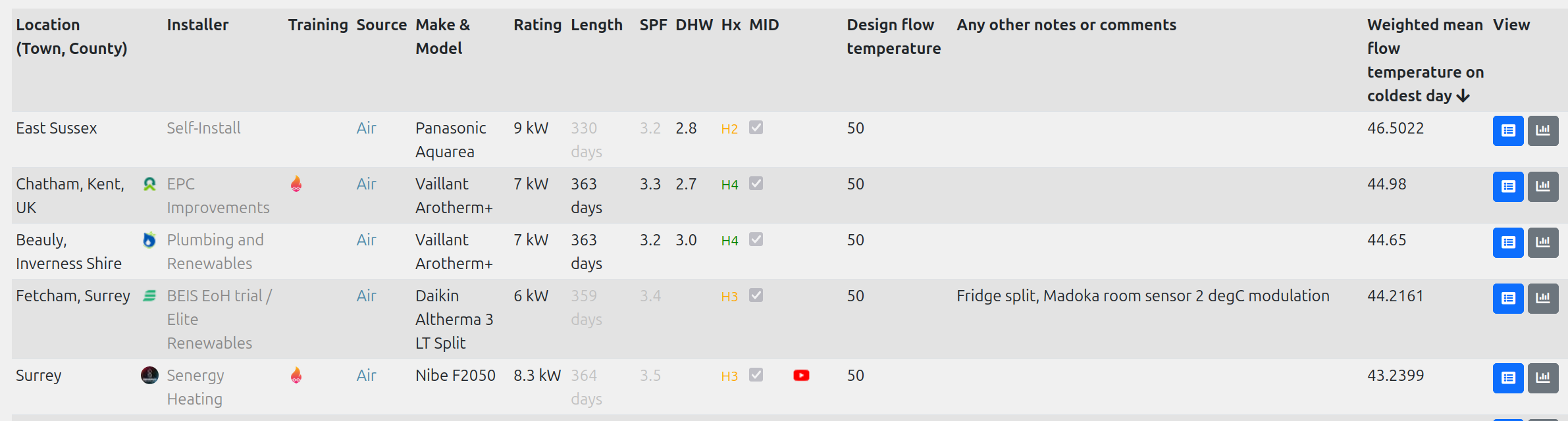

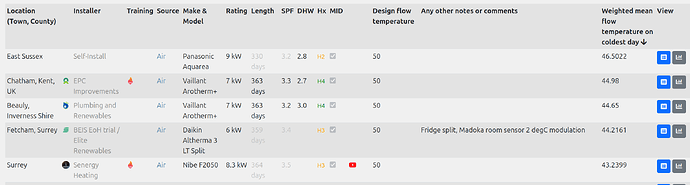

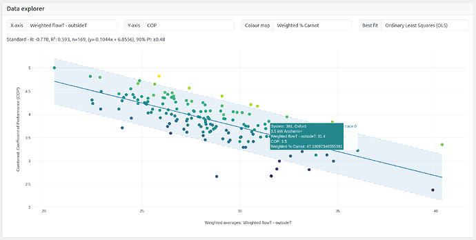

5) Actual systems on HeatpumpMonitor.org with a design temperature of 50C:
27 systems with MID metering, average SPF of 3.5 (range 2.7 to 4.5). There will be a large mix here of systems with oversized heat loss calcs, there are some systems that are running average flow temperatures in the low 30s on the coldest days.
https://heatpumpmonitor.org/?add=flow_temp,notes,measured_mean_flow_temp_coldest_day&filter=query:flow_temp:50:eq:t&minDays=250
Looking at the top 5 highest weighted average flow temperatures on the coldest days we see SPF’s of 3.2, 3.3, 3.2, 3.4 & 3.5
These results suggest that the top end of well installed and optimised systems that are designed to run at 50C should be able to hit 340%. This may be possible even with an accurate heat loss if cold snaps are short enough or there is substantial internal gains. If the heat loss calculation has a bit of a margin on it, it should be easier to hit 340% after optimising weather comp. This will be easier on systems with a lot of space heating demand (less time spent on standby) and a lot depends on DHW performance and DHW % of demand of course.
I’m thinking more about the simulation results that suggest e.g 44C actual average running temperatures from a 50C design flow temp and I’m wondering if it’s overstating how much lower the flow temperature could be, the simulator really needs to include defrosts and hot water demand, both should result in higher space heating flow temperature requirements as the system has to recover from the energy lost to defrosts and the time away from space heating spent when doing a hot water cycle..
Perhaps the jury is still out on how much of the difference between weighted average flow temperatures on the coldest days and design flow temperatures is down to heat loss calculation oversizing vs these other potential factors..

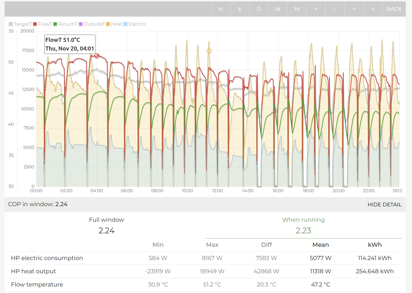

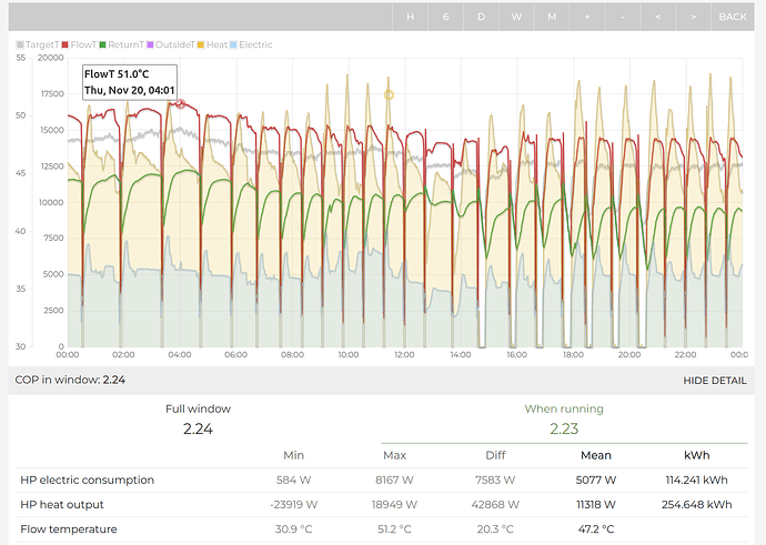

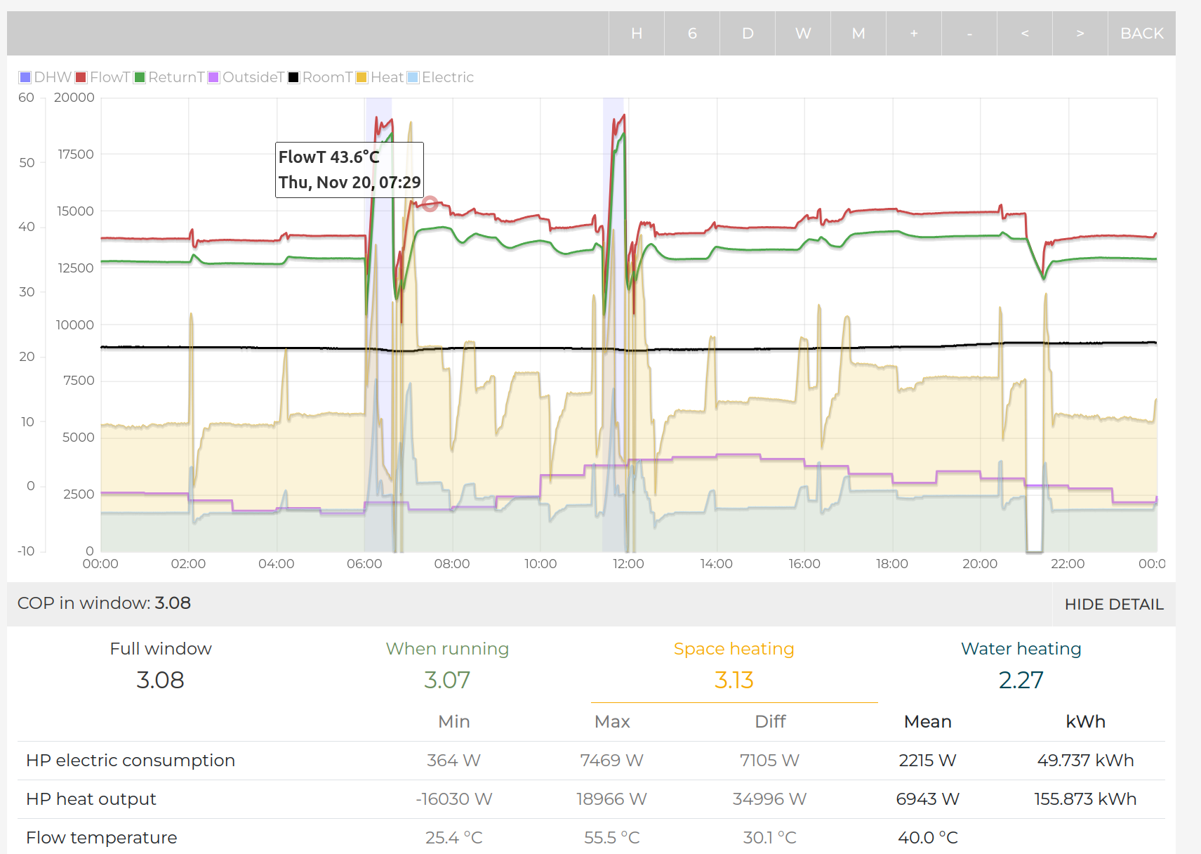

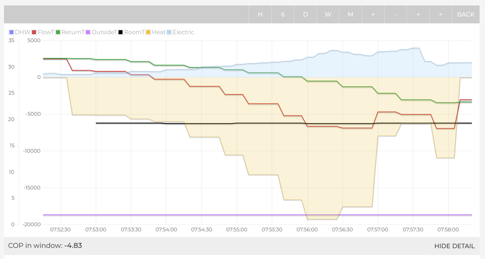

In your simulation of a Vaillant you suggest a defrost impact of 0.1 to 0.2 on CoP. A quick look at recent data shows that my Vaillant aroTherm Plus 12kw defrosting reduces CoP between 0.35 and 0.45. It also reduces heating time by over 10%. Defrosting is a significant effect on heat pump performance here in Highland Perthshire where relative humidity can be very high and temperatures quite low.
Last year when I looked at defrosting more carefully, I found defrosting occurring at temperatures up to 3C when relative humidity was over 91% and electrical demand from the heat pump over 1kw. How would the heating rate needed to achieve heating system flow temperatures of 55C affect the likelyhood of defrosting compared to a flow temperature of 35C?

Thanks @PjH sorry for the slow reply! I meant 0.1-0.2 COP over the full year, while it has a big impact on the days with a lot of defrosting, over the year the effect is less.

Frost formation accelerates dramatically after 0, especially with high relative humidity.
You end up with a frost feedback loop as it insulates - the crucial metric is evaporator surface temperature.
At 2c ambient a 55C system might see something like -8 on the evap, the 35 would see -2 ish… Lots of big high temp systems use hot-gas bypass as its more cost-effective, despite the efficiency penalty.
I see your point that individual defrost events have a much lower impact on annual CoP. However, I understated the individual defrost event impact on CoP by failing to take into account the CoP reduction as the heat exchanger begins to accumulate ice. Quick calculations show this to be a more important effect but I am struggling to work out a simple way to get to an annual effect on CoP. How did you arrive at the 0.1 to 0.2 impact?
