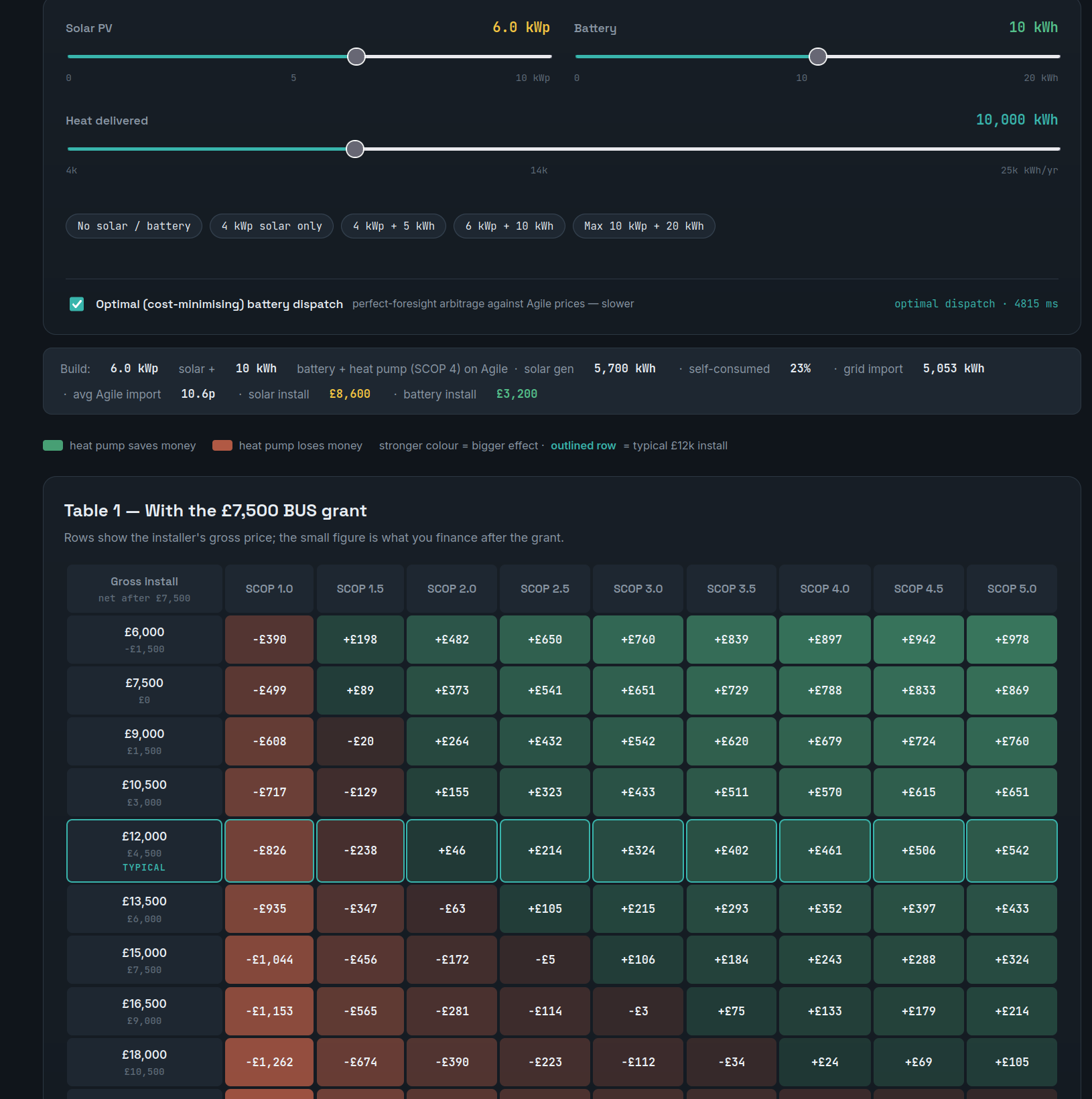

A few refinements to the install cost vs SCOP view:
  • Option to change heat delivered (more heat demand makes savings easier to achieve!)
  • Refined solar and battery pricing based roughly on Octopus solar costing tool.
  • Boiler efficiency at 85%
  • Better contrast on the table numbers so that it’s easier to read.
It really shows the impact of the recent price cap changes with gas at 7.33p/kWh (that should probably be an editable option).
https://openenergymonitor.org/tools/heatpump-cobenefits-live.html
