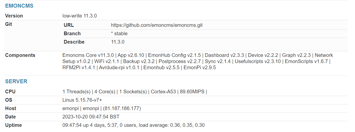

Hi,
We had a couple of short power cuts over night. Now my EmonCMS is not recording any more.
Digging does show that maybe the feeds are not receiving data since the last power cut :

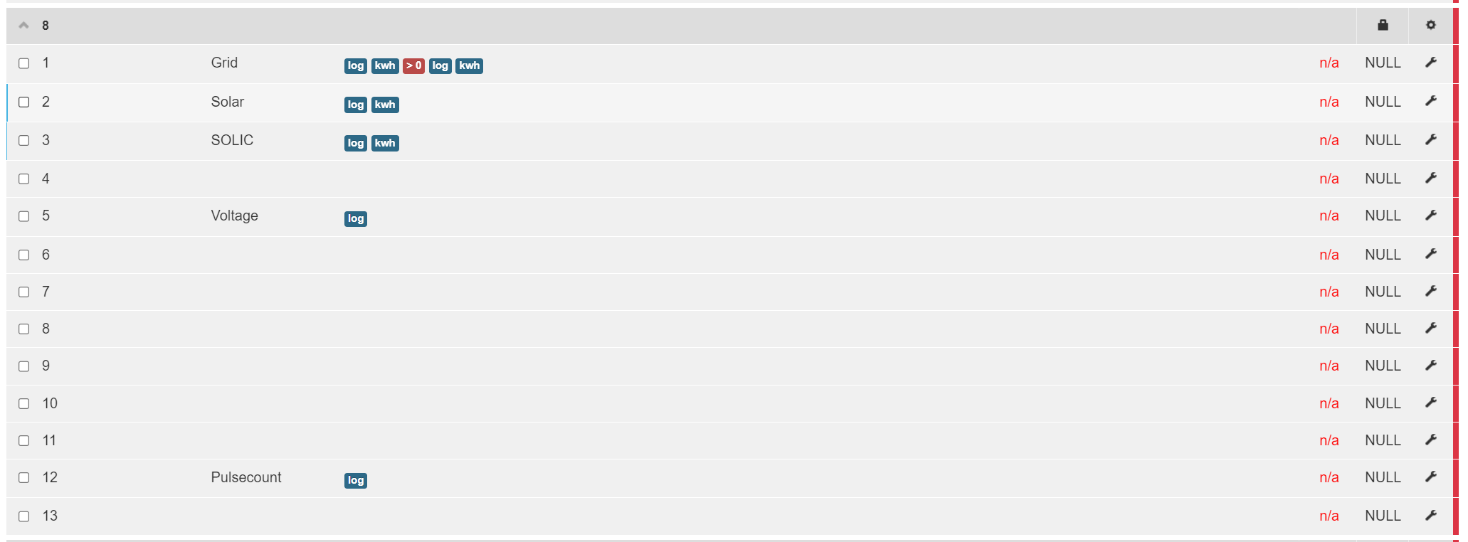

And, indeed, the input I am pretty sure used to work is shown as dead :
But if I scroll alllll the way to the bottom of the inputs :
It is there working OK. It’s almost like it’s renamed itself for no obvious reason?

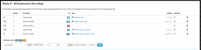

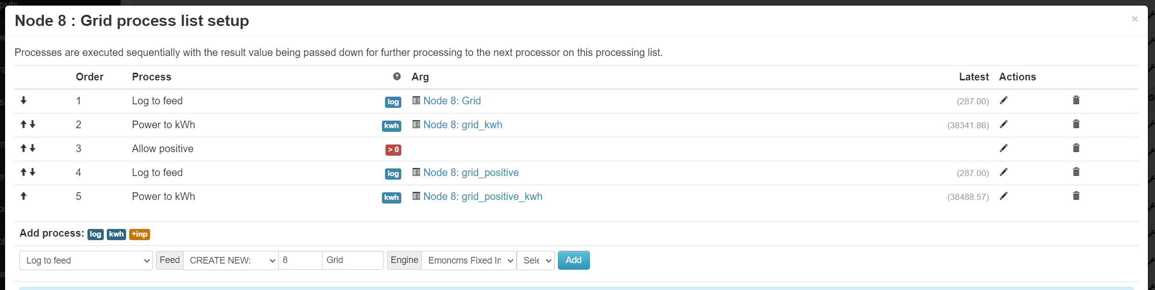

I can find the feed that this new input maps itself to but that does not seem to appear, and also the processing would be wrong that was done in the former setup :
The former looks like this:
Also the actual inputs seem to changed name somehow?
What I cannot seem to find is a way to reassign the old “8” input to what is being called “emontx3_discreet_8”. There just doesn’t seem to be any way to force it back. And I’m fairly confident it would be a mistake to try and copy all the stuff from the old “8” over to the “new” “emontx3_discreet_8”. Plus all my old data would then be broken off and lost.

Ok some progress : I manually copied over all the “8” input entries to the new ones with new names.
And, now, my feeds are updating again.
So that is cool. And a bit of a start, in that my realtime stuff; dashboards etc, are back.
