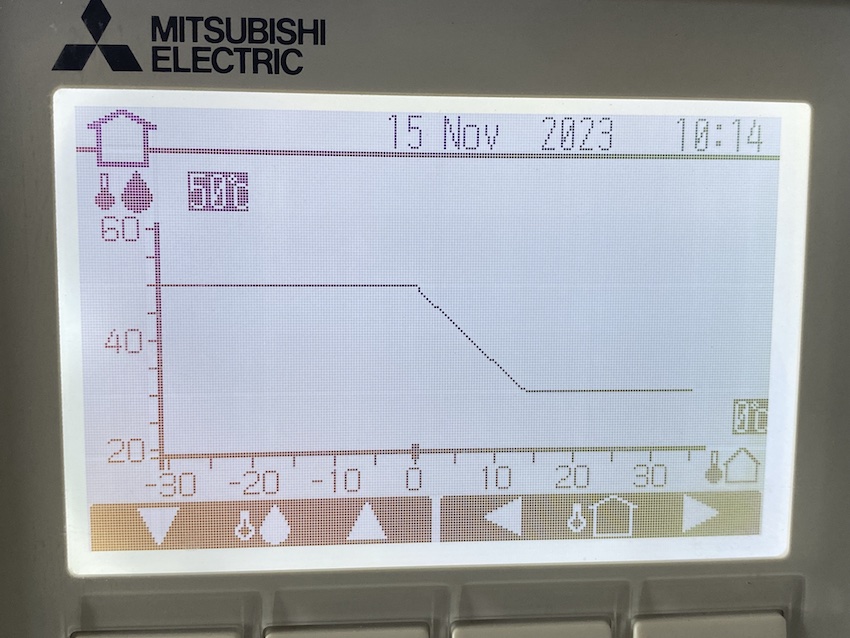

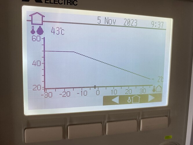

I am trying to set “Weather Compensation”, but settings do not match those on YouTube demos. Upper temperature change not available and lower tremperature change always returns to -30C. See photo.
What am I missing/ getting wrong here?

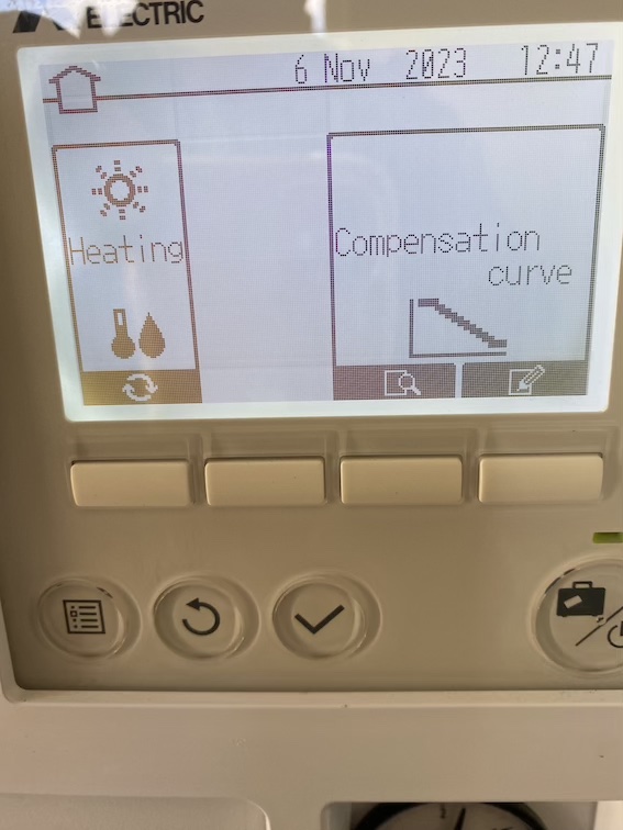

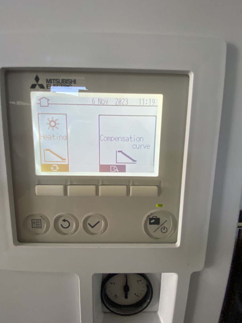

Have you long pressed the menu key?
From the Main Screen, I long press Menu and get ‘DHW’; ‘Home’; ‘Timer’; ‘Holiday’; ‘Initial’; and ‘Service’
I select ‘Home’ and get photo 1 and I select: ‘Compensation’ (Note that whichever I select the Compensation panel appears on the RHS)
As I previously commented, I then have no practical adjustment as photo 2 and Compensation curve reverts to -30C no matter what I do.
Further long or short press of Menu button takes me back to Main Menu
Any comments much appreciated

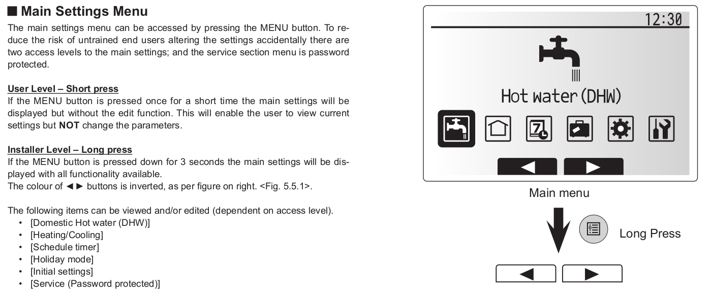

Photo #1 looks like the display you get when you short-press the menu button. The 4th button is the one to edit the curve, yet the pencil symbol is missing. Does it do anything when you press it?
PS: from the manual…
The arrows at the bottom will change from white-on-black to black-on-white
Thank you very much Timbones. You were correct and although “my” long press brought up the second menu it was obviously not long enough to bring up the weather compensation adjustment on the subsequent screen.
Now on the ‘Compensation Curve’ icon I have the ability to view AND to adjust.

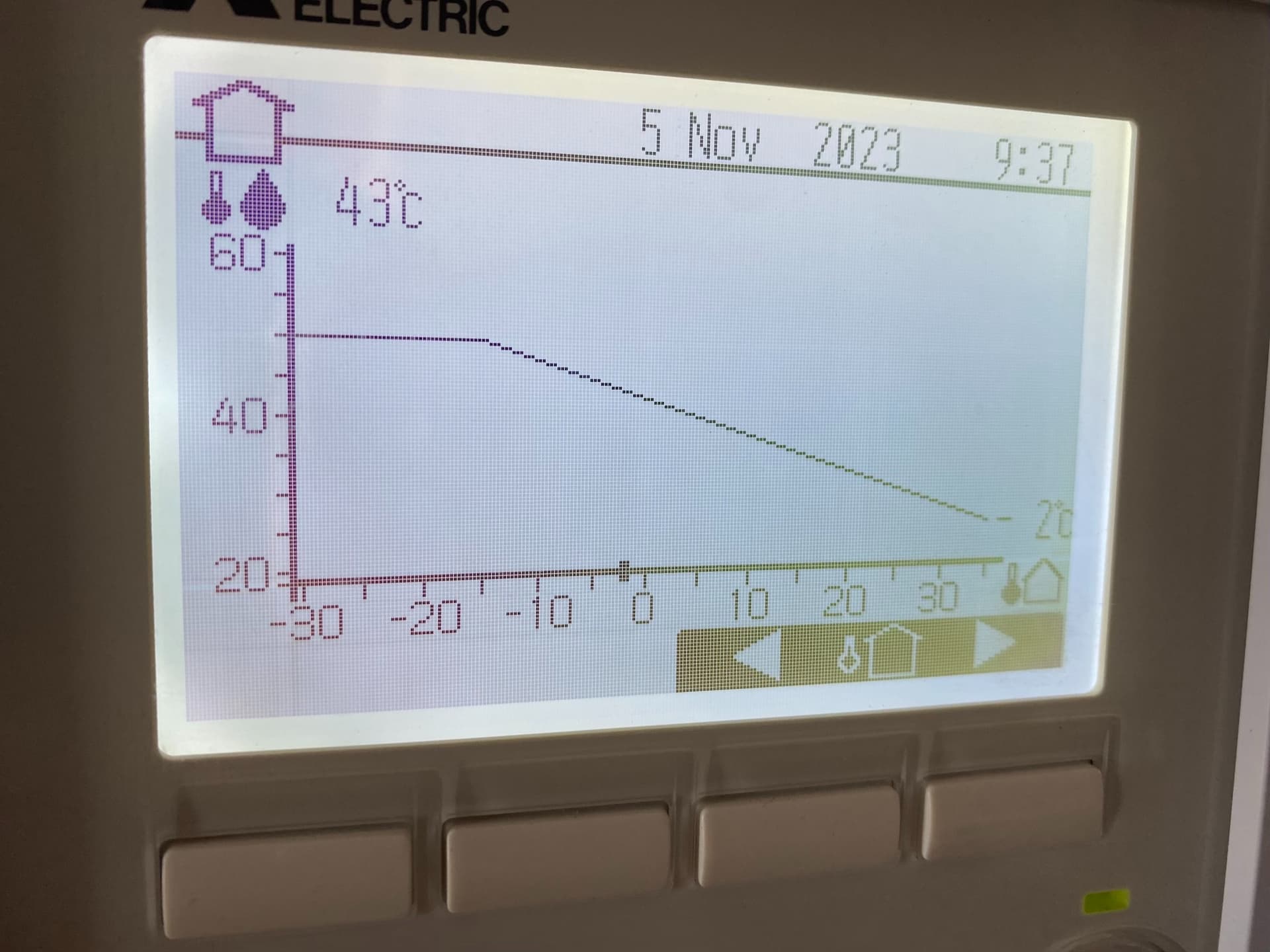

I don’t know the FTC 5, and maybe I misunderstand your question, but to me your photo is saying that at ambient = -15degC or below your target flow temp will be 50degC, at ambient temp = +35degc or above your target flow temp will be 25degC, and between -15 and +35degC your controller will interpolate these target flow temps. So your lower limit is actually -15degC not -30degC.
Hello Sarah and thanks for your contribution.
I wasn’t particularly referring to a temperature of -30C, but just to the numerals to the right hand end of the graph. As I said later, my lowest temperature out here in the Algarve is not likely to reach -5C, so I am going to start with a lowest setting of -2C. I was operating on Target Flow last year at 50C and this coped well even with timed periods off and on. I am looking to have a more continuous running, but will probably start with a max flow temp of 50C. I would be most grateful if you have experience which might suggest starting from a different point.
Depending on the heat loss of the property, size of the heat pump and output from emitters (radiators or underfloor) you might be able to get away with a lower flow when it’s cold, say 45C.
Conversely, you may find the heat pump cycling more often with low flow temperatures in mild weather as the radiators struggle to shed the heat being produced by the heat pump. Increasing the minimum flow temperature can help with this, as well as keeping all the radiator valves as open as possible.

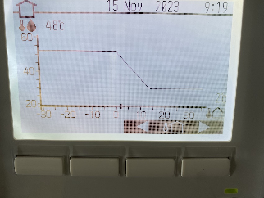

Sorry to show my ignorance again on Weather Compensation.
If I enter the weather compensation 1st screen there are two options with the LHS being presumably for “View” and the RHS for “Edit”
However if you select “View” there is a provision for adjustment of the lower temperature with horizontal arrows.
What is the purpose of this adjustment?
The settings bear no resemblance to those achieved by adjusting the High and Low settings from the “Edit” screen
View does not change any settings, but simply lets you slide along horizontally to see what the flow temperature will be at a given outdoor temperature.
In your first photo, a flow of 48 C when it’s 2 C outdoors.
