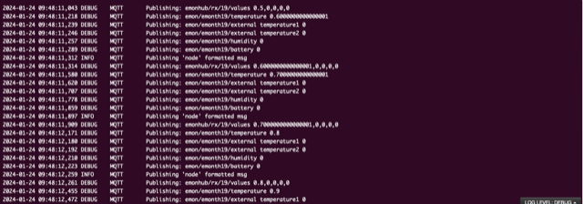

Runs once then falls over. With 0.2 as internal temp zeros everywhere else
No more data transmits. Nothing on serial
Was this with line 126 changed? With the change, you should see some serial output:

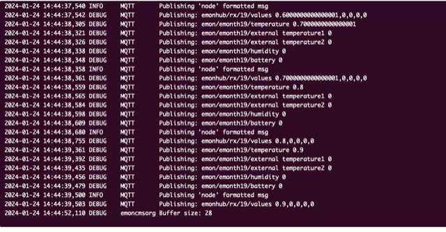

I get this on boot. Then no more. Long red led pulse then red flashing for a sec
Here are my alterations. No doubt something not right

Received in emonhub but then no more
No problem, my mistake converting the logic. (If I’d got my emonTH V1.4 available, I’d have been able to test it thoroughly.) Try this:

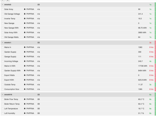

No all is good. I have placed the TH in my loft doing what it should with a 5vdv supply. Another subject which maybe should be another thread.
This am when looking at my inputs there were 100+ phantom inputs from my usb?uart linked TX3. These seemed to have random titles and random values.
I duly deleted them.
As a result all the feed logs and calcs etc were removed from the valid inputs and no data is being logged and processed.
The feeds are still listed in the feed list but any record of where they were or the numerous calculations done with them have disappeared!
Any way of getting back?

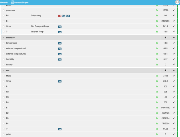

That shouldn’t have happened. Did you really mean you deleted ALL the inputs including the active, correct, wanted ones?
As far as I know, they’re gone for good - however, @TrystanLea might be able to help.
Also, look at Unknown Nodes keep appearing
@TrystanLea This has all the hallmarks of another instance of trouble caused by autoconf
No I only deleted the rubbish inputs. Left all others of course.
The bottom one weirdly named “test” used to have a load of logging and associated calculations as well as 100+ seemingly random inputs. The 2 logs in test were me reinstating the feeds. Which I can do but all the calculation steps have gone.
These are the feeds
The feeds are still listed but the ones that went are not updating.
