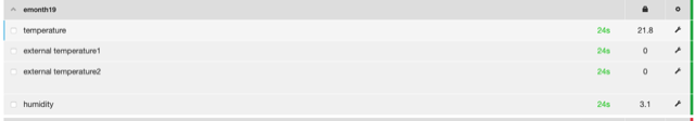

I have updated that but I still have problems. I have removed the internal temp/hum sensor and have 2 external probs connected only and battery power.
Only 1 external probe reporting and battery volts showing as humidity. When I connect the internal sensor it reports humidity as external temp2 and internal temp as external temp1.
Have I messed up?

I didn’t intend you to remove the internal DHT22, and you didn’t say you would. If you don’t want and don’t need it, I’ll take it out of the sketch.
I can’t see why the voltage turns up in the humidity slot though.

I don’t want it out I just took it out to try and work out what was happening.
This is what I get now
Humidity is ext temp 2
Battery is Humidity.
Forgive me I am just trying to understand a bit. Lines 89-95 in sketch? Might explain?
Those lines define the order of the variables sent to emonHub. You have changed your definition of Node 19 in emonHub according to the comment near the top – line 40 onwards?
Yes node 19 changed to include those 5 variables and is as the comment.
Ah I see lines 90-94 do show the 5 I thought only 4 didn’t see top line.

Actually, it’s not as bad as it looks - it’s only one file that’s duplicated: DallasTemperature.cpp.o and DallasTemperature 2.cpp.o
All you need to do is delete the “<space>2” version.
OK I sorted the library thing.Compiled ok but when I tried to send I got
Sketch uses 27514 bytes (85%) of program storage space. Maximum is 32256 bytes.
Global variables use 1064 bytes (51%) of dynamic memory, leaving 984 bytes for local variables. Maximum is 2048 bytes.
avrdude: stk500_recv(): programmer is not responding
avrdude: stk500_getsync() attempt 1 of 10: not in sync: resp=0x00
avrdude: stk500_getsync() attempt 2 of 10: not in sync: resp=0x00
avrdude: stk500_getsync() attempt 3 of 10: not in sync: resp=0x00
avrdude: stk500_getsync() attempt 4 of 10: not in sync: resp=0x00
avrdude: stk500_getsync() attempt 5 of 10: not in sync: resp=0x00
avrdude: stk500_getsync() attempt 6 of 10: not in sync: resp=0x00
avrdude: stk500_getsync() attempt 7 of 10: not in sync: resp=0x00
avrdude: stk500_getsync() attempt 8 of 10: not in sync: resp=0x00
avrdude: stk500_getsync() attempt 9 of 10: not in sync: resp=0x00
avrdude: stk500_getsync() attempt 10 of 10: not in sync: resp=0x00
Failed uploading: uploading error: exit status 1
It’s anybody’s guess what the cause of that is - it could be almost anything. It could be something else is using the USB port, it’s worth checking the programmer is still plugged in to the emonTH, though as you saw serial data before, it’s not likely (but if the emonTH isn’t responding, it would generate that error). Normally for me, it means I’ve forgotten to plug something in. Could it be permissions on the USB port? Look through the Docs again on setting up the Arduino IDE - and the Arduino site might give you some leads.
I am as confused as you are. Probably more so!
I have the emontx3CM sketch that you sent me ages ago. This compiles perfectly.
The EmonTH sketch is in a different directory but in the same place in the tree. It compiled once but will not do so again!
This means it did compile satisfactorily, the problem is the linker-loader avrdude isn’t getting the response it wants - it’s a connection problem. though whether physical or logical is hard to tell. You get the same error message from many possible causes, so it’s not very helpful.
I can get it with the programmer connected to this laptop, but no ATMega on the other end of the programmer.
It wouldn’t be a corroded pin on the FTDI header?
