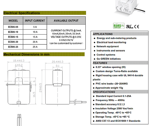

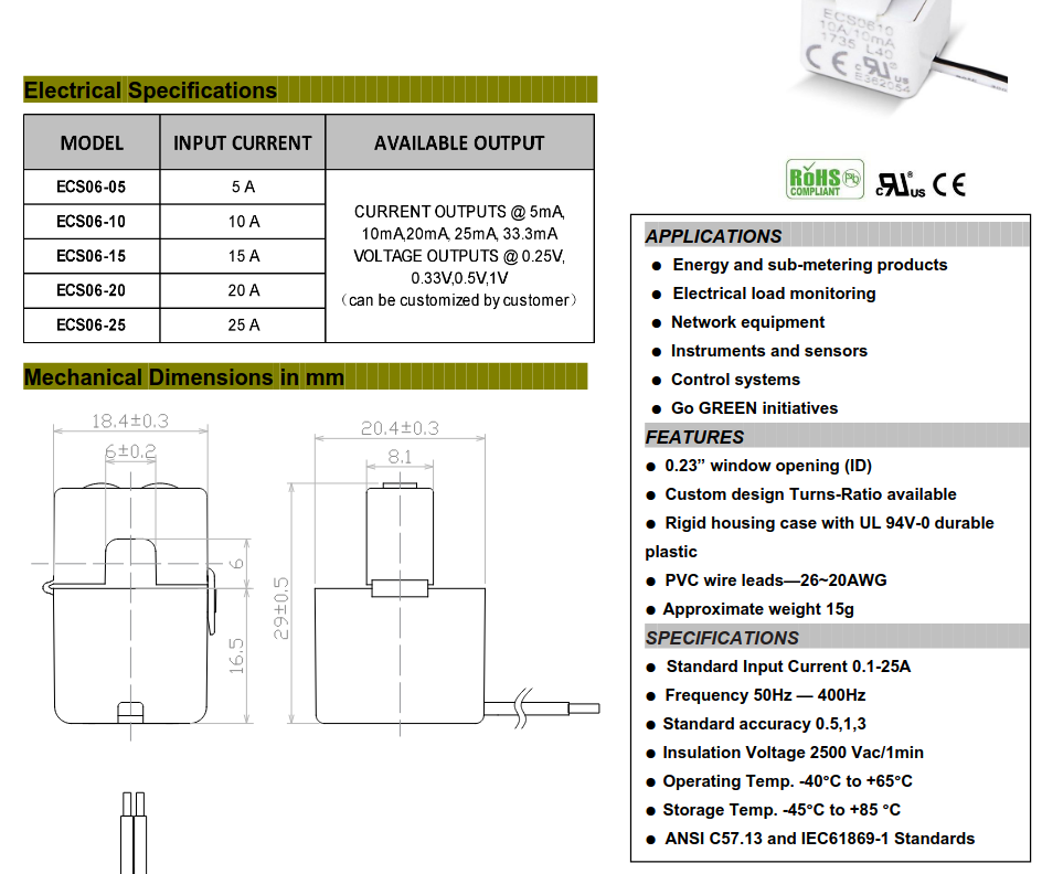

We decided to standardise on 333mV voltage output CT sensors for the new hardware as that’s the more common standard, giving us a wider range of CT sensors to choose from. This isnt so suitable for the emonPi1/Tx3, where you really want ~1.6V peak across the internal burden resistor at max current. See emonTx3 calcs here Technical — OpenEnergyMonitor 0.0.1 documentation
The emonPi1/Tx3 uses YHDC 50mA @ 100A, 2000 turn CT’s.
The ECHUN-ELC CT sensors that we use have a 33.3mA current output version but the datasheet accuracy figures seem to suggest that the accuracy falls to 3% (same as the YHDC) at the wider values, while they are down at 0.5% for 0.33V.
https://www.echun-elc.com/productsShow.asp?id=411
Using the solid core CT sensors that @rupert suggested directly with the emonTx3 would be a better match!
