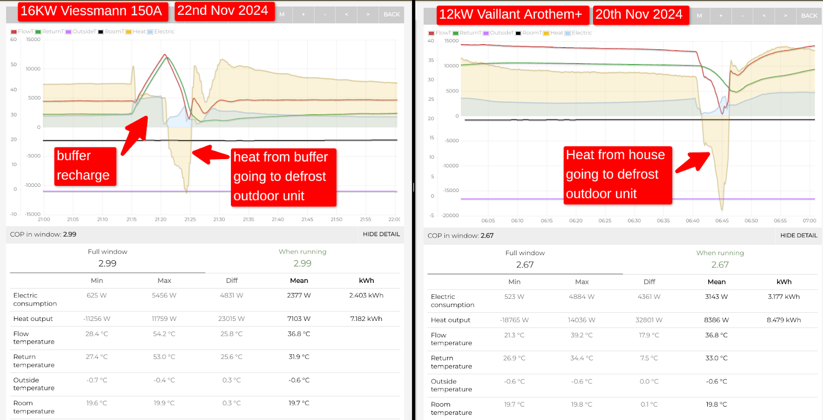

While these two heat pumps have quite similar specs, they both have a very different approach to handle defrost:
  • Viessmann use an internal defrost buffer inside the indoor unit which is heated up prior to defrost to enable the defrost cycle to be completed without drawing much heat from the emitter circuit
  • Vaillant use the standard defrost technique of taking heat energy from the house emitter system to complete a defrost.
Important: Keep in mind when looking at this data, that while these two heat pumps are relatively similar, there will obviously be differences in the heating systems and control settings between the systems which may affect defrost performance. Also, we don’t have a record of the outdoor humidity during defrost.
Here’s a comparison of a defrost cycle under very similar conditions, 0.6C outside, 36C flow temp:
Viessmann Vaillant
Length of defrost cycle - to regain same flow temp 14min 14min
Electrical energy used 0.6kWh 0.14kWh
Heat lost from house 0W (presumed) -0.76kWh
Average COP between defrost 3.86 3.05
Electrical energy required to regain lost heat 0kWh 0.25kWh
Total electrical energy used for defrost 0.6kWh 0.39kW
Average 24Hr cold weather COP (average 3.4C) 4.03 3.35
Viessmann Defrost
The Viessmann method of heating up the internal defrost buffer uses more electricity initially to raise the flow temperature from 35C to 54C to recharge the internal buffer. Delivering a high flow temperature results in low COP for this 5 min buffer recharging period, COP 1.28 in this example. It’s interesting to note that in this example Viessmann does not use the resistive electric booster heater, the buffer is heated up just using the compressor. It would be interesting to know under what criteria does the Viessmann activate the resistive electric booster heater?
Vaillant Defrost
During this defrost example, Vaillant extracted 0.76kWh of heat from the house heating circuit, this resulted in a negative COP of -5 for a short period during defrost. Extracting heat from the heating circuit, resulting in a 16C drop in the flow temperature. Vaillant then needs to work harder to regain the lost heat back into the property. Taking into account having to regain the heat lost, the amount of electrical energy used for the defrost is very similar, 0.6kWh for the Viessmann and 0.4kWh for the Vaillant.
Comparison / Discussion
The main advantage of the Viessmann method is that no heat is lost from the heating circuit and the defrost cycle is not dependent on the heating circuit having enough volume available to provide sufficient energy to defrost e.g if a number of TRVS or zones are switched off the Vaillant may not be able to fully defrost leading to a defrost death spiral and eventual system failure. Although with good open-loop system design and or a volumiser this risk can be mitigated. It’s possible Viessmann may result in a slight improvement in customer comfort, since radiators won’t get colder to the touch during a defrost.
Another thing to note is that the Viessmann system seems to require far fewer defrosts compared to Vaillant system, this could be due to the Viessmann system having a lower heat demand, see ** below.
Conclusion
Both heat pumps are able to defrost in an effective way and both heat pumps average fantastic COP.
Comparing the two systems over a 24hr period with the same outdoor temperature which includes a number of defrost cycles the Viessmann seems to average a higher COP, this higher COP seems to be due to very efficient normal steady state running rather than specifically defrost performance.
This is only a single example, more example comparisons are needed to draw a definitive conclusion
* Vaillant output capacity in colder weather including the effect of defrost has been tested to be lower than the manufacturer’s stated output, see: Vaillant maximum output capacity testing. We don’t have much data on Viessmann maximum output capacity.
** The heatpumpmonitor.org Heat Demand Tool indicates that the actual heat loss of Clunbury, Shropshire is around 7.7kW at -3C and the actual heat loss of Ashstead, Surry is around 12.9kW.

Thank you for the write-up. I have been doing some calculations, comparing the system energy ‘draw’ of various Vaillant units during defrost to verify minimum system volume. Indeed across the unit sizes, the increase seems to be what you expect and in line with manufacturers’ guidelines.
Once I had a system with a Remko (German) Heat pump that would fail if no backup heating was present because it was only underfloor and so efficient that the flow T was so low, when running defrost the system concluded that the flow T got too low. (Low system volume and low flow T, it is not only about volume!)
Looking back, I think the Viessmann is overengineerd. With the Vaillant 5 kW system I am monitoring there is indeed a 50 l volumiser on the return, and the drop in return T during defrost is from 33.4 to 28.8. Yes, 50 l goes a long way, but the rest of the system has little volume (20-30 I guess). Viessmann is also not heating the building during its defrost period. Whatever is lost can be made up quicker than any building thermal mass could ever respond to.
Shame Vaillant don’t have a valve to disconnect the volumiser from the heating circuit when doing a defrost/recovery.
I not convinced Viessmann is always over overengineerd as my understanding is it can often be installed without a separate volumiser when other heatpumps would need one.
Interesting post! A point to note when comparing defrost efficiencies: it’s key to note that the heat meter’s temperature sensors in a given installation may be positioned far enough from the heat pump to alter the apparent deltaT and thus apparent heat output. This is especially true during the preheat step used by Viessmann, because the temperature during this step rises rapidly, causing the water temperature to drop approximately linearly along the length of pipe from the heat pump outflow to its inflow. As a result, in the Clunbury installation, the heat meter underestimates deltaT by a factor of 1.7, i.e. the actual COP during defrost heating is 1.7 x larger than the heat meter’s estimate. Using your analysis, this shifts the advantage quite strongly in favour of Viessmann’s approach.
