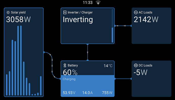

i am currently testing the new allinone board on my victron off grid systems (3x Multiplus 2 5000 / Fronius Symo 20.0 / 16s2p eve lfp 280k cells ). Works great so far!

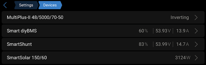

thank you, i have tried it. Unfortunately the controller cannot connect to the allinone board with this version (packets received is always 0)
i have already found the problem… the communication speed in the settings menu had to be set to 10K again. :slight_smile:
Mine is working nicely, limits and stops the charge when it has to.
Just had to choose the diybms as main bms and check all the control options in the cerbo.
Is it possible to connect two diybms controllers to one cerbo? I got a low voltage error when i did it just like if the bms lost connection.
