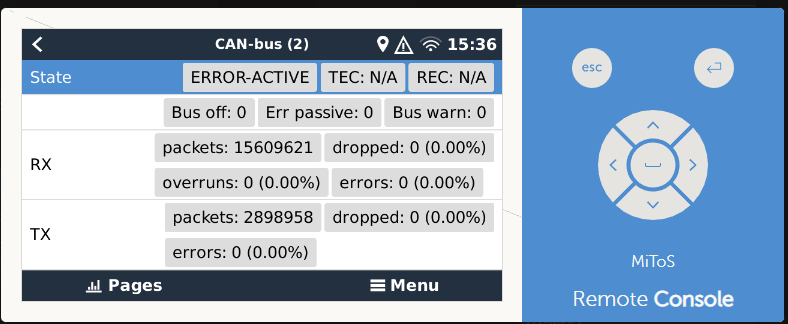

  1. HW connections as per the picture sent in message 55.
  2. uSD-Card formatted and flashed with belenaetcher with the Venus OS
    “venus-image-raspberrypi2-20220531133203-v2.87.rootfs.wic.gz”
  3. enabled SSH via superuser
  4. installed setuphelper from kwindrem
  5. installed canhat from kwindrem (via SSH)
  6. run canhat setup, selected option 9 (12Mhz) only Can0
  7. enable 500kbit/s BMS
  8. getting CAN-Errors on the controller and nothing on the Venus
Bus setup
venus Error-Passive
diybms
ssh report of can0

you should really be getting something like this:
long shot worth downloading and testing (or loading from existing setup!) latest LARGE beta 2.90~10 if anything else fails.

hmmmm. i got now one board working. BUT I HAVE NOT CHANGE ANYTHING.
this makes me crazy…
what i did:
  1. situation as before
  2. unplugged (first power, then can) the controller (lets say n°2)
  3. plugged the can hat to the controller n°1
  4. plugged in the usb and changed wlan with the putty
  5. switched on the can bus in the diybms
    interestingly the Venus shows now “ERROR-ACTIVE”
result!
you do have to reboot the lot everytime you change something (imho)
try different on off procedures to make sure it’s going to work after an unexpected reboot/restart.
Well, either Stuarts Video has a failure or the boards lettering.
I have finally got one board to work in the way, stuart connected it in the video.
Pin 8 to Hi and Pin 7 to Low which is in fact Hi to Low and Low to Hi… as per the Canbus manual from Victron.
