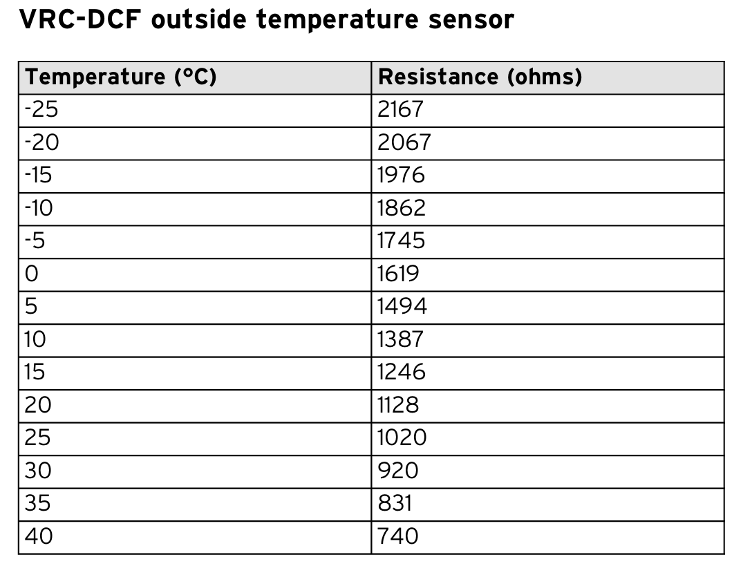

Does anyone have a look up table for a Vaillant VRC 693?
I do not have a suitable location for an outside air temperature sensor and I would like to use an Ohmigo Wifi device. This requires a resistance look up table.
Many thanks
I think I may have found it.
