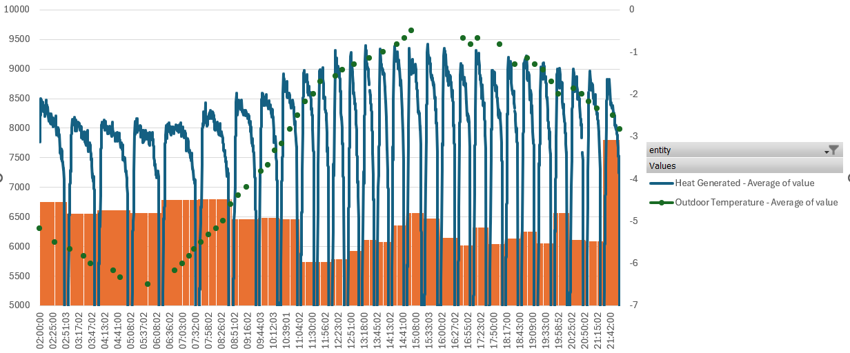

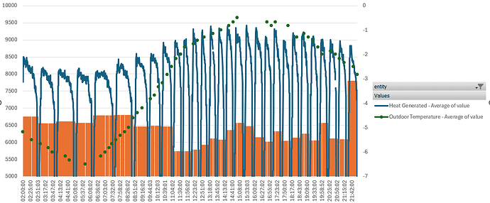

I am glad I found this thread. I think I have some interesting additional information on maximum power output of Vaillant Arotherm Plus 7kW in real-world (and challenging) conditions. @glyn.hudson I think I have exactly the case where the installer, in good faith was interpreting the figures in the Vaillant specifications, but not considering that this does not take into account defrost cycles. I have heard that other manufacturers do publish “integrated” power outputs which take into account typical defrost cycles and this seems like it would be very useful.
In my case, the system was designed knowing that it would be somewhat close to the limit, but should not be undersized - we know that we have some opportunities to improve insulation which we plan to do and we do have some backup heating, in the extreme cases.
We had temperatures of -6 overnight recently followed by a foggy day where temperatures only increased to -0.5 max. For the period in the graph below, the pump was running at full capacity for the whole period (120 rps compressor speed whenever not in defrost and no hot water heating). What I am showing is temperature and instantaneous heat power (I cropped the power axis to see details better). I am also showing with the orange area, the average power between the end of one defrost cycle and the end of the next which seemed like a reasonable fair way of representing it, given the changing conditions (ignore the last period as not all of the defrost cycle is included). I have not shown all the data, but for context, the maximum flow temperatures were peaking at about 40-42 and return temperatures 33-35. The flow rate was stable at 912 L/h
At -2 in foggy conditions the output was only averaging about 5.5kW. Overall, it could be roughly summarsed as ~6.5kW during the colder/lower humidity half of the day and ~6kW during the warmer/higher humidity half when defrost cycles were more frequent.

Couple of comments/questions:
  • That flow rate is a bit low for 7kW. should be closer to 1200L/hr when compressor is running. I don’t know if this is constraining output in any way, but it is worth highlighting.
  • Water of glycol? I would assume Vaillant performance data is based on use of water.
  • Out of interest, do you know what max compressor speed is used fo defrost? I’ve only seen mine go up to 80rps, but I don’t know if that is by design… or it is just fully defrosted by the time is ramps up to 80rps.
Thanks for the thoughts.
  • I will look into the flow rate when I get the chance - not sure what the water pump power is set to, but my guess is that it is set to “auto”. EDIT: confirmed it is set to “auto”. I see about 915 l/h for heating and 1050 l/h for DHW.
  • It does not have glycol in the system.
  • When in defrost, it seems to start at 40rps, then go to 80rps, then drop to 60rps
Auto targets 1200 l/h. Pump power will be 100%, trying to achieve this. When was last time strainer was cleaner, this can often restore flow rate.
Same here, thanks for sharing your observsations.
Blockquote
The system has only been in 8 months. The pipework is not ideal, so probably can’t achieve the 1200 l/h (though looking at the specs it says minimum of 550, max of 1200, so hopefully this is not having too much of an impact). I did have one radiator on a TRV and when I opened this it increased to 930 l/h, but the rest of the radiators are fully on.
Give strainer a clean, this might generally insreases flow rate a bit. If you don’t achieve the full 1200l/h I don’t think this is a major concern though.
Yes, datasheet says min 550 l/h but its very unlikely you’l get full output at that flow rate. Full output at 1200 l/h is almost dT 8K. So at 550 l/h that would imply a dT of over 16K which I would assume just isn’t going to happen (there must be a dT limit, not sure what it is though).
Definitely take a look at your strainer, ~900l/min is way too low for a 7kW unit.
