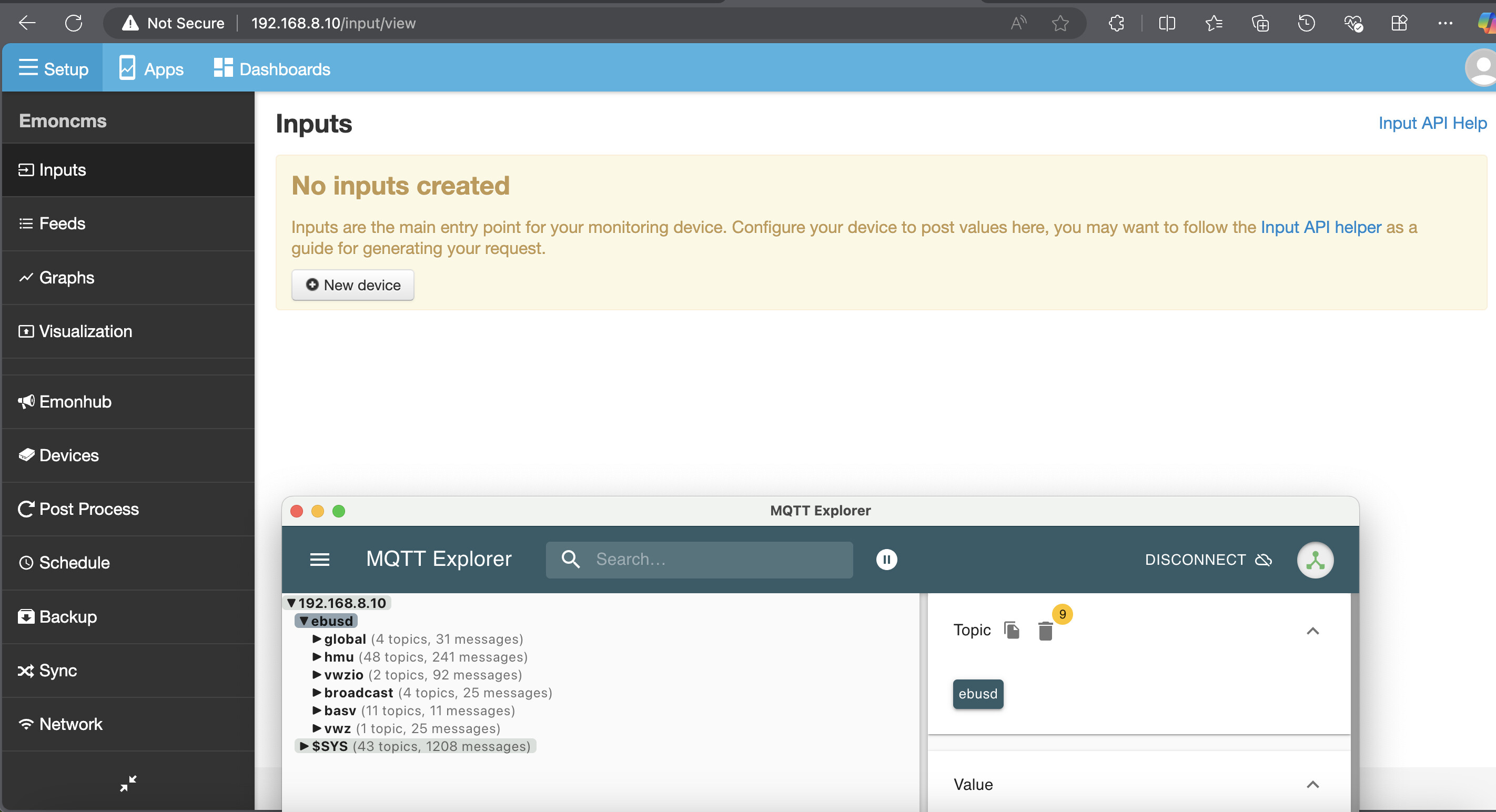

here is mqtt running off pi4 with a web browser pointing at the web interface
How do i populate the feeds or input, as the docs state an auto automatically populate

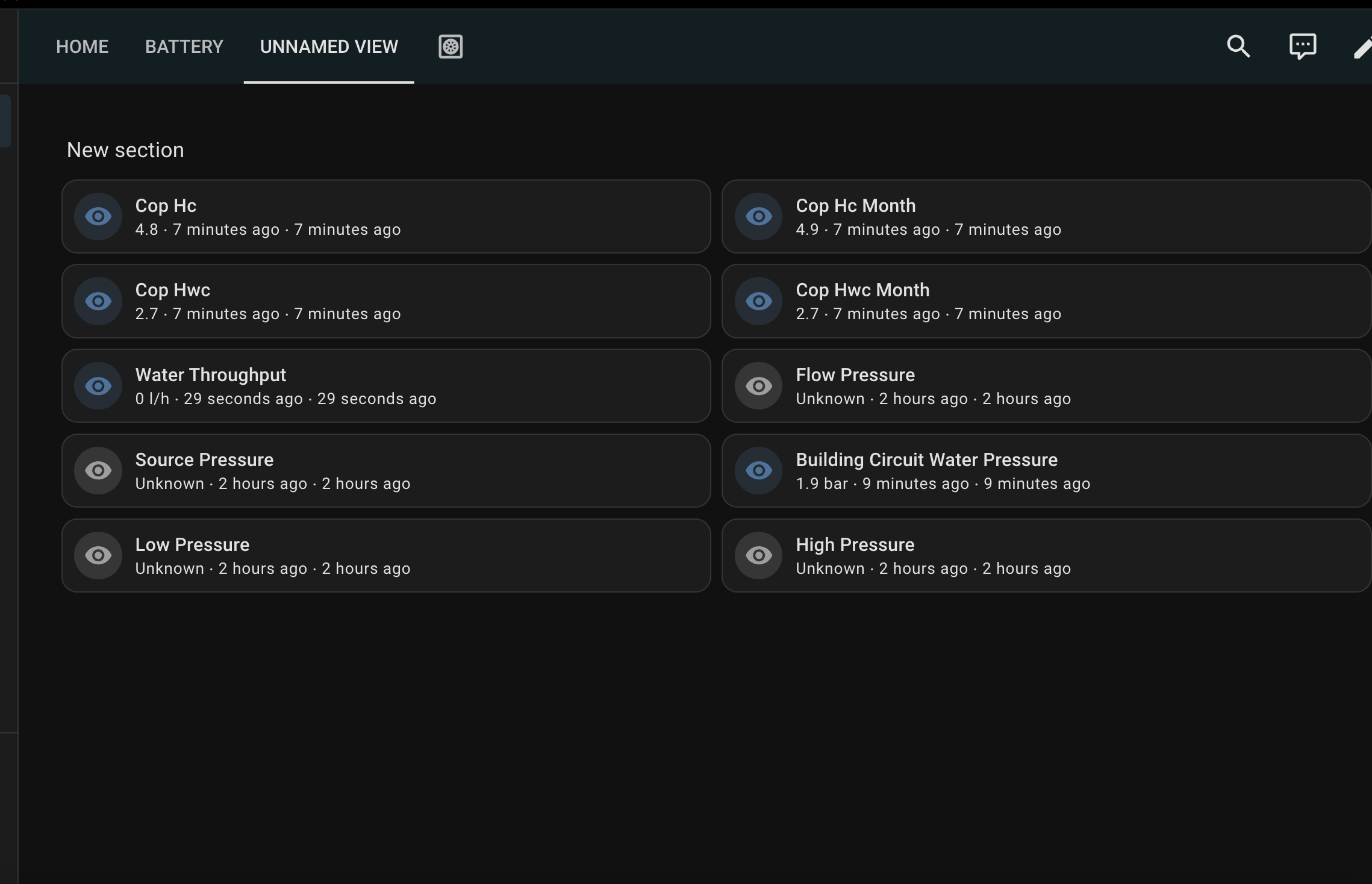

The latest update from jonesPD has fixed most of my problems. I was literally getting no data anymore after a very promising start. Phew
I’ve a simple setup, with a 5kW Arotherm Plus, with the indoor controller and the sensoComfort
yes, it also solved all mine as well.
My only problem is the frequency of entity updates which is not fast enough for my taste, it is not precise enough, even with desired entities set on r1 in the CSVs
Are you manually polling cia MQTT as well? That was the only way that worked for me, regularly posting to e.g. ebusd/hmu/FlowTemp/get to force an update. This way I get 10s update intervals and always fresh data (somewhere it was said that you would get stale data this way, but I’m getting definitely fresh data on each poll)
I’m doing nothing, I let the ebusd integration do his job :confused:

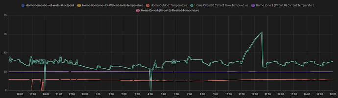

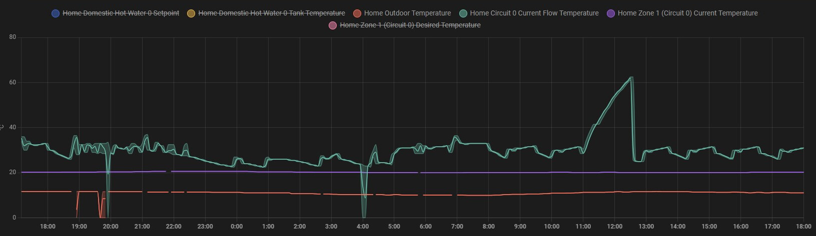

I know this is an old problem that other people have reported and come up with solution for, but I have struggled to understand from all the many posts what the definitive reason/solution is. I have the problem where the ebus adapter and some issue with maybe too much polling(?) is causing the heatpump and controller to get confused and start misbehaving.
In my case I think I can see the secondary reason for it in that the inside and outside temperature feeds get disrupted, so the heatpump responds (see gaps in feeds in plot below measure independently from the ebusd feed, using the myVaillant connect HA add-on). I am using Andre’s mqtt config and the latest Jones csv files. I also poll for about 8 values using mqtt via an automation. I had this set to poll once per minute, but tried every 10 seconds for a short time. Anecdotally, the increased polling period did seem to make it worse, but I am not certain that this is actually the cause and I have seen people posting that polling every 10 seconds is no problem and that there is maybe some other underlying cause of the problem.
I have unplugged the adapter at the moment and plan to strip back the CSVs and remove polling and re-introduce slowly. However, if anyone has a link to the definitive cause of the problem, that would be great :slight_smile:
Which values are you manually polling for? I think the issue for these disruptions was polling of specific values in Home Assistant due to a faulty config, but this got fixed. The issue was potentially also within a config of the ebus install and not even in the csv. Can you do a clean-slate install of ebusd, removing the old configs beforehand (make a backup) and tehn reinstall ebusd, pull the latest jonesPD and start from there?

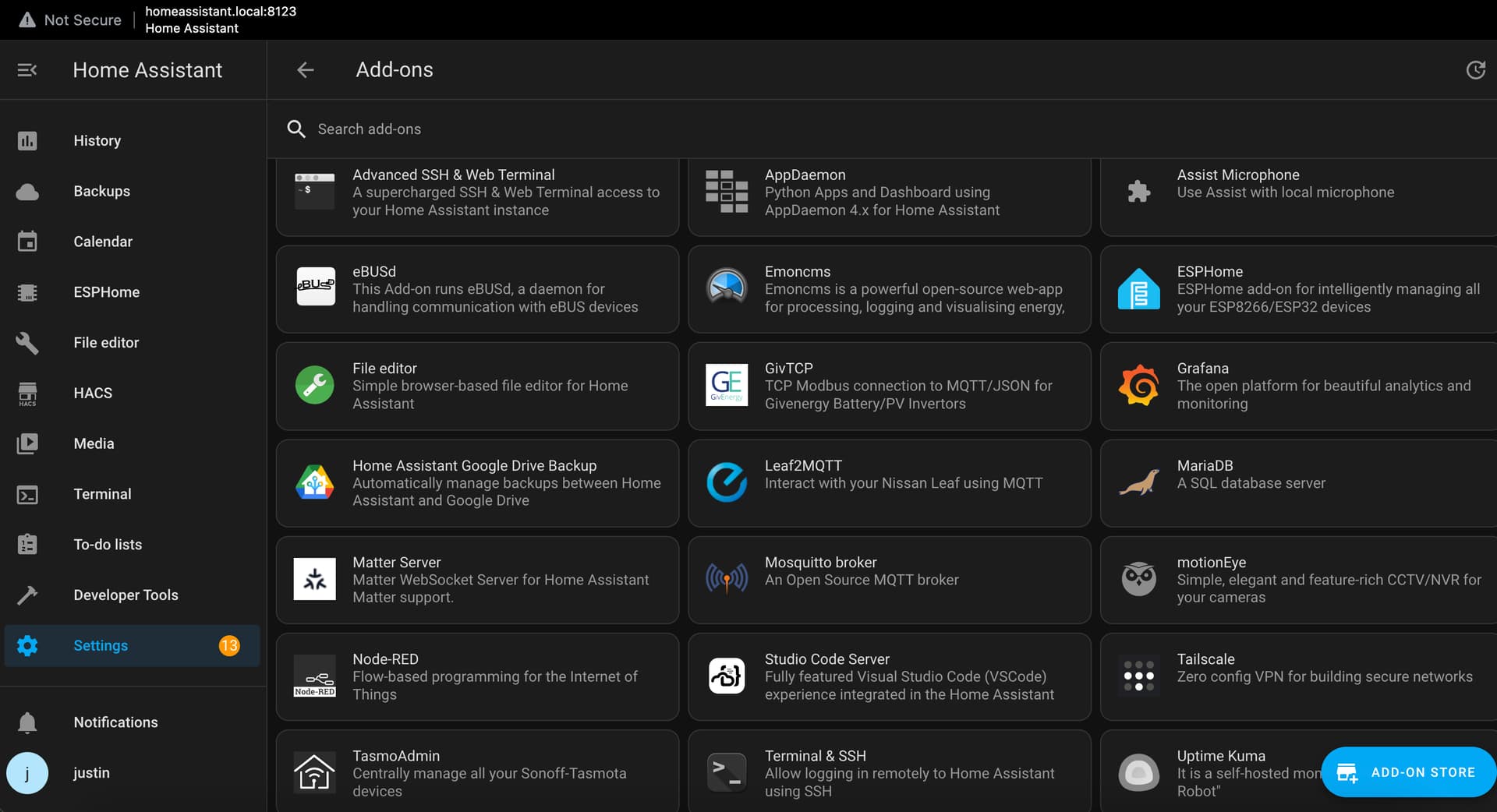

So you have a server running Home Assistant and have ebusd, Emoncms and MQTT as addons?
Thanks for the advice, I will try what you suggest. I am polling for the following:
topic: ebusd/hmu/WaterThroughput/get
topic: ebusd/hmu/ReturnTemp/get
topic: ebusd/hmu/FlowTemp/get
topic: ebusd/vwzio/ThreeWayValve/get
topic: ebusd/hmu/BuildingCircuitWaterPressure/get
topic: ebusd/basv/HwcStorageTemp/get
topic: ebusd/hmu/RunDataStatuscode/get
topic: ebusd/hmu/CompressorSpeed/get
I’m polling all those as well (except CompressorSpeed I think), so that should not be the issue.
it’s running on proxmox with the official HA install

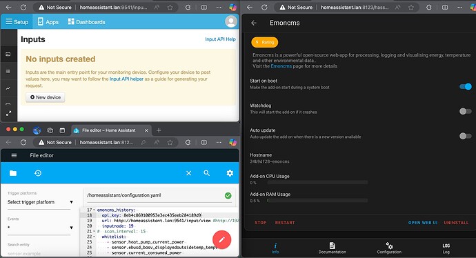

ebud, and mqtt are working, Emoncms starts,
population of the feeds is my issue.

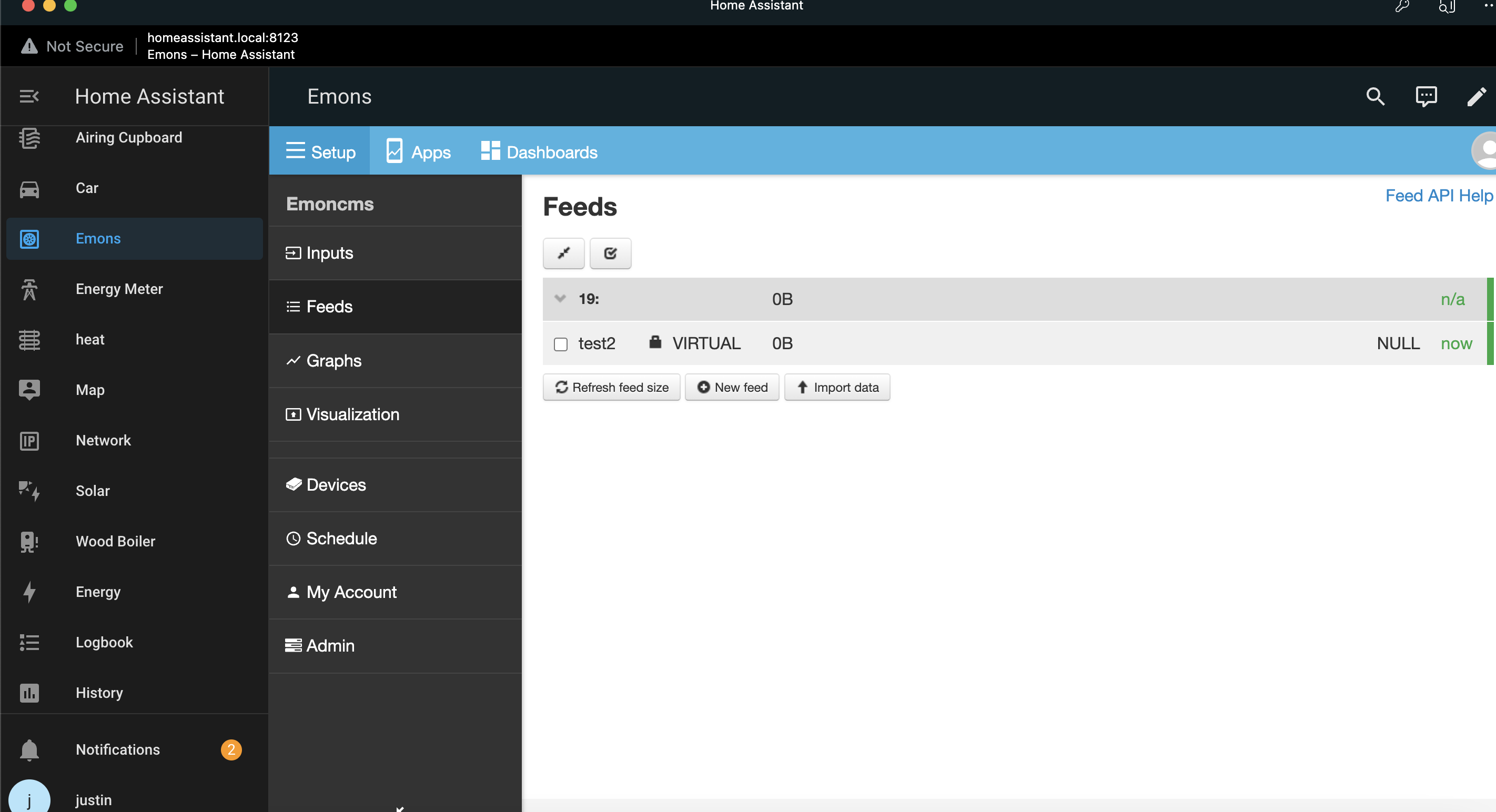

when i click 'open web ui ’ a link http://homeassistant.local:9541/feed/list
The documentation says you should use an url of the form http://x.x.x.x/emoncms - for self-hosted systems - so did you try with the IP address and /emoncms at the end, e.g. http://192.168.1.123:9541/emoncms
Right now you have /input/view.
I used the integration a while bck and it worked, but I never had to specify a custom port. That could also be an issue.
I tried that one and many others, such as:
However, none of them populated emoncms. I have also installed it on a Pi4 with the emoncms image, but it did not populate.
What tab does the populate
Input Tab
Feed Tab
