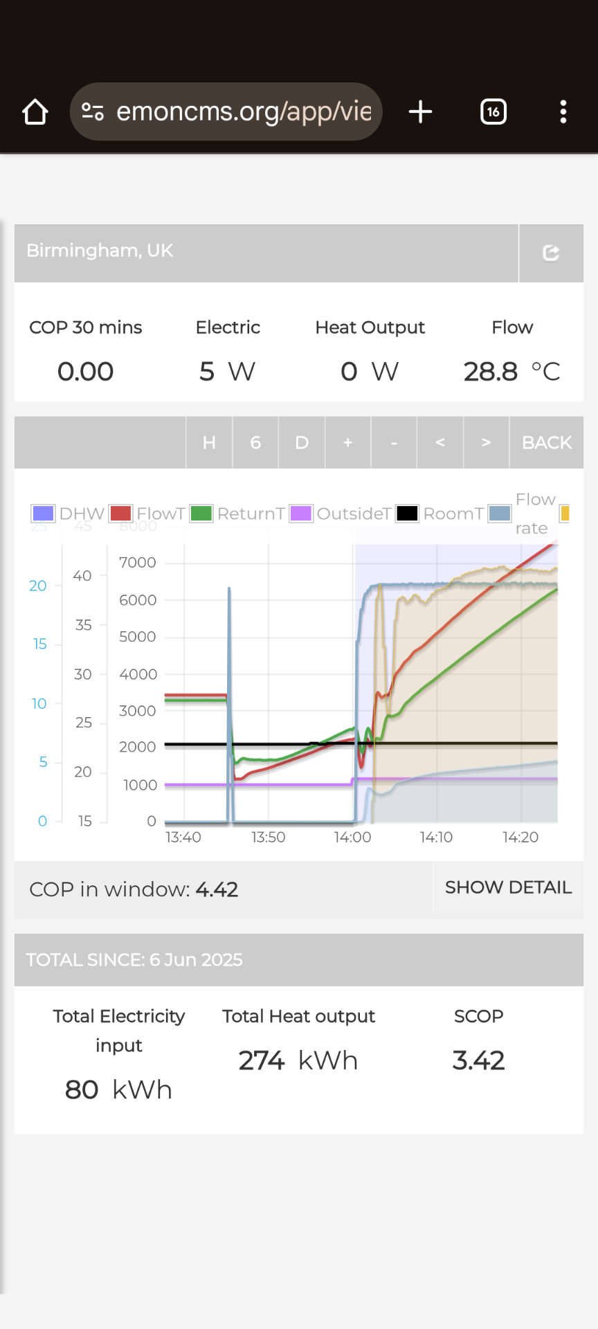

First time posting on here and just wanting to get some general thoughts on an issue I have, from people that will hopefully understand what is going on with my Vaillant system better than I do!
My setup is an Arotherm+ 5kW heat pump unit, running at 45 degree flow temp for -3 outside temp. Using a heat curve of 0.7 and Active room temperature modulation. System installed in June 2024, predicted overall minimum operating SCOP of 3.6.
150 litre Unistor unvented DHW tank being heated twice a day on Balanced mode.
No Open Energy Monitor system in place at this point.
Tracking the system using data from the Vaillant app, the system has supposedly achieved an overall SCOP of just 2.88 since install, with maximum daily heating COPs coming out at no more than 4 and DHW maxing out at around 3 during milder outdoor temperatures. Any cycling that happens on the unit appears normal, seemingly no functional issue in that regard.
This low SCOP has been in discussion with my installer and Vaillant for a few months now, such that my installer came and swapped the flow and return temperature sensors on the heat pump last week, as there was suspicion that one of them may have been faulty from install and causing the SCOP value to be underestimated. Almost instantly I have seen COP values in excess of 6 for heating and around 5 for DHW over the past few days.
I guess my question is, is it plausible that a potentially faulty sensor being switched now be over-reporting efficiency values and making the system appear more efficient than it actually is?
Any other thoughts, etc on this will be gratefully received!
Thanks, Pete
Most definitely. Those sensors are pretty shitty and can be off by a degree or more in either direction. You need to get a reading when your system is pumping water but the compressor bring off. Check my post history to see the journey I took to fix these sensors.
Thanks André, just been having a quick read through your experiences and I wish I’d found this forum before now!
So, if I am understanding correctly what I’ve been reading, when the compressor is off but the pump is running, I should ideally see identical flow and return temperatures? In that situation, if the flow temp remains higher than the return temp, then the COP will get reported as higher than actual, and if the return temp is higher than the flow temp, then the COP will be reported as lower than actual?
Have I understood that correctly? If so then I guess now is the ideal time of year to be looking at this, because obviously I’m getting long runs of no heating through the day at the moment. Should be easy to compare this week with last week, either side of the sensors being swapped around.
Just as a follow up, my installer has looked at my graphs and confirmed that prior to the swap the return temp was 0.5 degrees higher than flow, and now it’s the flow that is 0.5 degrees higher than the return. And I’ve gone from having an underestimated COP to an overestimated COP, which I think conforms the problem of one of the sensors being faulty?
You’re entirely correct in your assessment. I don’t think it qualifies as a “defect”, just poor tolerances. If you can get it fixed again that would still be great.
