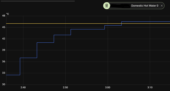

Setpoint: 46.0 °C
Target flow temperature: 0 °C
Cylinder charging hysteresis: 5.0 K
Cylinder charging offset: 2 K

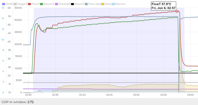

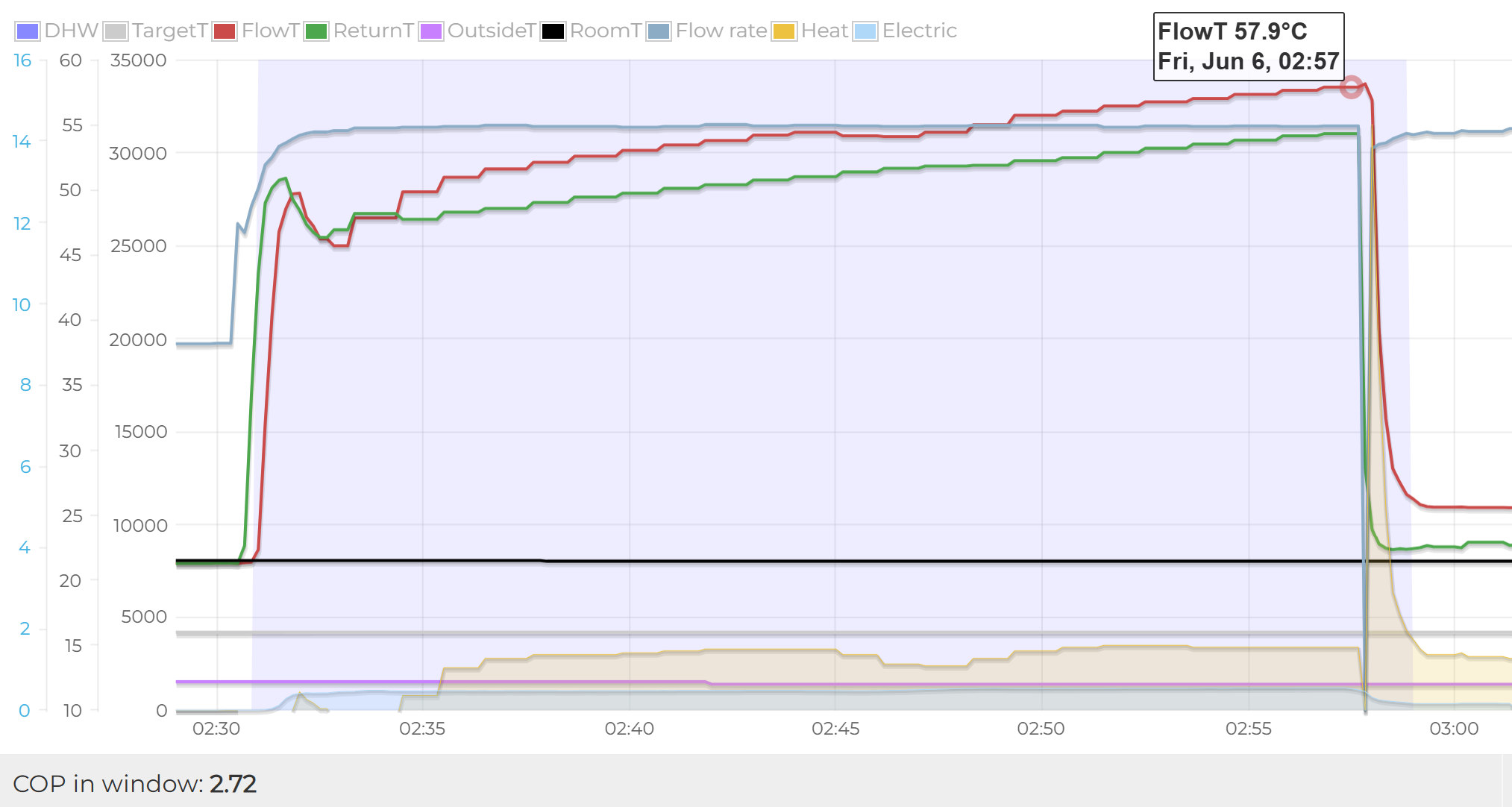

Should the flow temp be rising so high when doing the DHW cycle?
My installer commented on it when doing an annual service. Had not bothered me personally, with respect of cost/performance, but they felt the hysteresis setting might not be working as designed. It was on 10K, they reset so we could compare the result.
The hysteresis setting and the flow temperature arent linked sofaik.
The hysteresis determines the temperature to which the DHW must fall before it reheats. DHW reheat is initiated when (DHW is programmed to ON) AND (actual DHW temp < set temperature-hysteresis)
The flow temperature is determined by the DHW target temperature and the Vaillant control system, which evidently adjusts the flow to achieve the set temperature. The exact algotithm isnt disclosed but from the plots (I get something similar) it looks as though its based on measuring the DHW temperature and the return temperature. The uplift ultimately required from set temperature to flow temperature will be determined principally by the coil area in the tank, larger coil area = smaller uplift. The DHW ECO setting might also affect this figure, obviously its possible to reheat more slowly/more quickly by adjusting the offset and the ECO setting may well change this.
I believe that the ‘offset’ is yet another parameter basically to correct for any error in the temperature sensor measurement of the DHW temperature.
The offset is simply ignored - it doesn’t matter what you set it to.
Thanks @jamespa @Andre_K
We have a 170L Newark cylinder with 4m² coil.
Your temperature trace looks completely normal. Mine goes to 61°C even at the end for a 47°C target.
