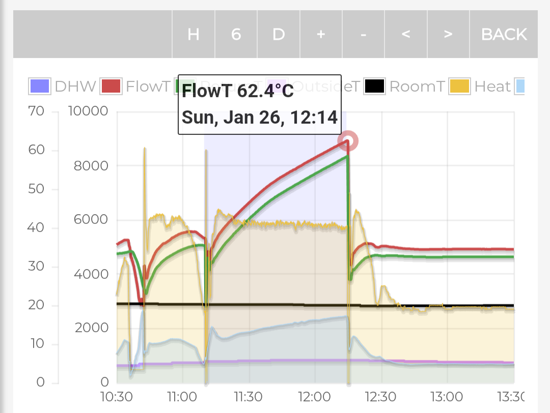

Curious thing…my heat pump seems to be ignoring the cylinder tank temp.
My hot water is set to
Eco
48 degrees
4K cylinder charging offset (e.g. max target flow temp ~52 degrees)
Typically it will do the DHW cycle in about an hour, getting up to ~54 degree flow (eg just above set point).
However, for its past 2 DHW cycles (last night and this afternoon) the heat pump has run up to a flow temp of ~65 degrees. Sensocomfort is showing tank target temp of 48 degrees and actual temp as 59 degrees (eg it’s not that the Sensocomfort “thinks” it hadn’t reached 48 degrees, it has way overshot it).
Legionella cycle is set to off.
I did recently changed the “Max cylinder charging time” from 90 to 120 mins but in my mind this should have no impact on the heat pump’s behaviour in relation to target temperature.
Anyone had similar or has any suggestions?
Thanks as always!!!
This setting is ignored by the heat pump. You’re getting implicit charging offsets in eco and normal mode (eco = smaller offset, normal = larger offset).
As to why you suddenly see this overshoot - very weird, given that Sensocomfort picks up the correct temperature. Have you tried changing the target temperature to another value and back again. A bit of a stupid solution but nothing else comes to my mind now.
Cheers @Andre_K, I’ve just found your other posts relating to the charging offset temp. Interesting that it seems to be a completely redundant setting!
Yes I think I will try your suggestion and/or the old “off and on again”!

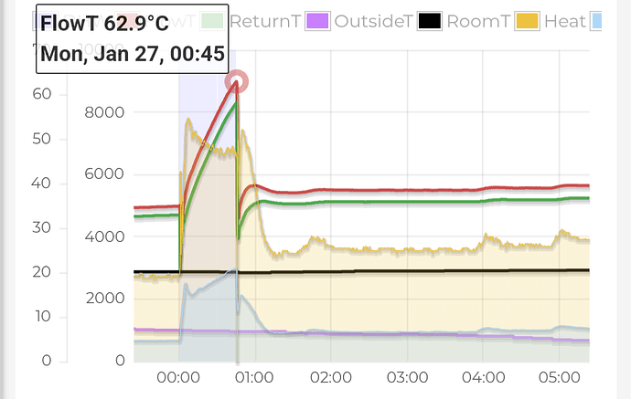

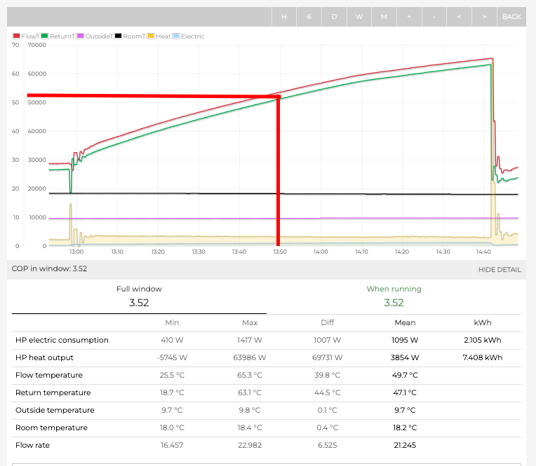

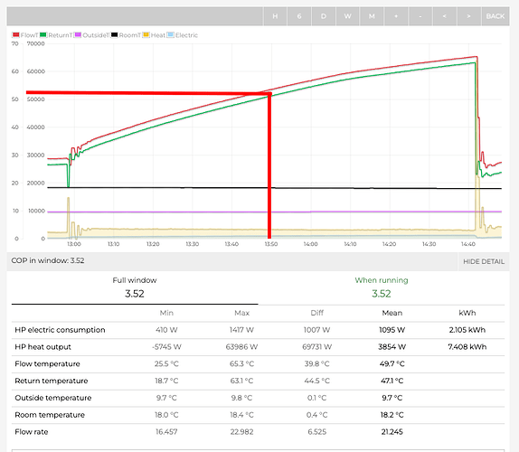

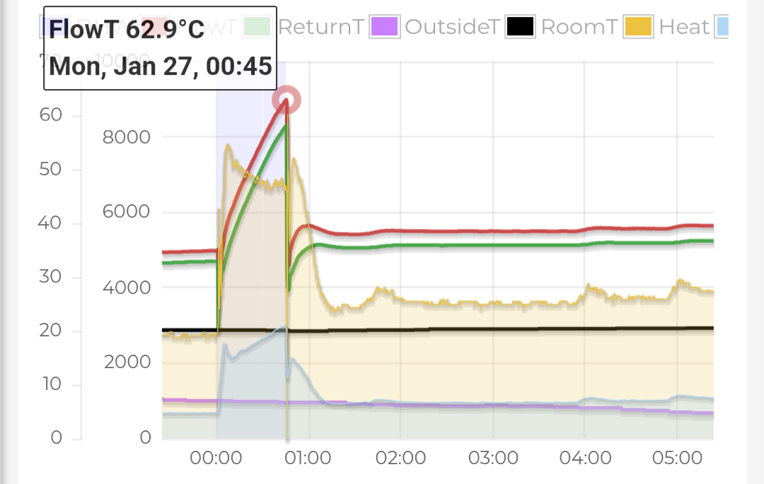

My Arotherm respects the charging offset. Today I ran DHW during the day to test and eBUSd reported a target flow temp of 60c (hot water temp of 55c plus 5K offset). Normal mode with NR mode enabled.
Can you be sure that having NR mode enabled isn’t the cause of the 5K offset being met?
Can you repeat the experiment with a different offset value?
Which ebusd value exactly? My Hc1ActualFlowTempDesired goes to 0 during DHW. HwcFlowTemp indeed goes to Target + Offset, but this values has zero bearing on what the heat pump actually does in terms of flow rate. Does your actual flow temperature obey this during a DHW run?
ebusd_hmu_setmode_hwcflowtempdesired is the value
It reached 62c which is over slightly but it hasn’t gone below or far higher
I think this is pure coincidence. Try setting the offset to 1K, it will look the same.
I’ll set it to 10K just incase it doesn’t heat up in the 2 hour window overnight. Can it reach 65c flow? It will be on our cheap rate so I’m not bothered about COP.
Coincidence it is
