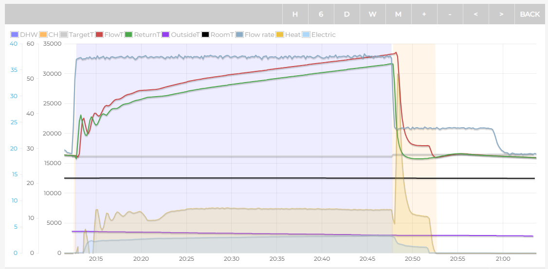

For further reference, this is how it looks for me if there is a heating demand after a hot water cycle:

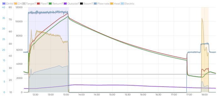

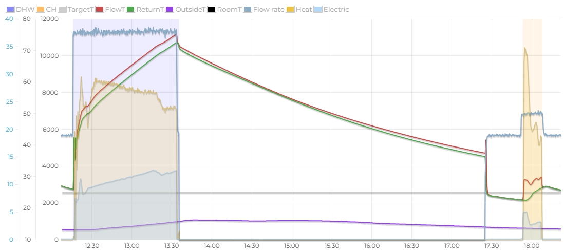

Note the switchover from DHW to CH and how the flow rate drops from maximum (as used by the DHW run) to the normal heating flow rate. If there is no heating request it looks like this:
Note how the flow rate drops to zero after the DHW run (it was >15°C) and the temperature slowly decays. Note this was a legionella protection run hence the super high temperatures.

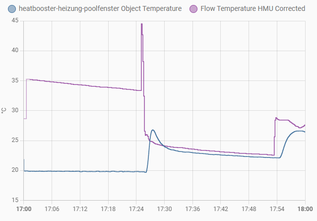

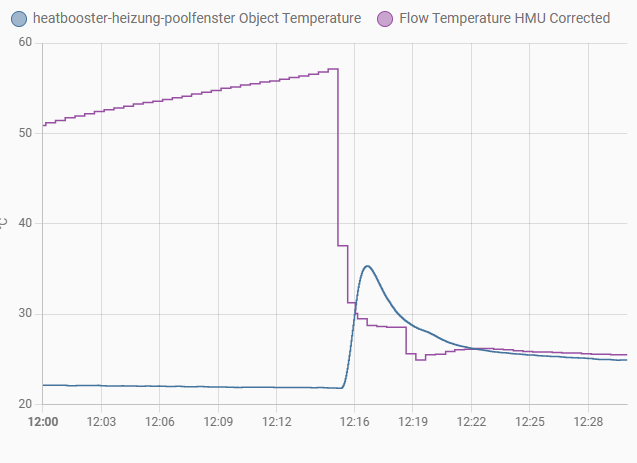

Good catch, there is a minimal bolus effect even after that time. However, it is much reduced. Have a look at this graph, which shows the flow temperature measured at the pump (HMU Corrected) vs. the temperature at the radiator measured via an IR probe (Object temperature) at the time of switch-on from my last graph. Radiator temperature peaks at approx. 27°C even though temperature at the pump peaks at 45°C.
If the switchover occurrs directly after the DHW run, the peak is more pronounced (35°C). Note that this is the radiator temperature measured in the middle of the radiator over a ~10x10 cm patch by the IR probe. Peak temperature at the radiator inled will be higher.
