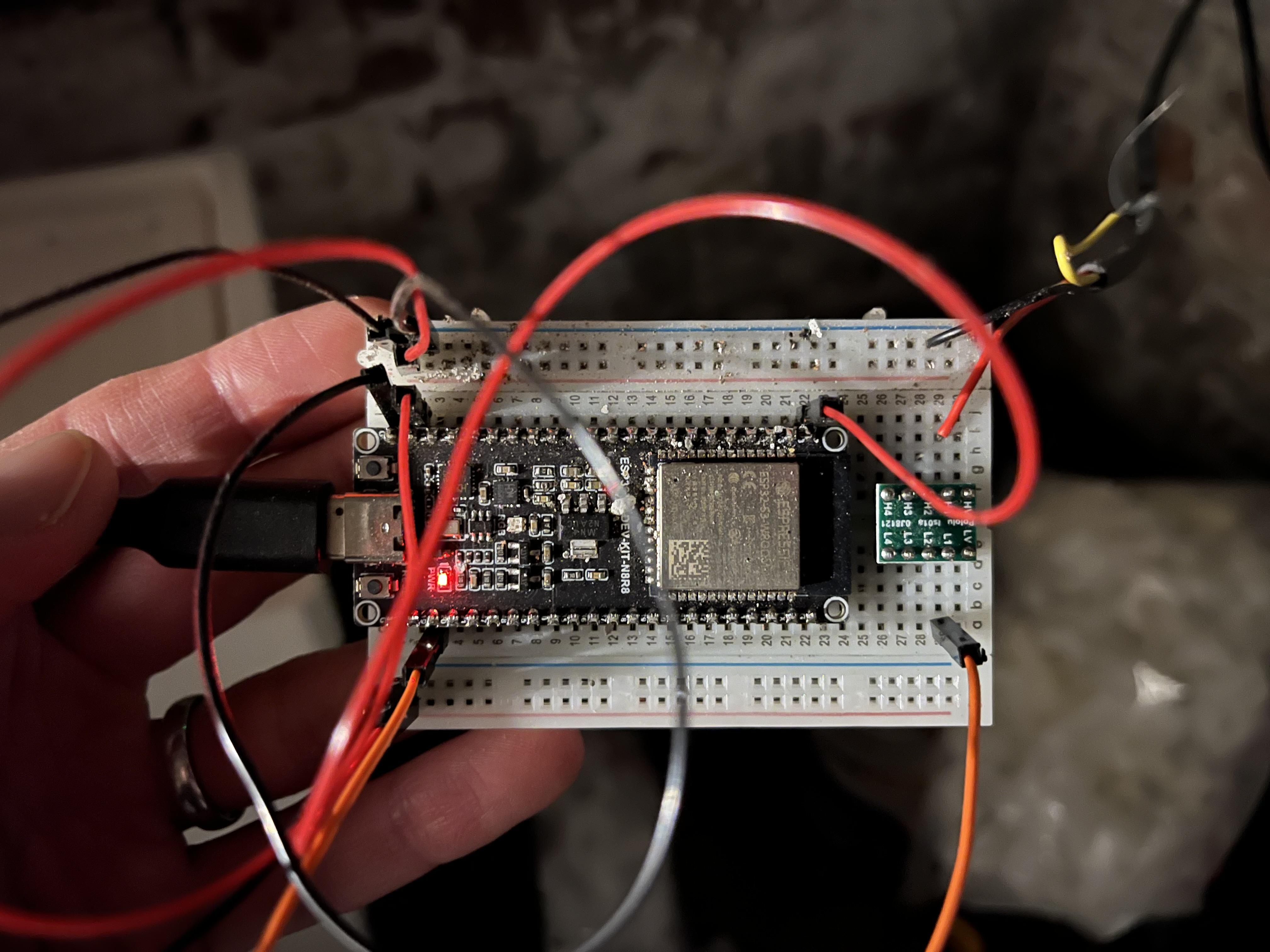

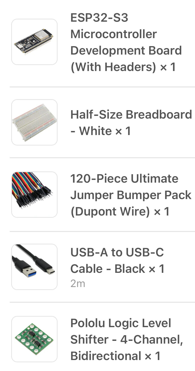

I ordered the following from PiHut:
Wired like this:
I can’t find where I got the instructions to work that out but the PWM input to the pump is wired via the voltage level shifter to the PWM output.
so it is controlled with 5V PWM ?
m5stack has some nice PWM board for the atoms, m5-docs plug and play
Yes my pump needs 5V high for the PWM input. The ESP32 PWM output is 3.3V (IIRC).

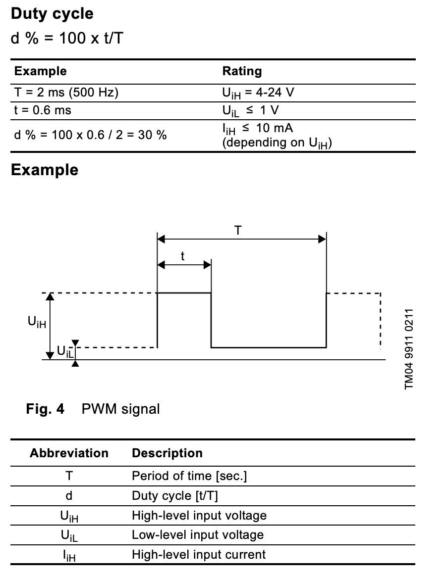

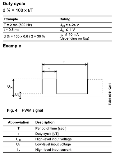

Ours will need a level shifter:
It requires 4-24V for PWM.
