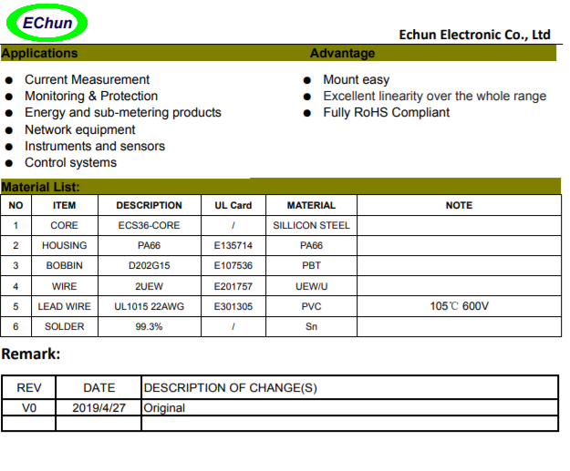

              Sorry I shared a wrong link.
I have attached the right one
Is this compatible for measuring 600A DC ?
              That is not the best choice. It is a voltage output type, the maximum output voltage is 333 mV. That means you are using only one fifth of the input range of the Arduino, so the resolution will be poor.
Note that since it is a voltage output type, the burden resistor is internal, and you must not have a second burden resistor externally.
