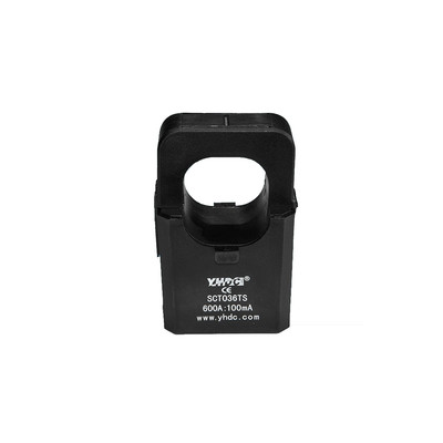

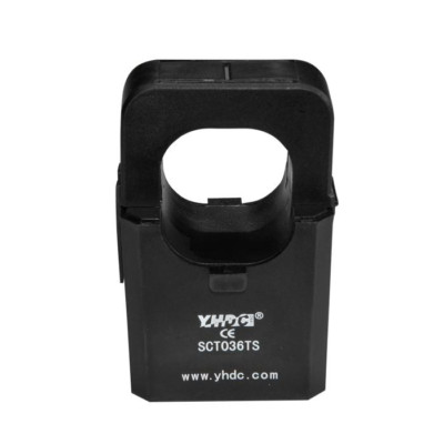

Here’s a couple of links to a 500A:100mA CT:
This source is in China:
This one’s in Poland:
Odd that the Chinese ad is in English and the Polish ad is in Chinese!
Which of course means (assuming the instrument input is 100 mA) a straightforward connection, no messing. But the calibration is still wrong.
