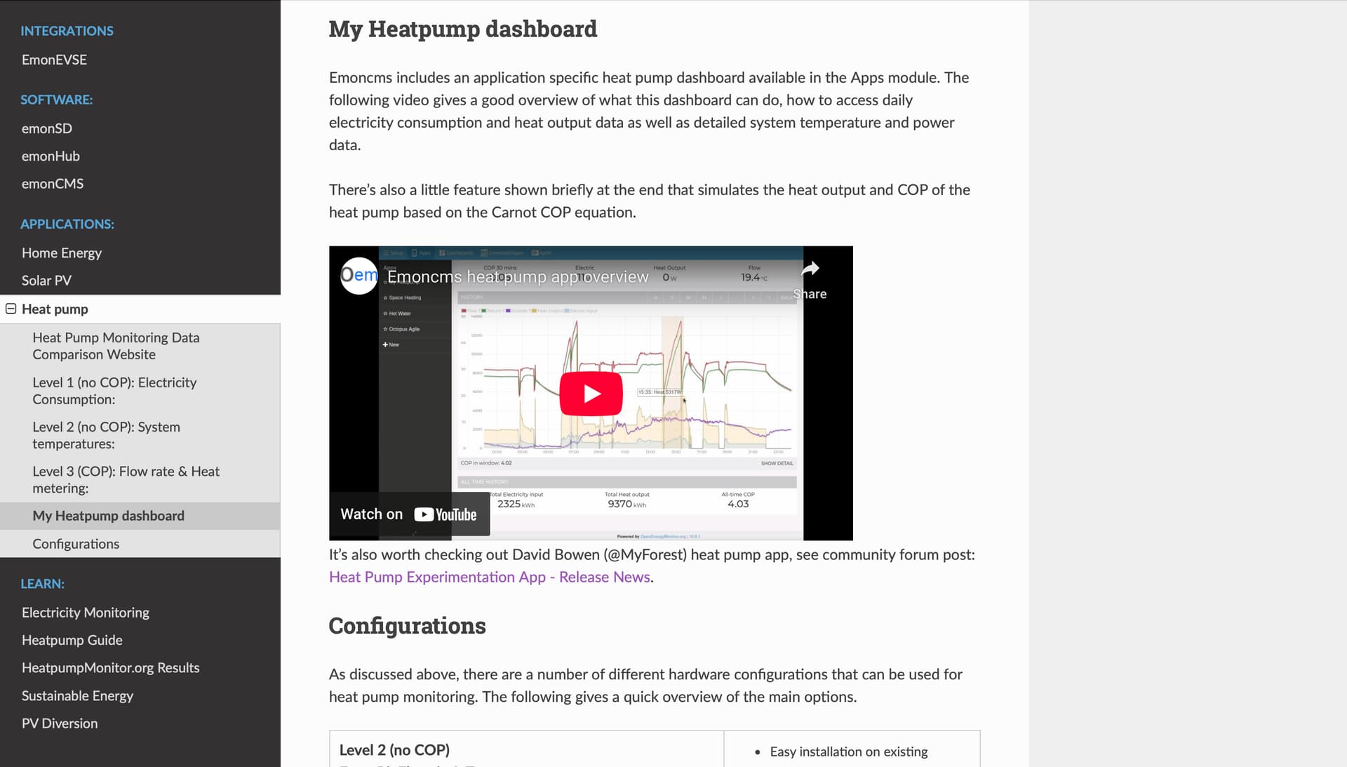

In terms of the documentation, it is indeed all in GitHub so can be updated via Pull Requests. I reckon there are two places where additional notes could be added:
  • There’s currently some fairly brief commentary on the ‘app’ page - i.e. here:
    • This has the advantage of being ‘in your face’ when mapping feeds to the app inputs
    • However, this text is part of the MyHeatpump app ‘code’ (it’s in file myheatpump.php) so doesn’t really lend itself to frequent updates by non-developers
  • There’s also a reference to the ‘My Heatpump dashboard’ in the docs page hierarchy - which even has a nice, friendly “Edit on GitHub” link at the top of the page:
    • On balance I think this is the better place to add the guidance notes, where the data feeds can be discussed in the context of the different monitoring hardware configuration options
    • Maybe we add a link to this part of the Docs from within the ‘app’ configuration page, so people know where to look
