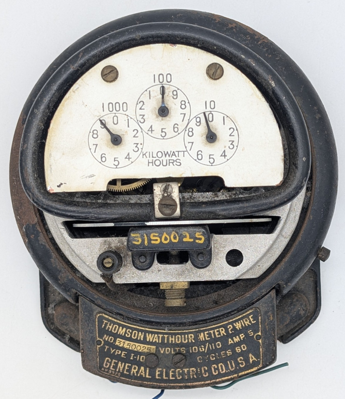

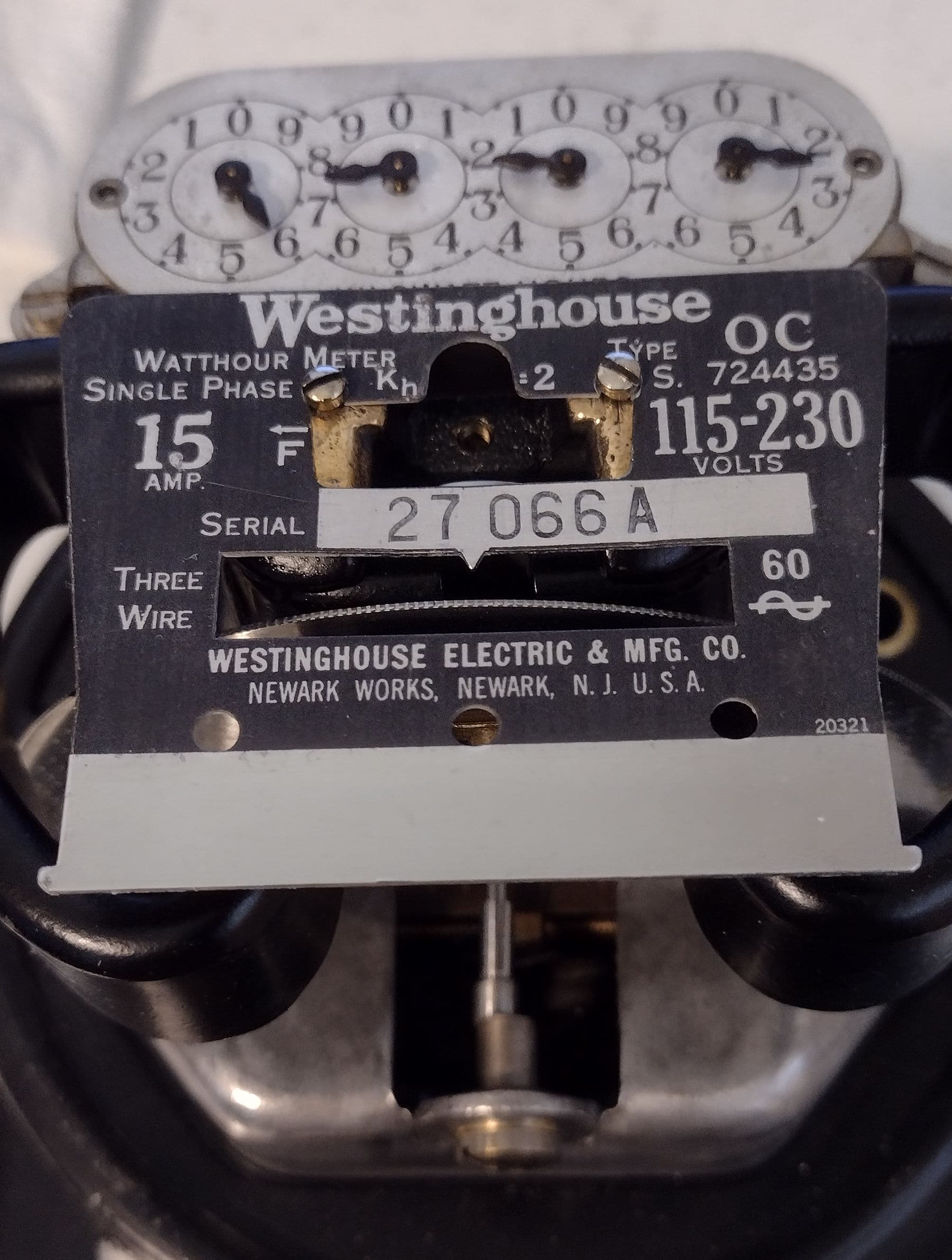

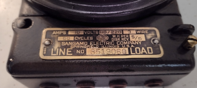

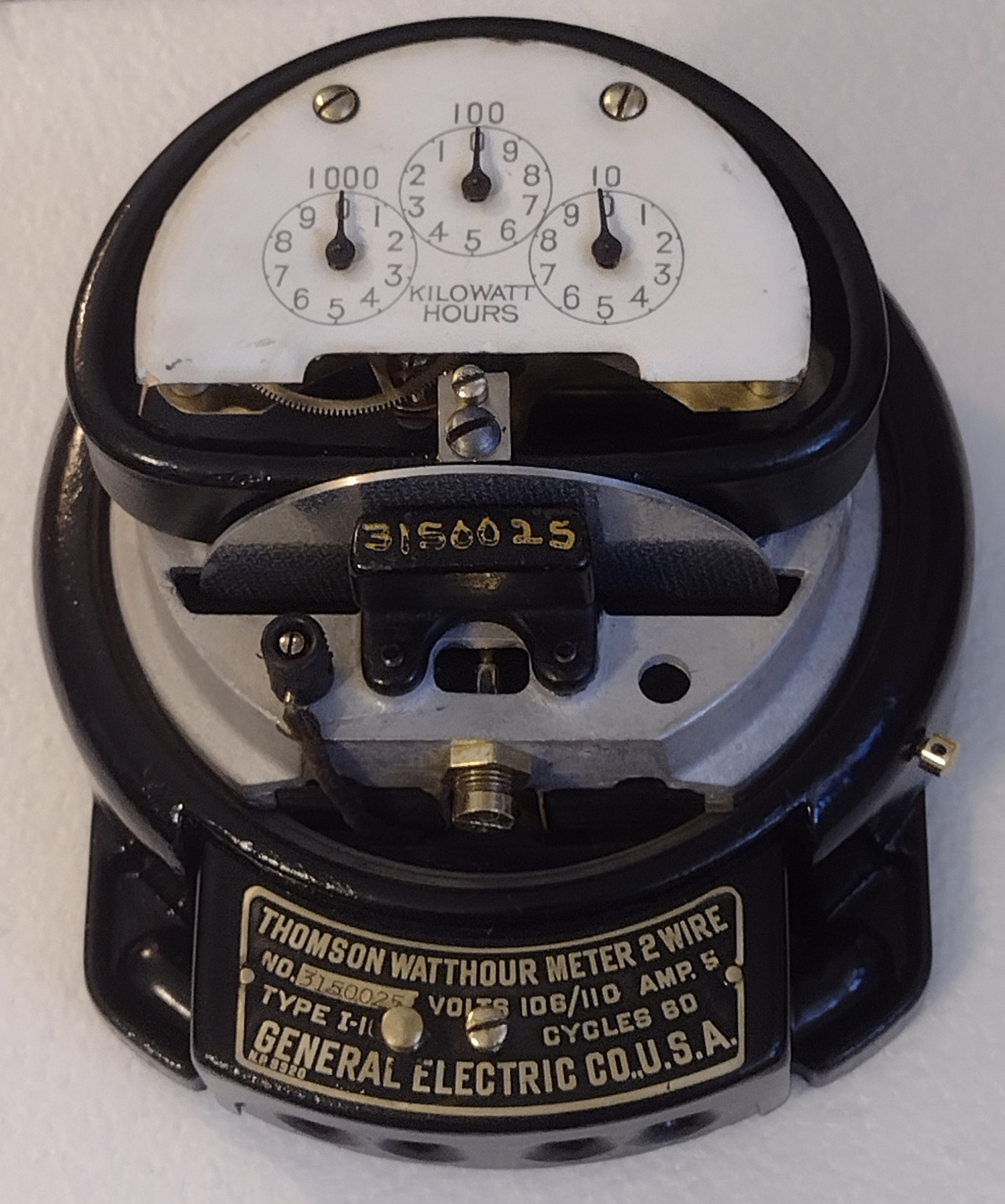

About 100 years ago, the US grid actually was 110/220 Volts. (third picture)
Before that, it was 100 Volts. (first picture)
(note the oddball 106/110 Volt meter in the second picture)
At one time, it was 115/230 Volts. (fourth picture)
In the 1960s, the split phase residential grid voltage was standardized at 120/240.
But, as you’ve seen, it still gets referred to as 110/220.
